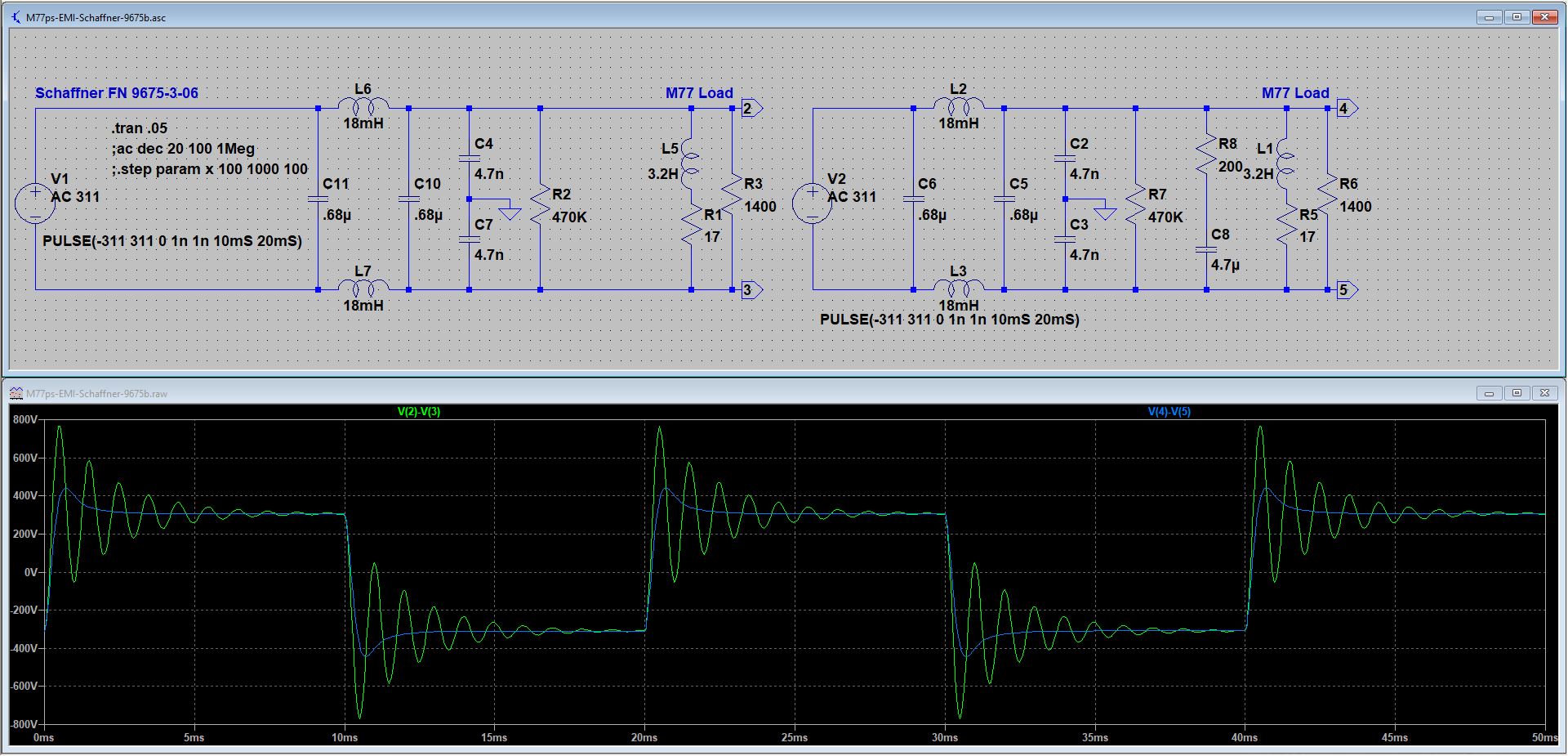

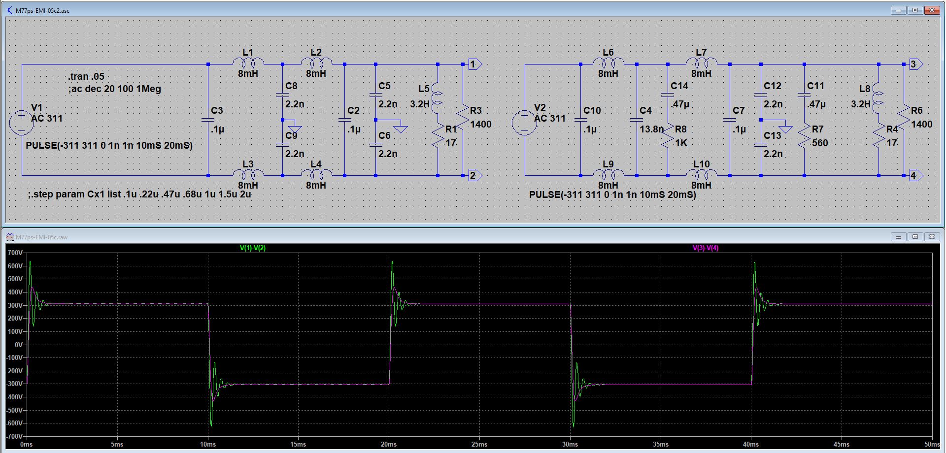

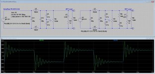

AC filters: I don't know if it's been discussed before, but that's a good topic. I simulated a few dedicated filters recently, and they all ring like hell. Is it audible? I don't know. Is it bad? Surely. Anyway, it's an easy fix with a RC damper at the ouput.
Attached is a Schaffner filter that has some following in the French audio circle; the green curve is stock, the blue has a somewhat optimized damper.
You accounting for the ESR in the caps, inductors, and wiring, and line source and load impedances at the ringing frequency? In other words, do they actually ring in practice if excited with a impulse?
It's a simulation.

If you're talking about the parasitics of the components of the filter itself, I wouldn't loose too much sleep over them: you can double or half the damper values before anything significant shows up (see the .STEP command)

Zung, the RLC circuit that's exhibiting oscillatory ringing is (L6 series L7) parallel C10. (Ignoring C4 series C7 since they are so much smaller than C10).
This explains why the resonant frequency is ~ 1 kHz.
Good old linear systems theory, applied to this second order system, says you'll get critical damping (zeta=1.0) when the load resistance (R8 parallel R6) = 0.5 * SQRT(3.6E-2 / 6.8E-7) ... namely, 115 ohms. Be sure to choose C8 large enough so that its capacitive reactance at the mains frequency, is waaaaaaay lower than R8.

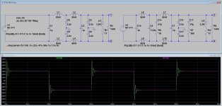

Attached is the filter I think I'll use; it's based on a 4th order kit from eBay. Original on the left and green curve, modified with dampers on the right and purple curve; C4 is 2x6.8n because that's what I have in my junkbox. Your comments are very welcome.
ABORT! Those are CMCs, not inductors. You do not know the actual series inductance, but it is likely 1/100th to 1/300th the common mode inductance. You need to add a K statement to the simulation to show they are coupled inductors.
