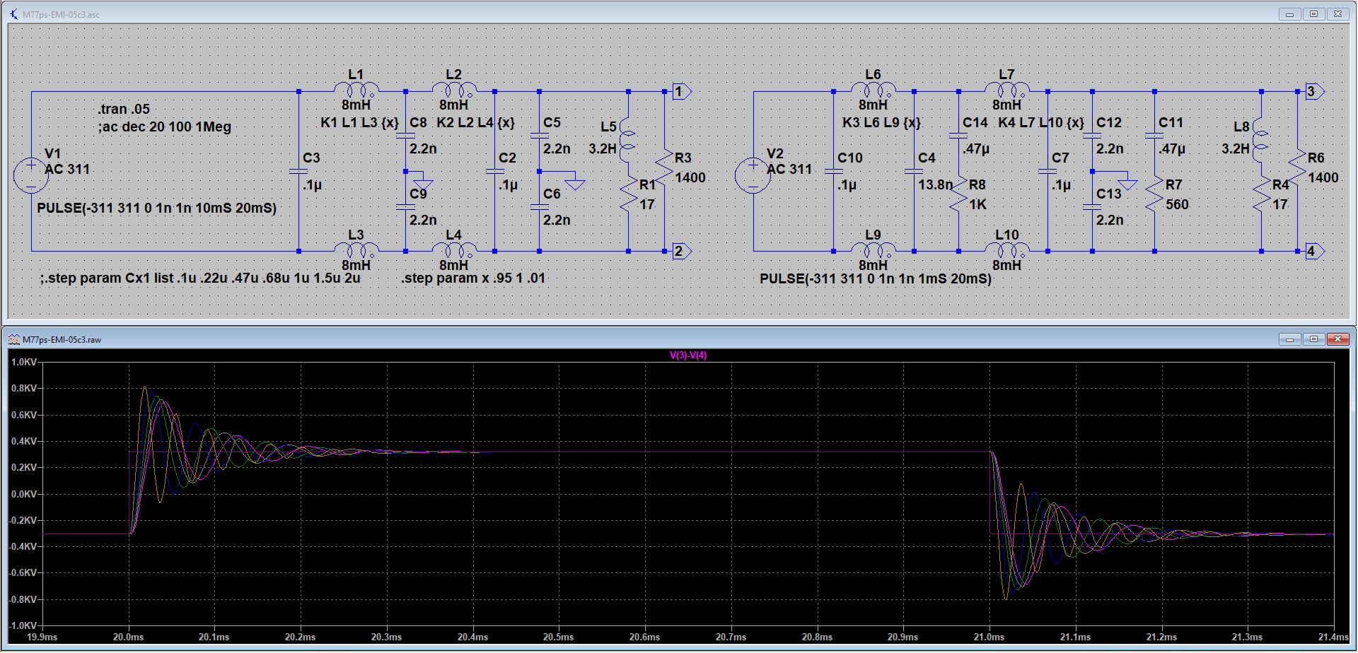

Attached is the filter I think I'll use; it's based on a 4th order kit from eBay. Original on the left and green curve, modified with dampers on the right and purple curve; C4 is 2x6.8n because that's what I have in my junkbox. Your comments are very welcome.
To start to understand what is apening you can simulate the source as a sine wave with 100 milliOhms source impedance AND the load as a rectifier bridge with a short conduction angle and appropriate current. Then introduce short transients (100uS) with maybe a 1 Ohm source and 200V peak. You do need to model the inductors since they may well be saturating.
Still build and test is the best way to verify performance and that properly requires some expensive specialzed stuff.
ABORT! Those are CMCs, not inductors. You do not know the actual series inductance, but it is likely 1/100th to 1/300th the common mode inductance. You need to add a K statement to the simulation to show they are coupled inductors.
Well done!

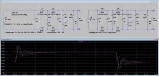

Here's a re-run with various coupling factor K's. At K=1, the inductances cancel out (purple curve), any other values from .95 to .99 ring like hell with the same damping as before. I'll look more into this and report later

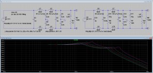

It may well ring at LF - which is what is happening because the ringing is at low single digit kHz. Your rectifier and filter caps will take care of that, but not HF (100's of kHz to MHz) on the mains because that just blasts through onto everything. Example: power line communications.
I would expect that the filter peaks first, but then attenuation after the turnover frequency is very steep, so LF ringing is actually part of the deal. Have you done a frequency sweep?

Then again, I think we all agree AC is evil with all the digital fecies in it. I'm just curious to (briefly) explore whether the commercial filters are even remotely suitable for audio. They are basically low pass filters, but the 3 I've dissected peak and therefore ring like hell.
I still think we can do it right with a Bessel/Butterworth kind of filter, and the right components. Any volunteers for the math? Gentle folks, at least the 1st part is no black magic. 🙂

FWIW the filter is peaking at typical switching supply frequencies. I don't think that is what you want.
The peakings can be smoothed out by adjusting the damping network; I've yet to do it, that's why I capitalized "NOT".

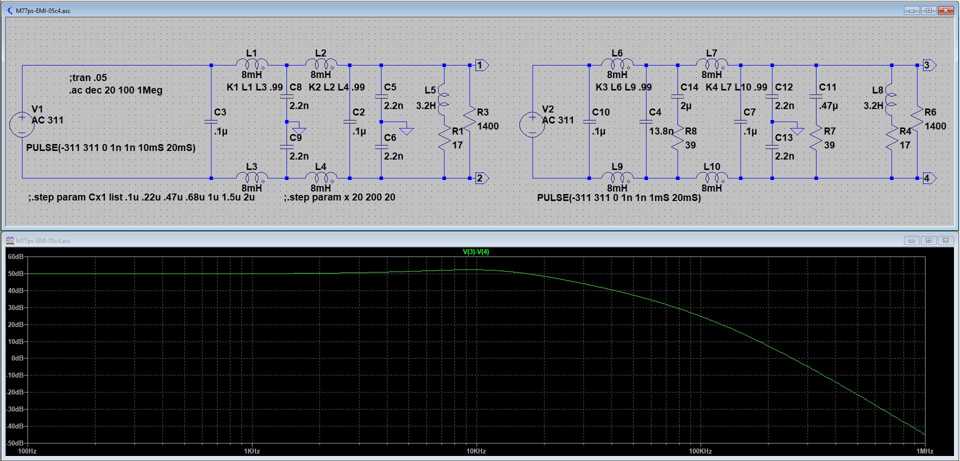

For the sake of completeness, here's a run with somewhat optimized snubbers. All that's left is a small peaking at about 2dB/10KHz
In light all the valuable inputs here, I'm reconsidering fitting an AC filter at all. Especially because of the chokes, with this most burning (for me) question: are ferrite core inductors evil?
