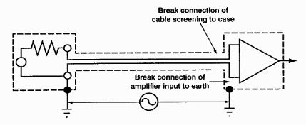

Pavel, understood, I'm using cheapest RCA connectors with cable braid soldered evenly around connector shell. It looks that the RCA-shielded twisted pair with the shield connected on the source side-RCA is the worst case for ground loop current according to your setup

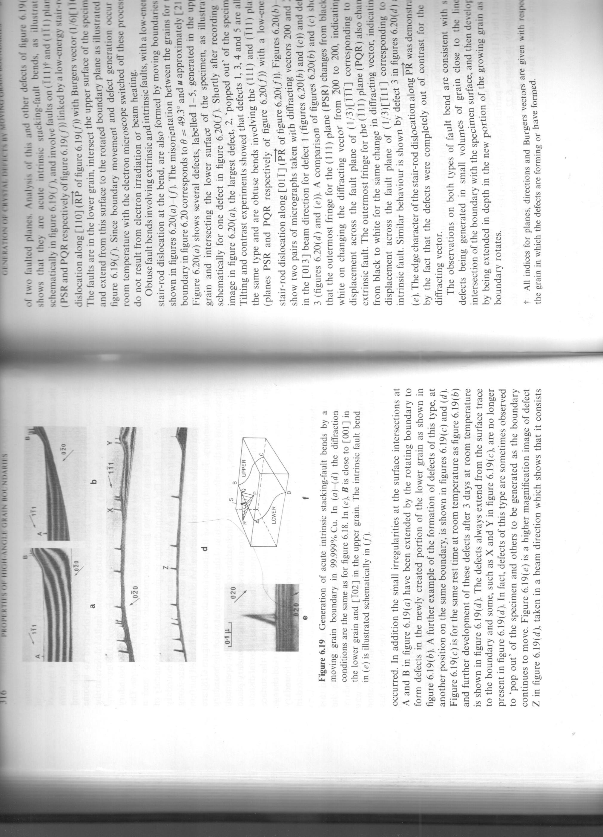

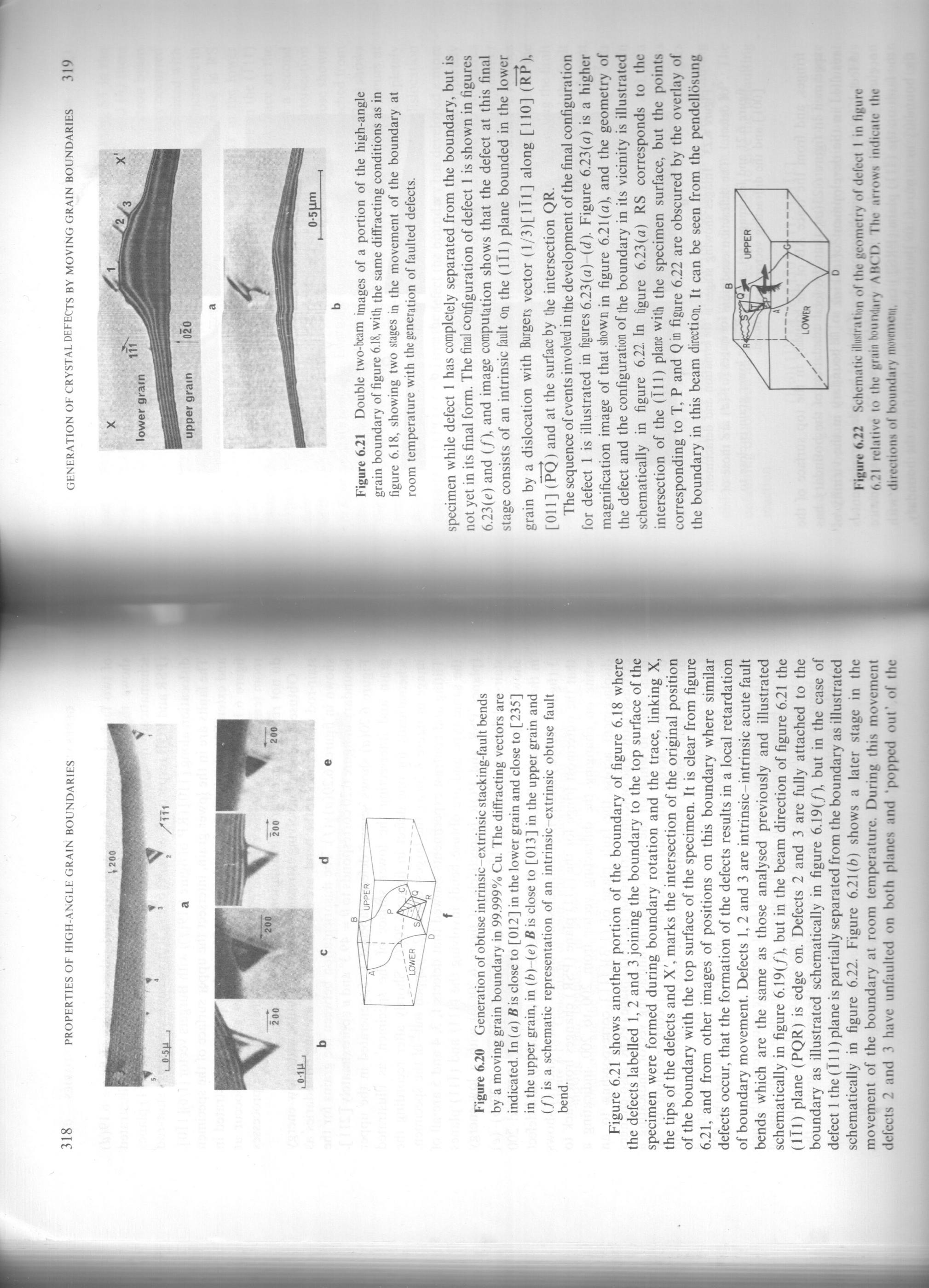

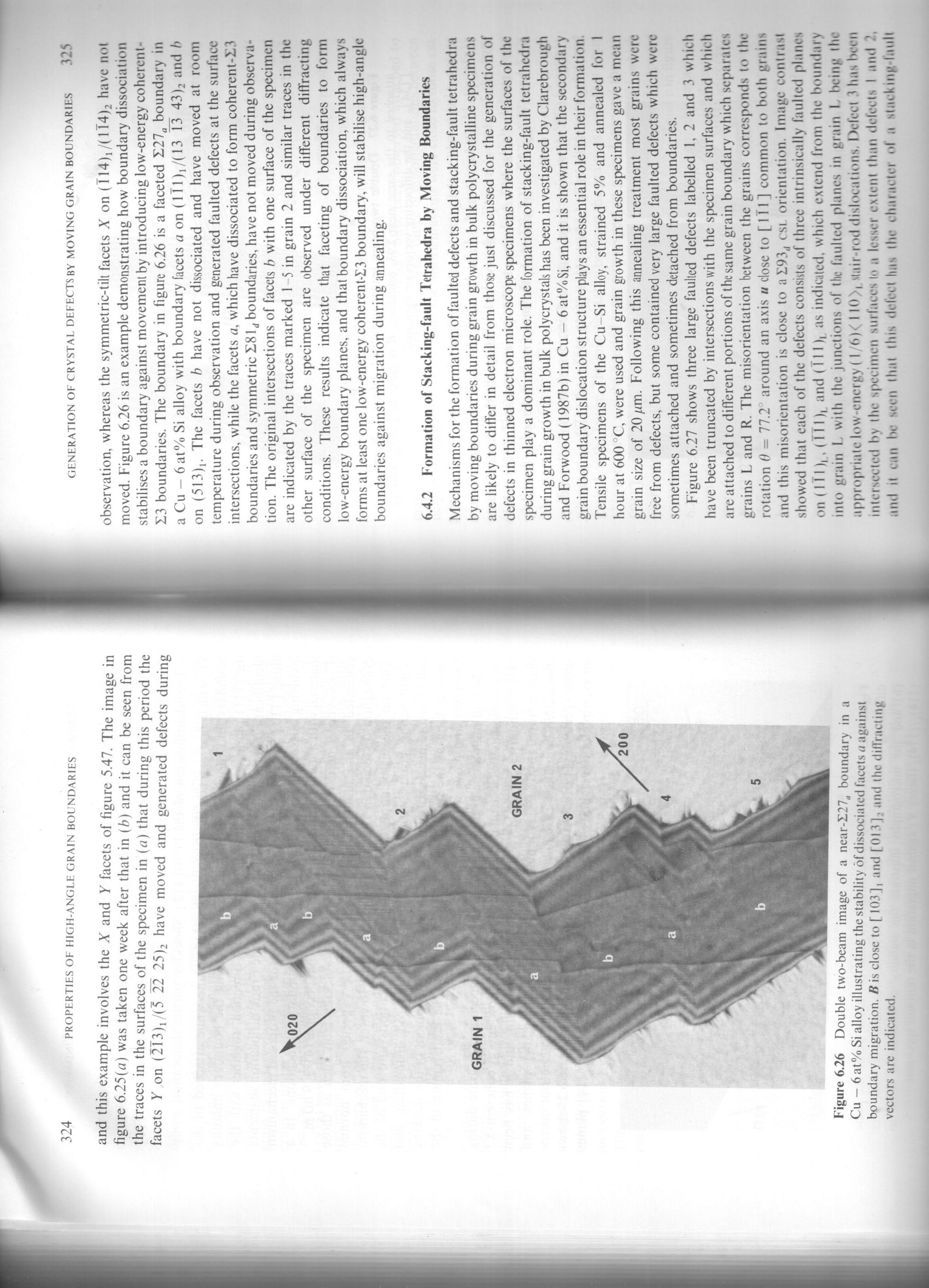

As far as the Forwood book is concerned, I would have posted most of the pages of interest, as I have done several times on this website over the decade(s) if I could find it on my computer, but Gpapag you are going to see a book that is above and beyond what it normally discussed here, and it should be enlightening.
Mr. Curl
You may post the pages you find are of interest when you are ready.
I have read a few metallurgy and material science books so far, so I don’t have great expectations this book will open a window to the world for me.
In a month or two the technical library will have it.

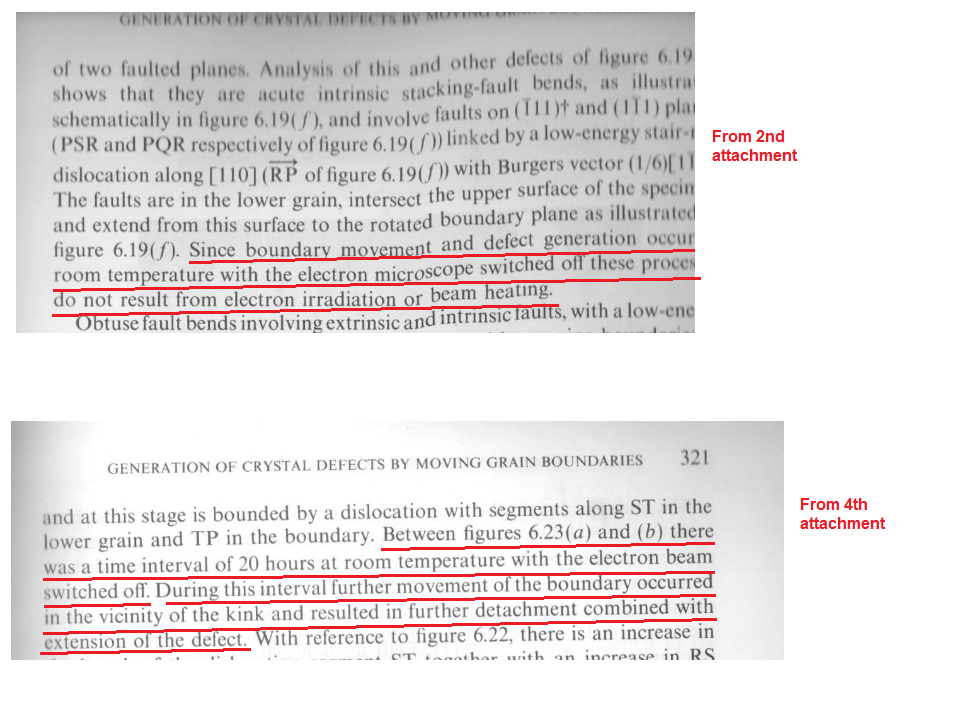

Mr. Curl
The pages you kindly posted do not contain any evidence of burn-in effects in electrical conductors.
On the contrary, in two places –see attachment- it is written that grain boundary movement and defect generation was taking place during a time interval where the electron microscope was switched off , so neither the presence of an electron field , nor the electron irradiation or electron beam heating was the cause of these changes in the thin copper foil (if this is what you call as evidence of burn-in )
A side effect (collateral damage) from the posting of those pages is the verification of the ease by which defects (dislocations) are generated or move around in the copper. They show that changes are inevitable and occur all the time
This is really bad news for a directionality hypothesis based on dislocations and metallurgical defects within copper wires

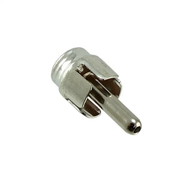

What is the contact force like? Usually when I see these they are barely hanging on. You can smash the leaves down but it never works for long.
These might be easier to use:
1 X 567 Socket; RCA; female; straight; crimped; nickel plated, tinned | eBay
