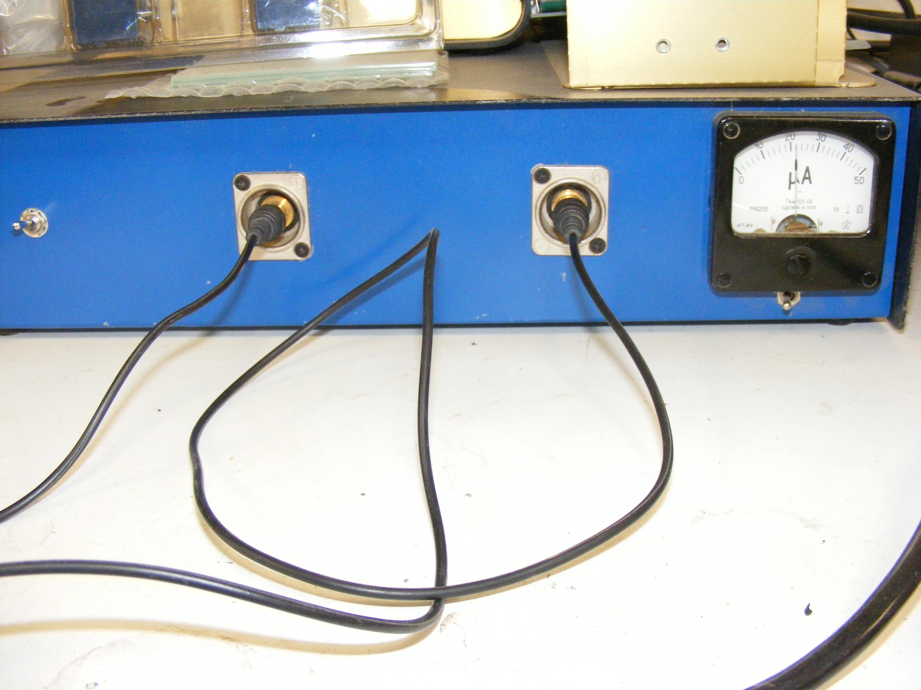

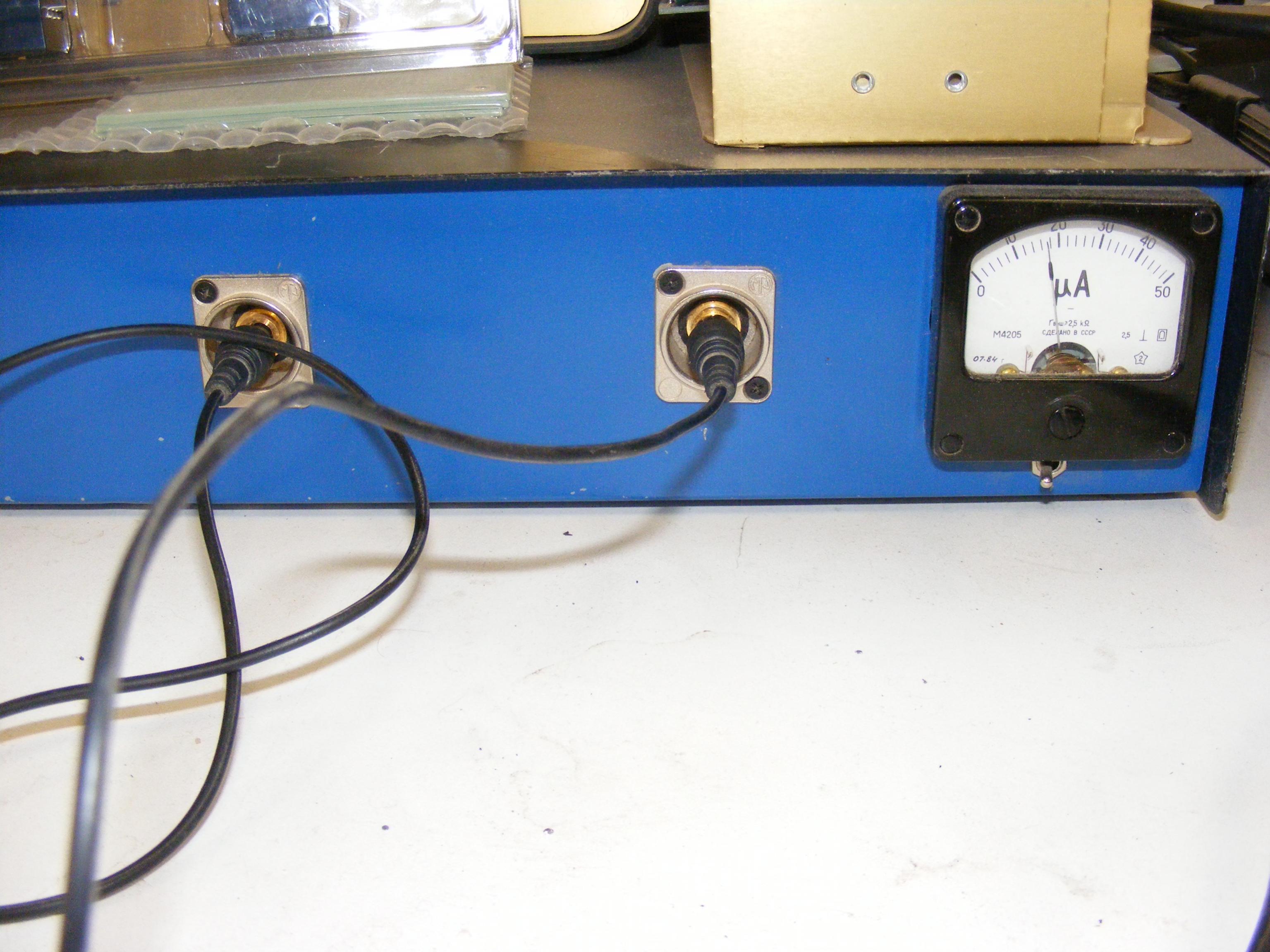

The original version everything was soldered in for testing. As mentioned the tests were on cables being directional, not wires. Although some testing suggested there may be an issue with wires, particularly at frequencies getting to be around a few hundred kilohertz. I suspect this is due to skin effect and surface micro-fractures.
The conclusion in my article was that most folks testing cables would notice a difference as they would be cleaning the connectors as they inserted and removed them.
Now the critics keep assuming things that ain't so. I drive the shield of the cables under test with the same signal as the center conductor from a different resistor divider. The ground link has changed from a copper wire to a copper ribbon to silver.
Today's picture of a cable under test forward and reversed.
