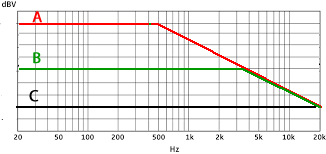

I don't understand the controversies about GNFB.
Open loop bandwidth, open loop gain (and the possible amount of feedback it brings), phase turns and phase margins (poles, stability), distortions.. al this create a multidimensional map where everybody is free to put his own sweet spot.
And each choice of a designer regarding the balance of those elements, each one with its own benefits and drawbacks, in absence of any indisputable audibility thresholds about harmonic and IM/FM distortions, phase linearity, overshoots, dumping factor etc., are just points of views and a matter of personal preferences.
As I read JC, for a given "C" closed loop bandwidth, with close levels of harmonic distortions, he prefers B to C as open loop. (see attachment)
So do I, for various reasons, including listening experiences.
If you agree with this (you are free to do not) it seems logical to prefer C ... as open loop bandwidth ;-)
No one deny the benefits of GNFB and Bruno P. tell the same, saying "if you use GNFB, use a lot". I would add ... "as long as it does not introduce too much drawbacks on other aspects of the amp behavior".
It is obvious that the first thing to try, when we begin to design an amplifier with GNFB, is to improve as much as possible the open loop performance.
And the second, obvious for me, that we have to improve as much as possible the way the feedback signal is subtracted to the original signal in the input stage (VFA VS CFA VS passive = inverting configuration).
Not to forget that we are feeding speakers, IE very imperfect devices, with a dynamic signal constantly changing : Some aspects of the amp behaviors will influence both the way the speakers will react to a given signal and the way the amp will react to the e.m.f they will produce (when gnfb, the output is an input too).
