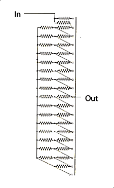

Are those stepped volume controls designed for constant impedance output ?

According to what I've seen, the Elma A47 is not.
The schematic should look like this:
The "special dB Cuvre" cheap DACT versions give the attenuation curve and also tell what series of resistor was used:

They are about 2db per step above the 7th step. I would have preferred a more precise step size for measurement purposes.
I suspect the "special curve" versions are exactly the same as the original version and are just given a higher price.
