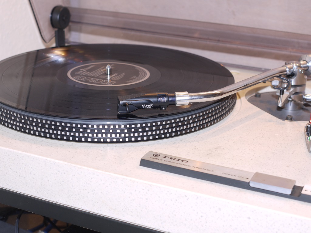

George: It's just the experience was right. We didn't actually sit down through the first 3 tracks. After all this is a 1958 vintage pressing. Remarkably quiet vinyl for the age and didn't even have to engage the mono button. It just clicked for us. Shared experience and all that.
I don't have my mono vinyl setup sorted yet so just used my Frankensignet. I'm really liking this as well as the joy of a fettled direct drive table. Will need to take it off soon for testing Scott/Hans Phantom powered head amp.

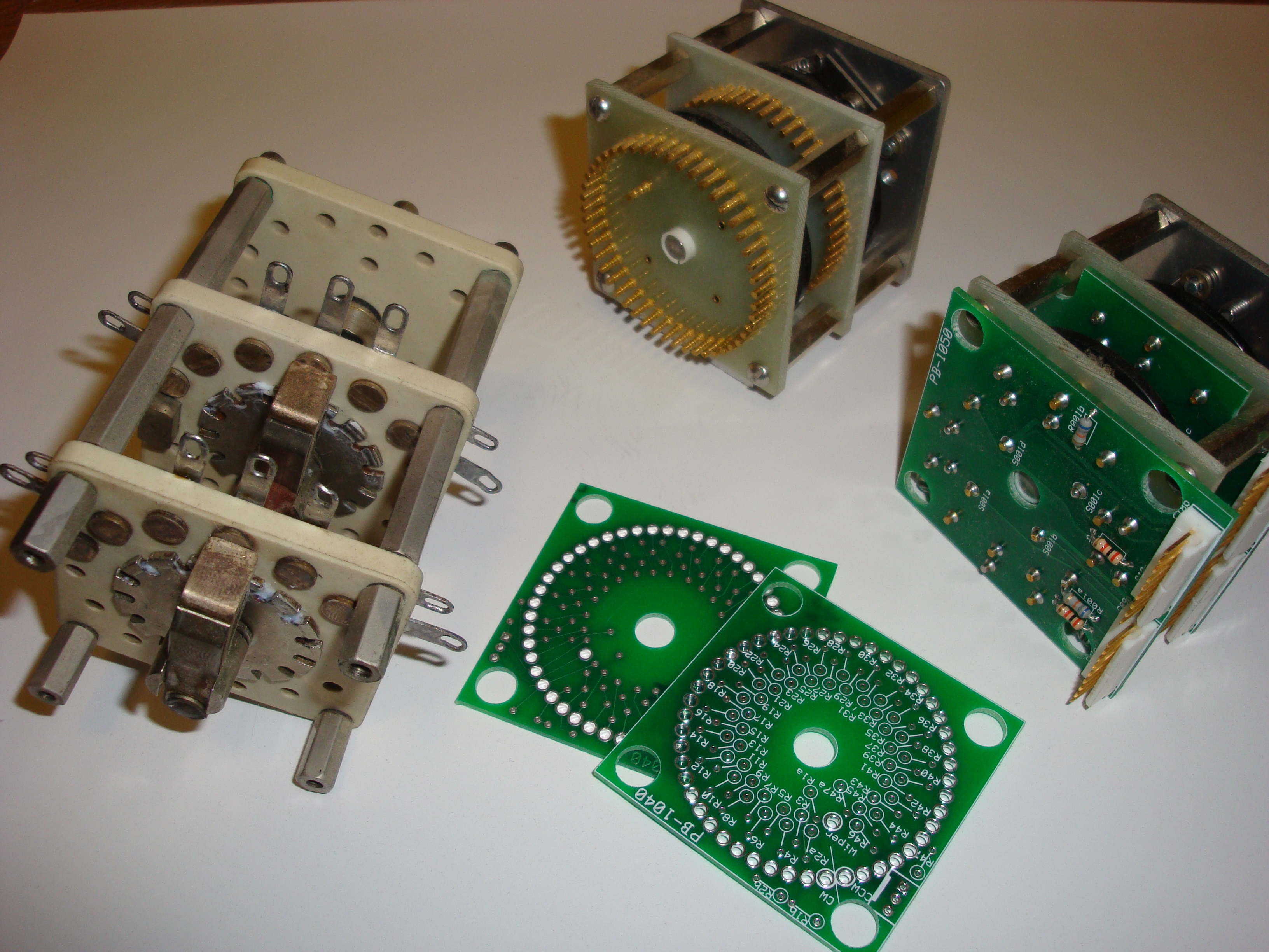

OTOH, the plain MF's give 0.0018%, or 0.000018% @ 1.7Vp under the same setup, so why not use these for not a lot of extra $? Of course, the quality of the contacts is unknown: has anybody tried them?
I once measured significant contact rectification distortion from the famed Elma of Switzerland.
Good point!
Those sound like ****. Either the resistors are fake or the switch device is the problem. You'll stop listening to your stereo.
I used a Goldpoint on one of my preamps (‘Symphony’). Expensive, but nice.
I built a source selector/preamp for CD mastering use and used Shallco bodies for both, the feel of that mechanism and repeatable low resistance and high contact pressure can't be beat.
In the pic below I had a nice ceramic RF switch next to the two Shallcos. I had not loaded the attenuator with the RN60s when this was taken:
I have had really good luck with the Shallcos.
