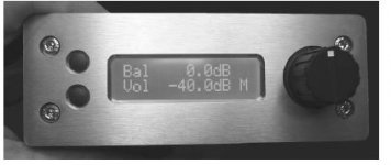

you could add a display... or... use your ears!! 😀
Problem with just using ears is that little darlings go 'ooh can I twiddle that'. The display is a good idea and luckily the fine Mr Didden has an answer for that. A remote display and volume control with proper knobs and such. I can run the miniDSP hot and adjust in the analog domain.

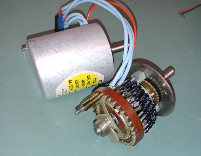

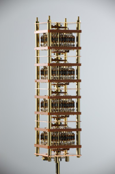

This is what we built for the modified Spectral preamp- A tech Labs 24 position switch (silver contacts and silver wipers) with either Holco (shown) or Vishay S102 resistors. The Vishay version was a $1000 upgrade in the early '90's but was most of what we built. They don't wear out. However Techlabs has vanished and Daven got swallowed up by Shallco and doesn't show on their site any more. TKD made this type of switch as a pot but may not any more. IET may still make that type of switch for the precision resistor boxes but its not a common part any more. If someone wanted to make them they are not complex with difficult to make parts or special tooling.
Tech labs was specific about not using PCB's as a substrate. They said that the connections to the contacts fail over time. Use wires. . .
I managed to get two Radiometer CLT-1's to evaluate pots. One for the source and a second to measure at the output terminals. Alps pretty good Alpha 40 dB worse distortion.
This Bourns pot https://www.bourns.com/docs/product-datasheets/slimline.pdf?sfvrsn=ba6b28e_1 was the only pot that seems to have the same audio performance as the Vishay switch. Only available as a single gang. Detents are available.
Not likely to wear out in a normal human lifetime. The contact surfaces are at least .031 of silver and there are two wipers on any contact. No you may need to clean them if they aren't used. The bearings are pretty substantial. The detent is substantial as well.
