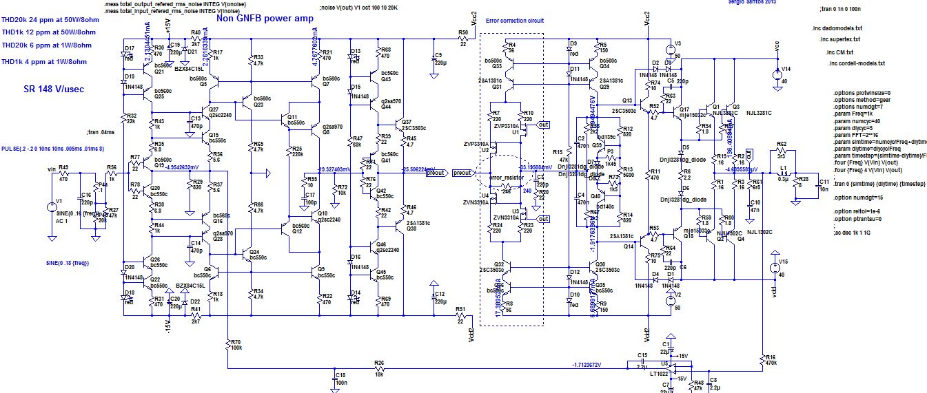

As Kulinummi does not show complete schematic of his non GNF here is mine

Those certainly are excel numbers. and 4 Ohms?
Back in the day, to get such low numbers could only be accomplished with very high GNFB VFA circuits.
IMO this is the future direction for amp design....... Towards inherently linear circuits.

Seems no one here has read the book by Kolinummi? Nothing to do with is GNFB good or bad. Instead, an extremely linear circuit can be designed that does not require GNFB. I would imagine if you then add GNFB to it, the results will surely be stunning.
The effectiveness of adding an Error Correction FB is shown to be VERY effective.
Also, notice the comment that the design being shown by the author is very DC stable such that a DC servo would not be needed.
IMHO This is SOTA and I want to listen to such.
THx-RNMarsh
That is (to a certain extend) the same topologie as was selected for my power amp, a pre-amp and a low gain l(low feedback) power amp (no shared feedback or any...). The power stage has been configured as a current-conveyor.
