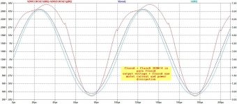

The same amp, one ClassA output mosfet power consumption at 170W/4.

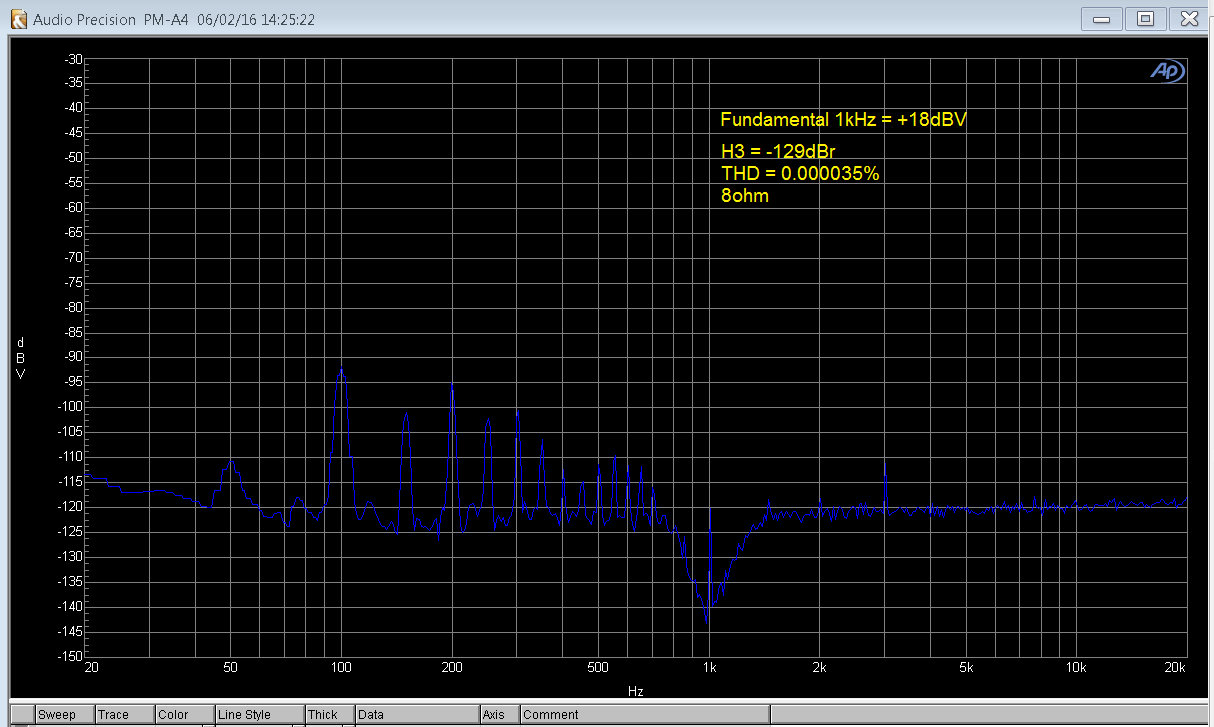

Could you please show the result for 4ohm load at various amplitudes? 8ohm load is unrealistic, I do not know a usual speaker that would have impedance equal or above 8ohm in the whole frequency range. I know that 8ohm results are nicer, but for the real world, useless.
The minimal impedance value of a speaker is its DC resistance. Usually 6 Ohms for a 8 ohm speaker.
An ideal speaker should have a flat frequency curve AND a flat impedance curve. I do not understand why almost all the manufacturers neglect this last point. And it is sooo easy. If you have tried by yourself, with appropriate RLC and LC networks on each speaker of a multiway cabinet, comparing measurements and listening experiences, you'll never go back.
One other advantage is it helps to calculate the passive filters and It should help the marketing departments, showing the near flat impedance curve, to argue about the absolute superiority of their product with their usual BS ;-)
I am sorry but in a multiway speaker it is a combination of drivers impedance + crossover circuit and impedance often goes to 2 ohm at some frequency. I believe you are only joking. Please check some measurements of speakers in Stereophile, or measure yours, if it is not a single driver without crossover. Sometimes I really do not understand some replies here.
