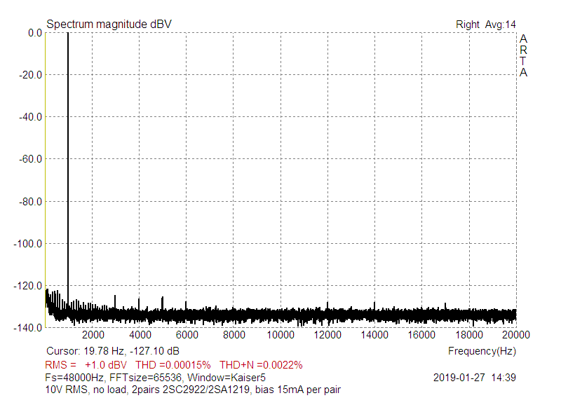

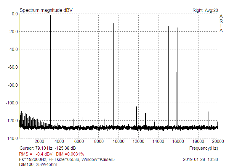

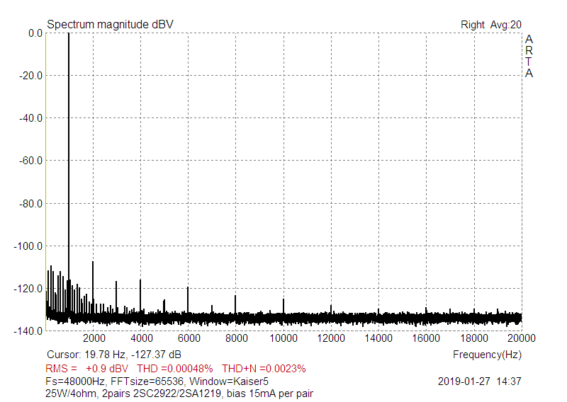

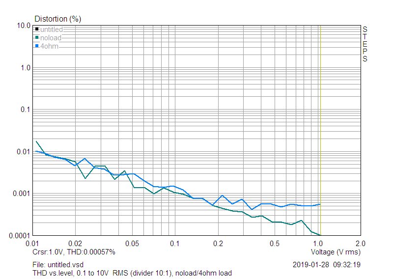

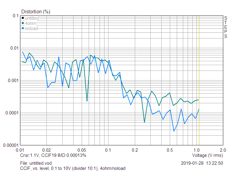

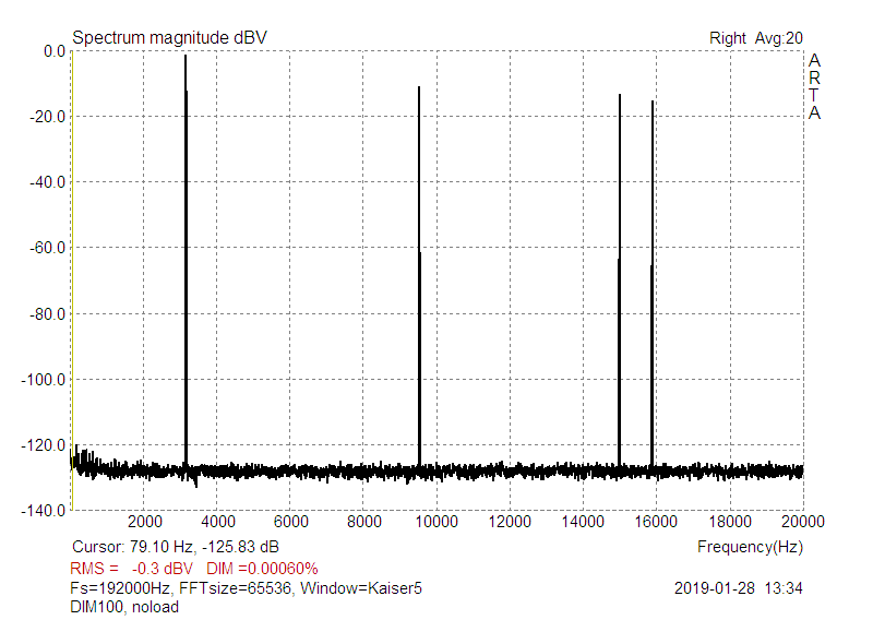

I did it different way, and what count counts are results. And results are strongly depending on output stage topology and compensation schematic. Attached are results for 3EF output stage,with 2 pairs output transistors, with output inclusive compensation (TMC). And bias only 15-20mA for one pair with Re =0,1R (two pairs used). So excess heat is not always inevitable.12.5W/4ohm, that would be quite normal, loud listening level. High bias, higher and high order harmonics negligible. This counts.

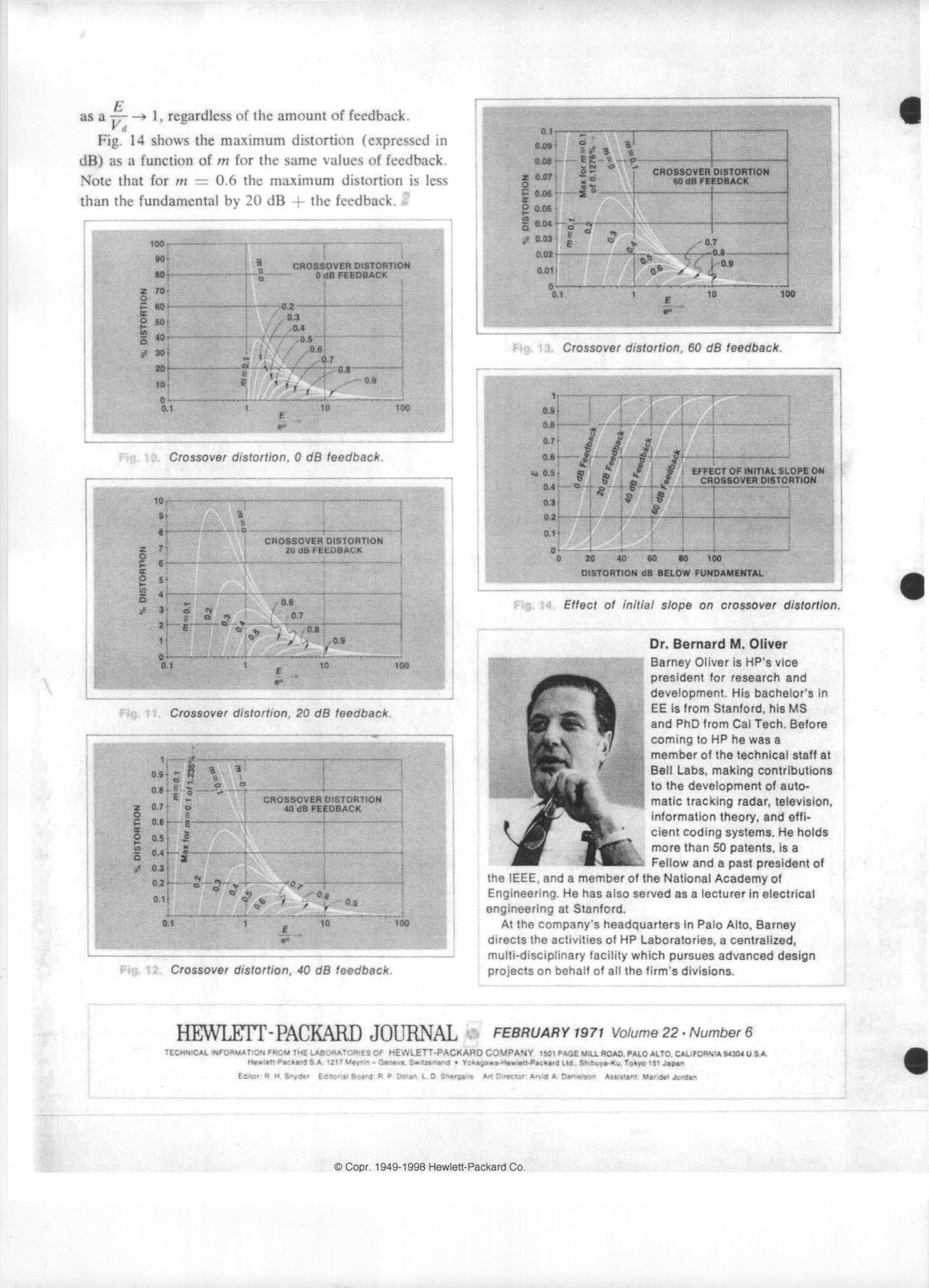

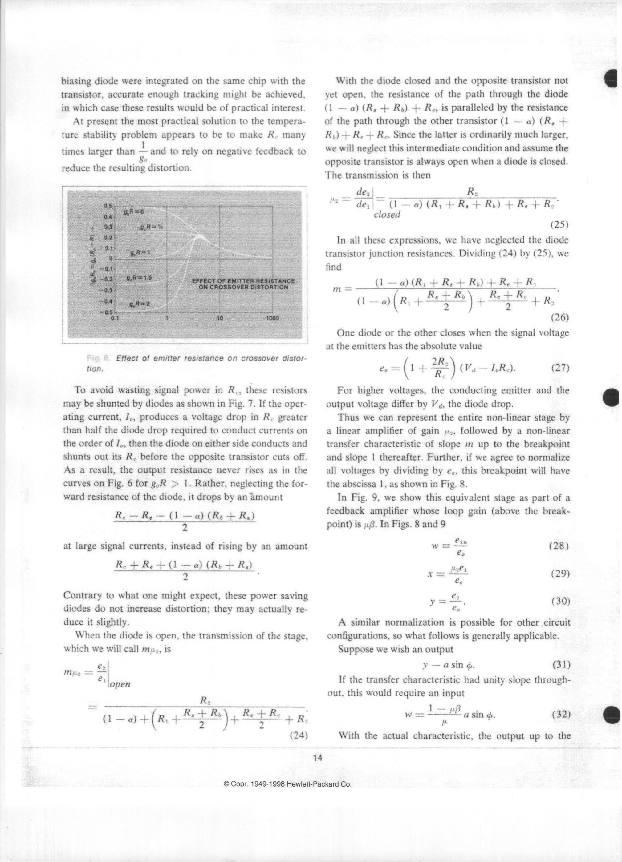

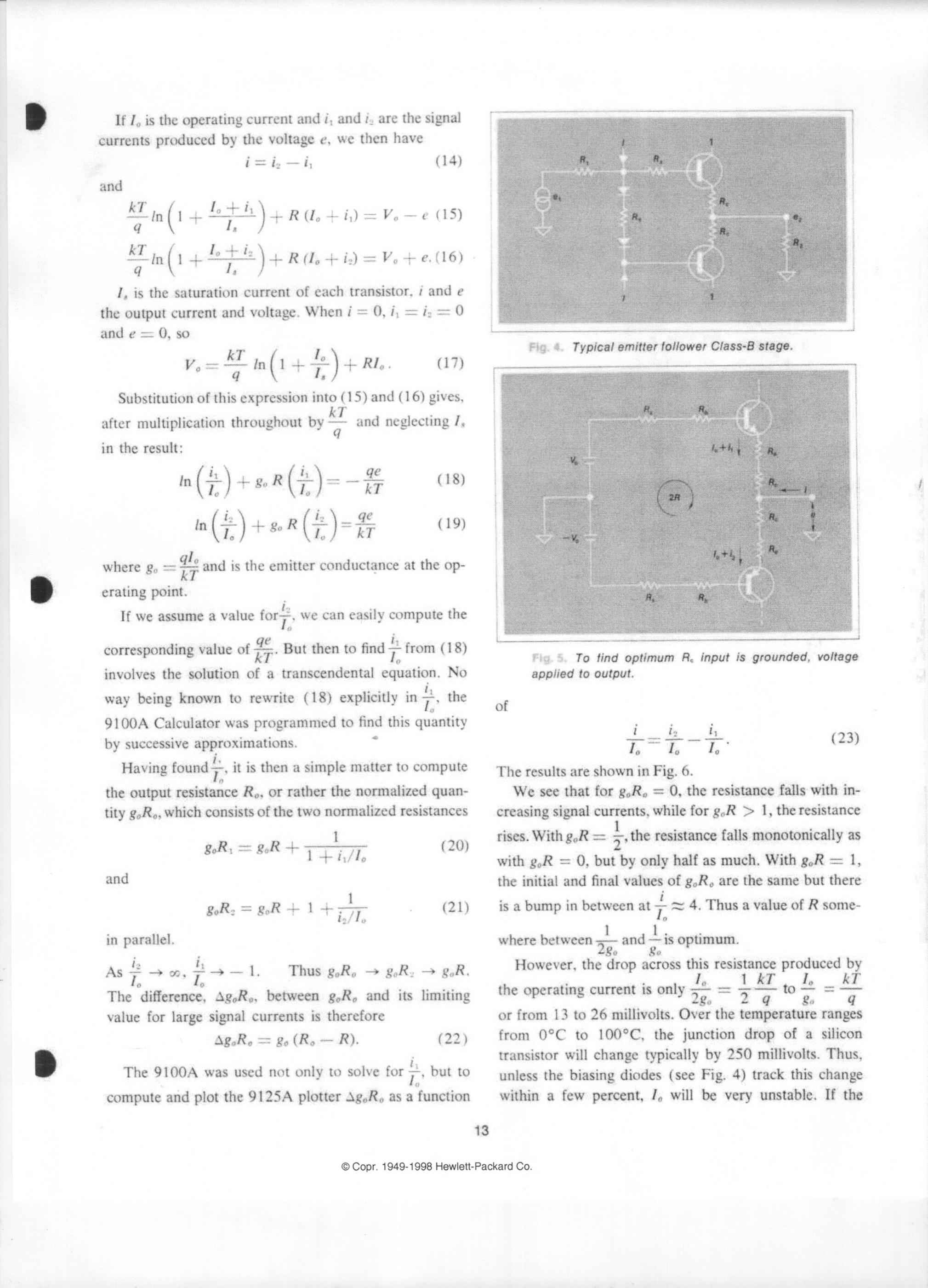

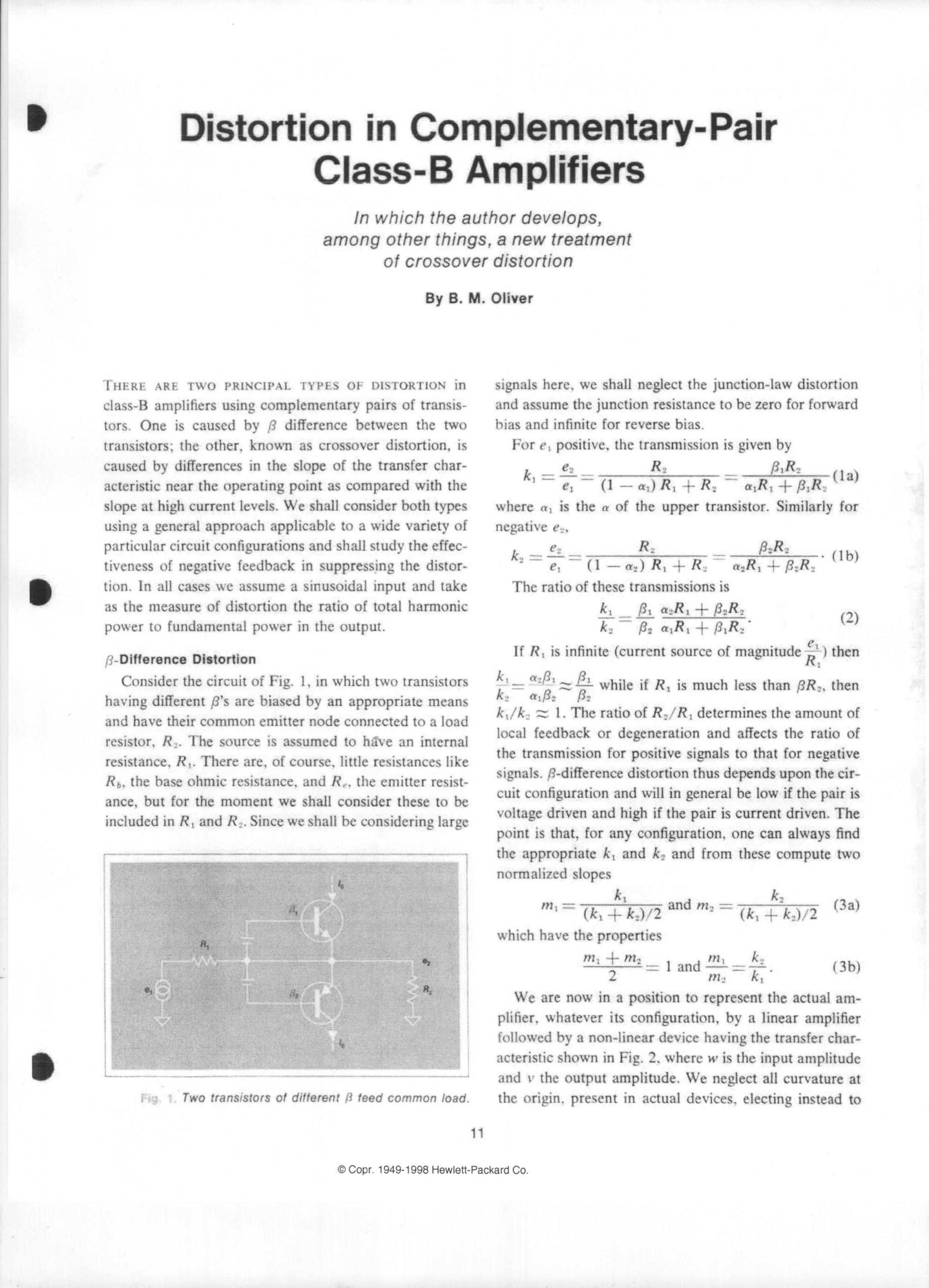

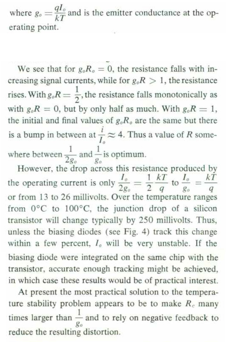

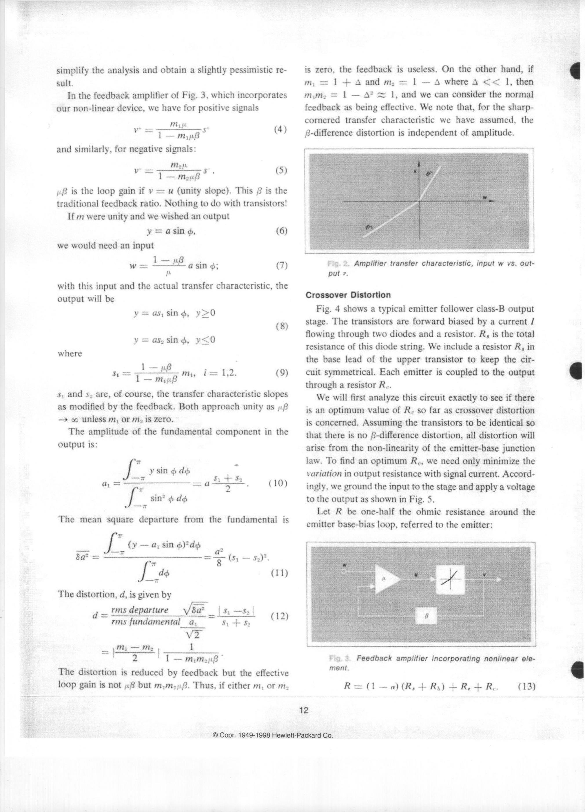

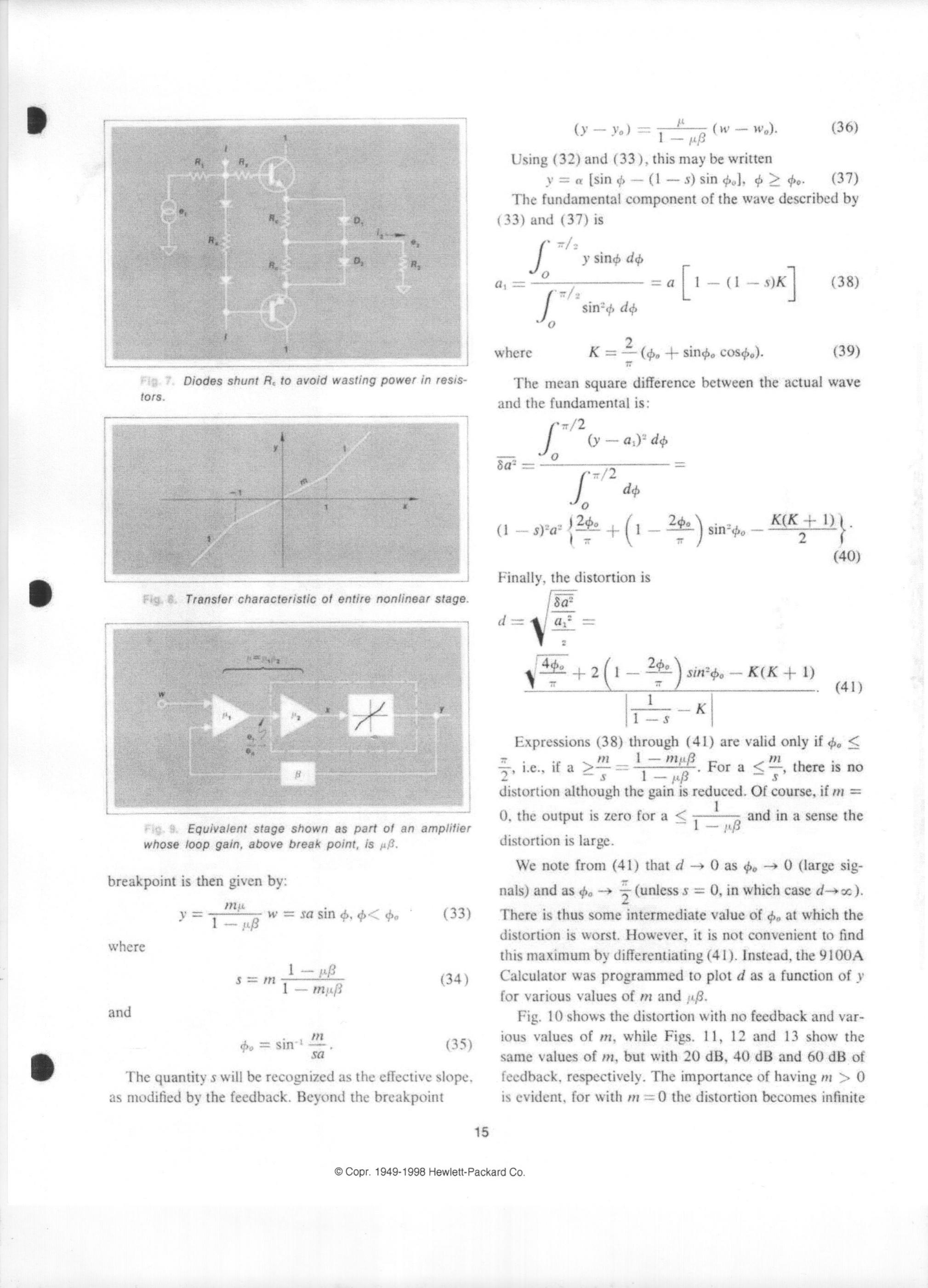

People always seem to forget that Barney Oliver's HP Journal paper actually says:
Screen capture from Oliver's paper attached.
_
1. The optimum value of voltage dropped across the emitter resistance is somewhere in the range 13mV to 26mV
2. However, due to the extreme difficulty of making the bias current accurately track the transistor junction temperature, the most practical solution is to set the voltage dropped across the emitter resistance to be many times (kT/q), i.e., many times 26mV, and rely on negative feedback to reduce the resulting distortion.
_
