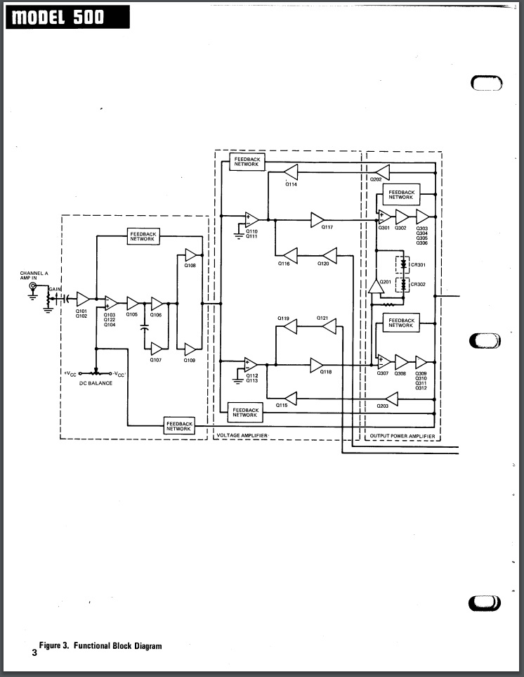

You obviously either had a defective bunch of 500's, or you haven't a clue about them. I repaired them for Superscope as I had the high rating level for service depots (I was allowed to work on everything). I also did overflow work for them. I kinda think I know those very well, and that doesn't match up with what you are claiming. Fast? The 250 was faster so much so that you could hear it in the audio range? Naw, that isn't a true statement at all John. Do I detect some heavy biases against an excellent product there by chance?

John, that product line was not designed to be good. It was designed to sell at a low price point while making a good profit (a really good profit actually). Compare it to any quality amplifier that uses a set of KT-88's. You will see very quickly where corners were cut (everywhere). Even the output transformers are too small for the power output. A core can only support so much of a flux density before it begins to saturate. The worst part of this is that you are well aware of this and are posting as if this wasn't a problem.
To tell you the truth, the biggest problems I have had with all amps is how poorly they have been serviced. The 500 had this problem in spades as people generally did not take the care and attention to detail that this design needs to perform at it's best. This is true of all power amps, but serviced properly, they are amazing amplifiers. Amplifiers

I don't have to look it up. I am familiar with it as well and it is a very good amplifier. A rebuilt 500 is better though, sorry.

The 500 was designed in 1968, sold from 1969 to 1974. That's an old design, around the same length of time you have been active in electronics design, right? Now there is a design you should study John.
