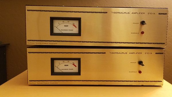

Wow, a blast from the past! I built a number of SWTP amps in the 1970s, including a pair of Tigersauruses!
They were expensive to keep running, but looked pretty cool with big ol' meters... The regular Tiger was a good sounding stable design, however and a fantastic value at $1/watt:
I learned a lot about amp topology and repairing amps building SWTPC stuff...I also built their guitar amp head, digital instrument and other stuff, they were fun to build!
Howie
I haven't found info on the treble/bass/balance preamp board yet. The amp sounds really pleasurable but it does seem like it is probably flawed by some of the old capacitors and pots (instrument localization isn't great, but they sound real nice). This one is different because it has those lamps. The transistors being used are not the standard recommended onesl. I really wish I could just figure out how the hell to get under the amp boards to below... It's a serious puzzle box. You can't unbolt the transformer, and if you unbolt the metal holding the amps, it can't come out either... heh.
I wasn't even born when they came out.
The lamps do turn on during clipping it seems (only when amp is being pushed, the enclosure it came in that isn't anchored at all, wood, has little orange see through plastic things that go above the lamps). The input transistors are 6566, then there's a 6533 & 6530.

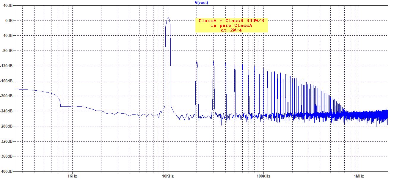

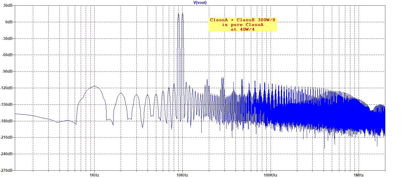

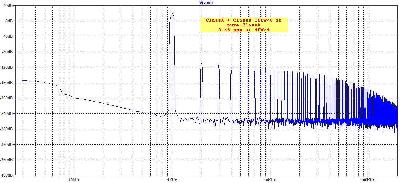

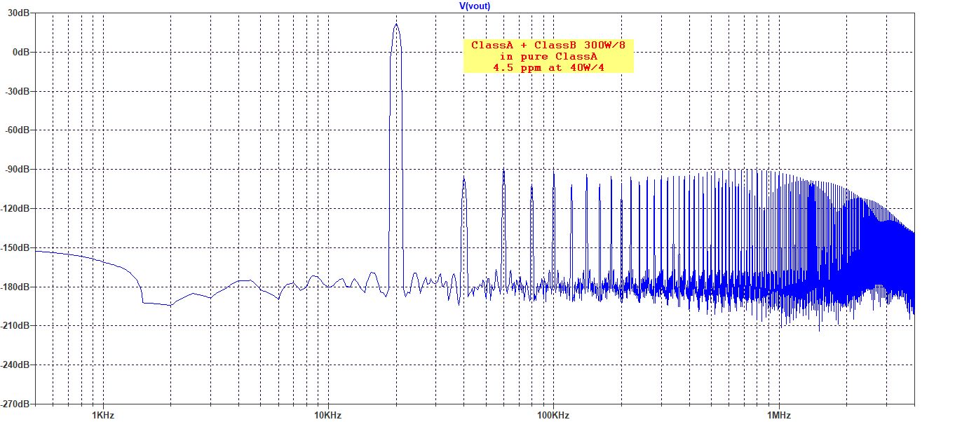

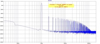

Could you please show the result for 4ohm load at various amplitudes? 8ohm load is unrealistic, I do not know a usual speaker that would have impedance equal or above 8ohm in the whole frequency range. I know that 8ohm results are nicer, but for the real world, useless.
I showed this FFT to compare with one Richard showed from Kulinummi Audio Power Amplifiers book.
Here are some more.
