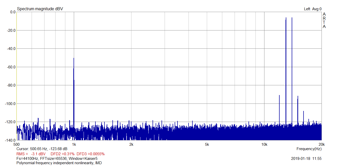

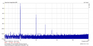

Attached are measurements taken on a system with polynomial, frequency independent non-linearity. It is a harmonic distortion at 1kHz and twin-tone CCIF IMD distortion 13+14kHz, with difference tone (H2) of 1kHz. Both signals have same peak amplitude. This means, 13+14kHz rms value is -3dB compared to the 1kHz tone and each of the 13, 14kHz tones have amplitude -6dB compared to 1kHz amplitude. Harmonic and IM distortion components are easily readable from plots. This might stop the discussion on IM x HD, I hope, but remember that the result is only valid for a polynomial frequency independent non-linearity. One can see that the relative H2 component with respect to amplitude of the single tone is the same in both cases, taking into account that IM signal components are -6dB of the 1kHz test tone. Distortion doubles with double amplitude.

The before mentioned conclusion from the taylor series for the difference frequency method isn´t related to the HD2 from an excitation at the difference frequency but to the HD2 component from each of the two excitation signals (in case of the afore mentioned closely spaced frequencies).
So if you use 1000 Hz and 1070Hz as input signals (same amplitude) then the level of the IM2 component at 70 Hz should be 6dB higher than the level of the H2 component at 2000 Hz or 2140 Hz.
