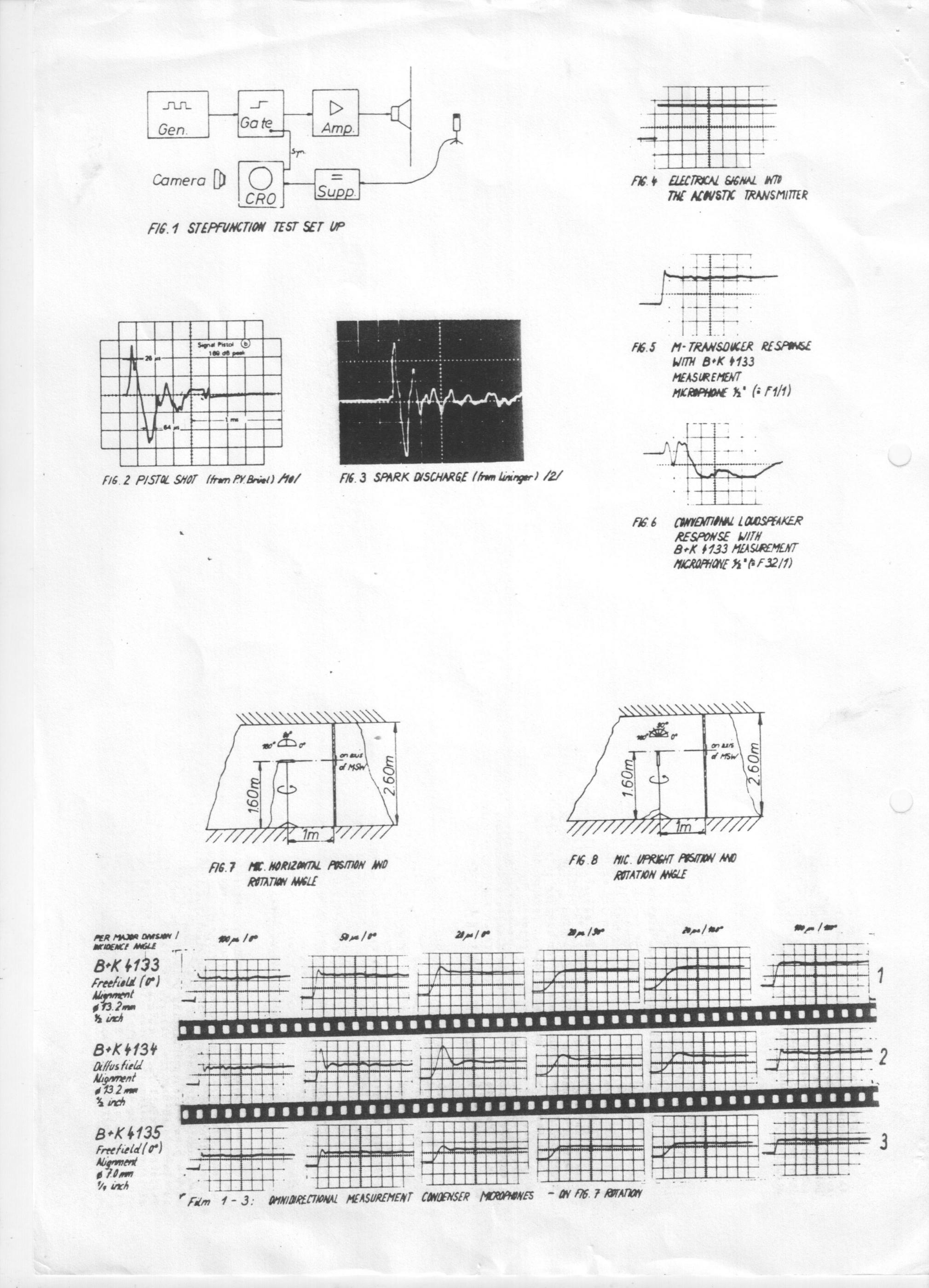

Demian, as far as the Manger transducer is concerned, I have never had one to play with, even though I first met Herr Manger as early as 1975. Listening to one of his speaker systems was a disappointment though, for some reason. It did some things very well, but not well enough compared to many other speakers that I had heard.
However, Herr Manger made a microphone calibrator from a smaller version of his transducer and here are some of the results. He measured just about every popular condenser microphone in his paper, as well. His calibrator is a lot easier to follow than any spark gap, etc.
