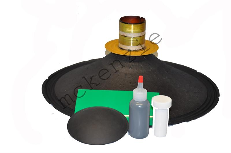

JBL Eon 15 G2 Recone Kit 2 Ohm
I have not investigated JBL Eon magnet assy, maybe some food for thought ?.
Dan.
Dan.

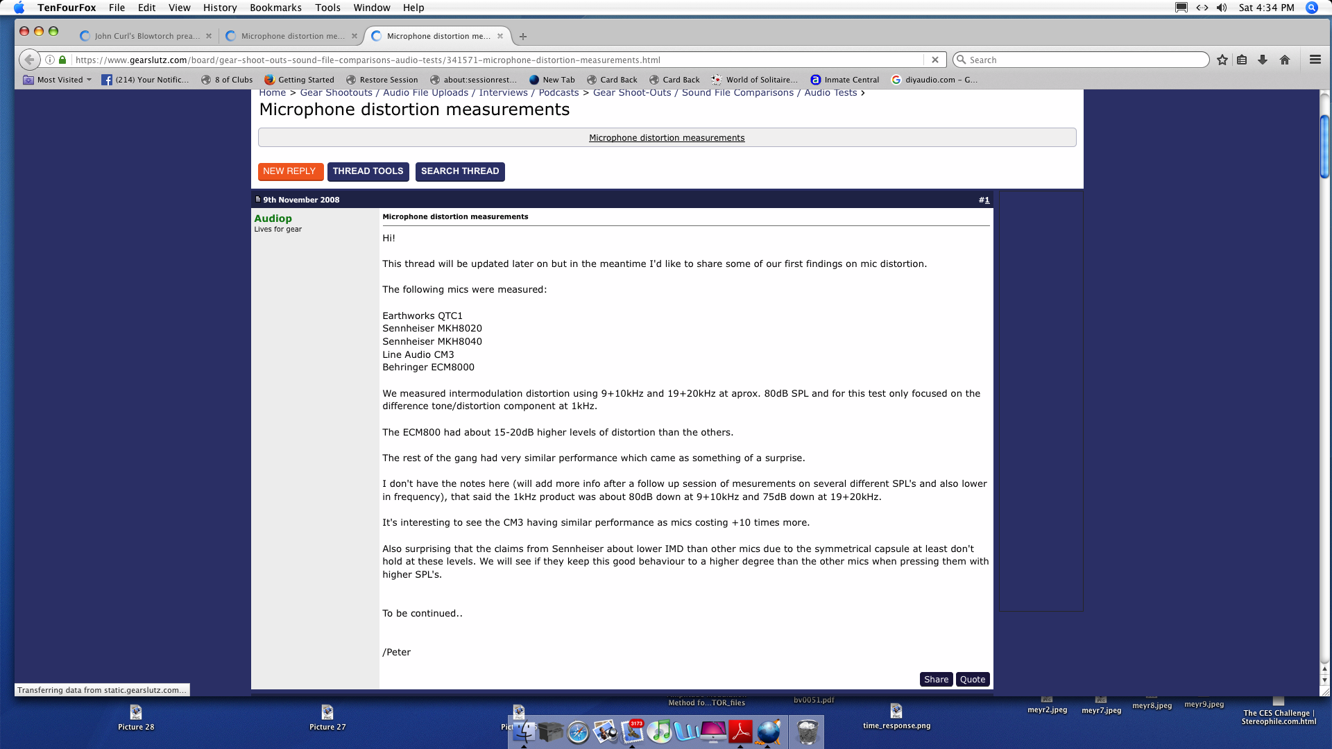

Very interesting thanks! The Sennheiser might have a symmetrical capsule but they use an FM detector which I remember as being very hard to tune up to stay at -80dB consistently. IIRC the Foster-Seely and ratio detectors both have dominant seconds when tuned off center a little.
Dan.
Oh. Yes, recone/repair kits. That would make it a lot easier to modify and change VC windings etc.
THx - Richard

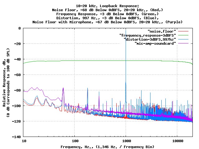

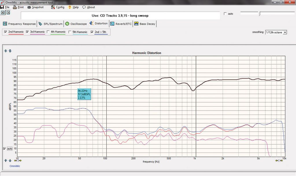

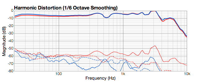

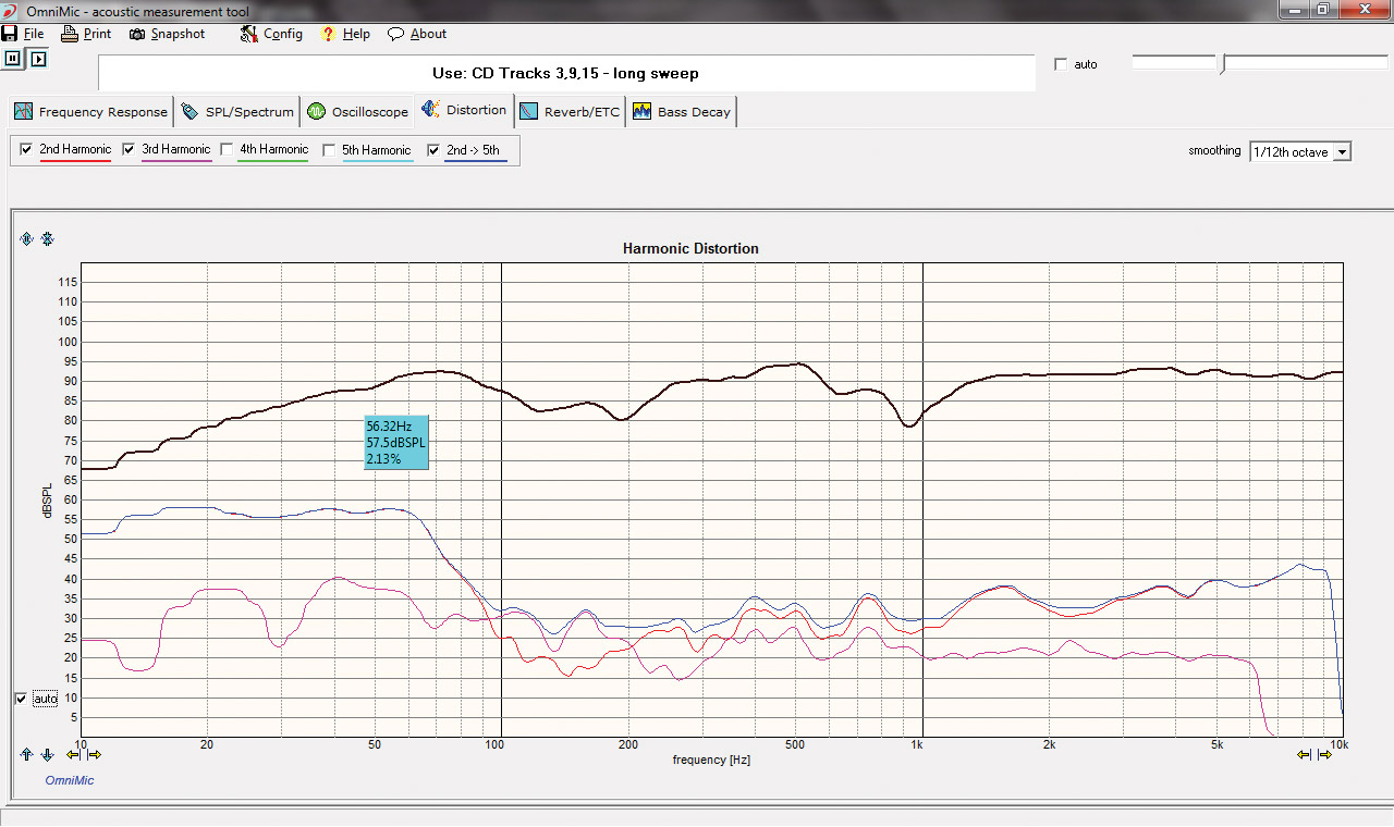

Richard, I must have missed what distortion your inexpensive mike has at lower, but usable operating levels. What do you expect at 80spl? Or any other near amplitude?
I will put some of them up - only electrets --- the typical THD ranges from -60 to -80dB on these three.... Plenty good enough for dynamic speaker driver measurements. I have others also -- some with very flat FR.
I ordered OM1 Line Audio for its low THD and high SPL: 133db at 0.5% THD.
Over-all, these mic types are fine. And many come with correction files for FR.
They are a suitable choice for DIY tests and are low cost, too.
THx-RNMarsh
Yes. That company and others (one was referenced here) can supply all the bits to build drivers from scratch, and economically.Oh. Yes, recone/repair kits. That would make it a lot easier to modify and change VC windings etc.
THx - Richard
Winding bespoke VC assy's then coupled (glued) to off the shelf cones and surrounds and baskets looks like ripe for experiment.
I expect there are DIY speaker driver forums that are catered for by the above kinds of suppliers....there might be some good experience there.
Dan.
