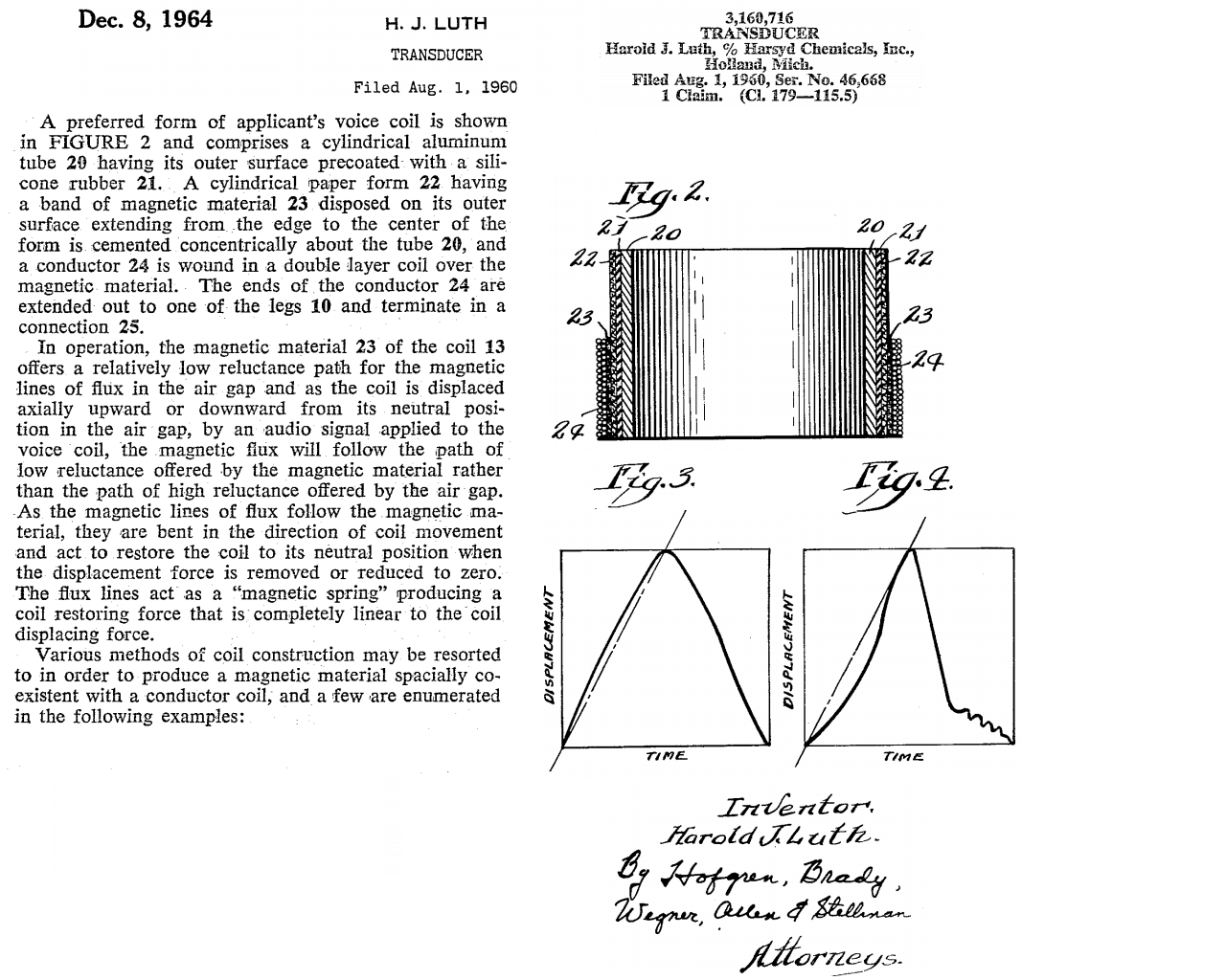

Almost all these interesting ideas were a subject of an issued patent. Check out “Luth, Harold J.”
I had heard a 10inch FR Hartley of such a construction and it was really good sounding
George
yes. That is cookie-cut from thin fiberglass sheet.... very stiff. The cone edge surround is rubber/cloth.... very flex.
Both have same affect as to tug on the VC/cone and cause distortion.

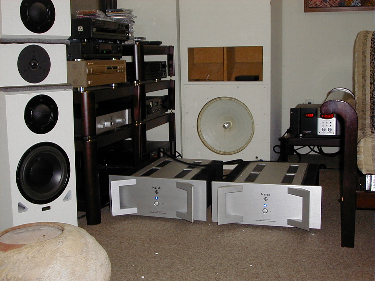

back in the day (1970-80-ish ?) ---- this is the Hartley Demian is talking about.....I had a stereo pair of the 18 inchers in a rear loaded folded transmission line (See Speaker Builder). measured flat to 16Hz in my room. At one time I laid them on their side and sat the original QUAD ESL on them... made the ESL about ear height.
I am not sure how well the magnetic suspension idea worked... didnt see any harmonic tests at that time. But , i think Ferro-fluid has replaced this idea.
Hartley 218 drivers as subs for a custom built DynAudio 3-way (W-M-T-M-W).
When I did not need them...I gave them to my brother-in-Law who used them on stage in northern California clubs ... he is obviously a bass player. he loved the sound but not moving them. Each the size and weight of a refrigerator.
It’s not the same concept.
Ferrofluid is concentrated along the width of the front plate and stays focused there.
It doesn’t move with the voice coil like the iron particles which are glued on the voice coil in the patent of Harold Luth.
Therefore with ferrofluid, the flux flow isn’t moving along with the voice coil.
Subsequently ferrofluid can not provide any magnetic restoration force.

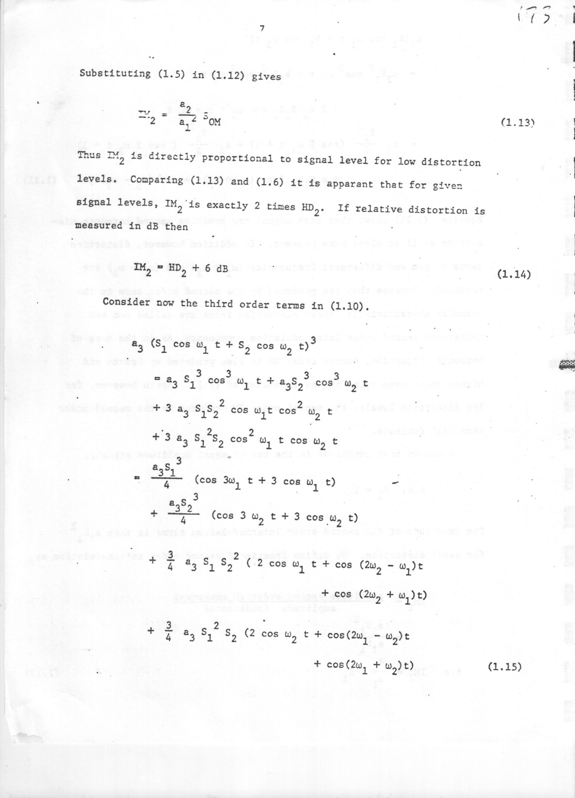

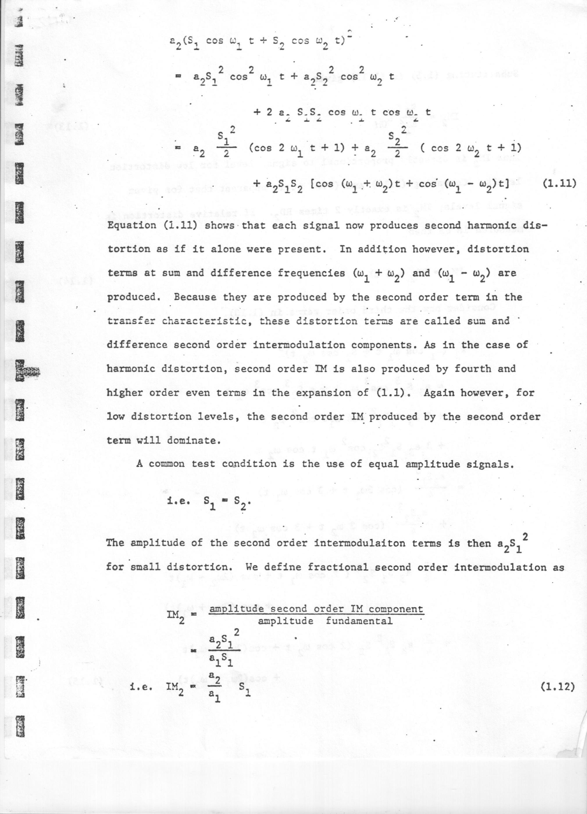

But in fact, under the assumptions that the system under test is still working in a weakly non linear fashion and the excitation frequencies are close together (so additional frequency dependent effects can be neglected) then from using a Taylor series for approximation of the transfer function it follows that HD2 = 0.5 x IM2 (frequency of IM2 = f2 - f1)
Of course it is an idealized description of the system and real life measurements will diverge a bit, but it shows that the two tone difference frequency measurement is suitable to give a fairly accurate figure for the HD2 number.
So, i wasn´t _completely_ mistaken then.... 🙂
And what about finding H3 from that test?
THx-RNMarsh
Can you derive enough info on the transfer function from an IM measurement to predict the specifics of its harmonic generation? Especially when its very linear to start with?
if so I'll start playing with IM measurements on microphones next week. John Curl now has mike preamps and can so some limited stuff with his microphones.

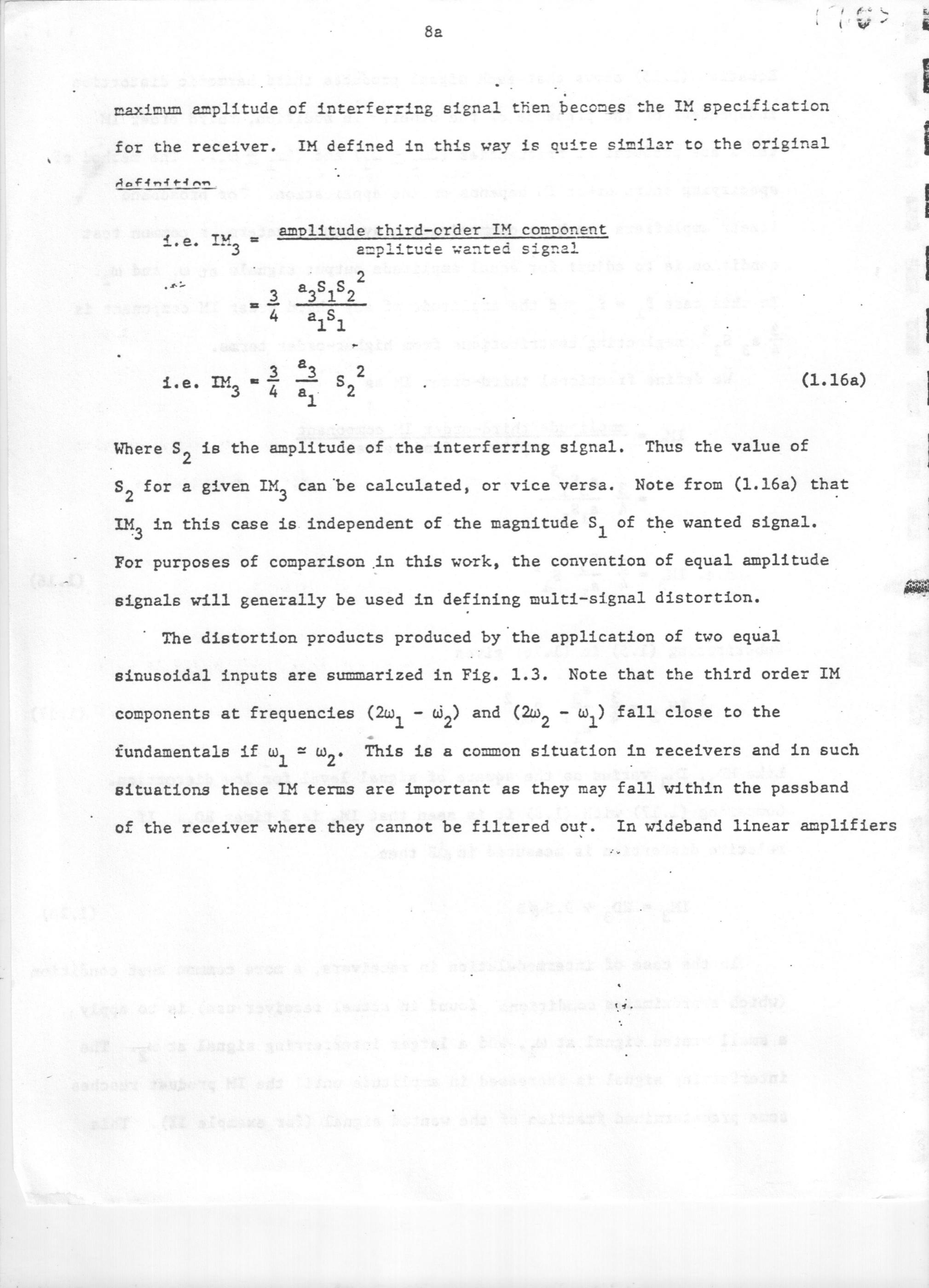

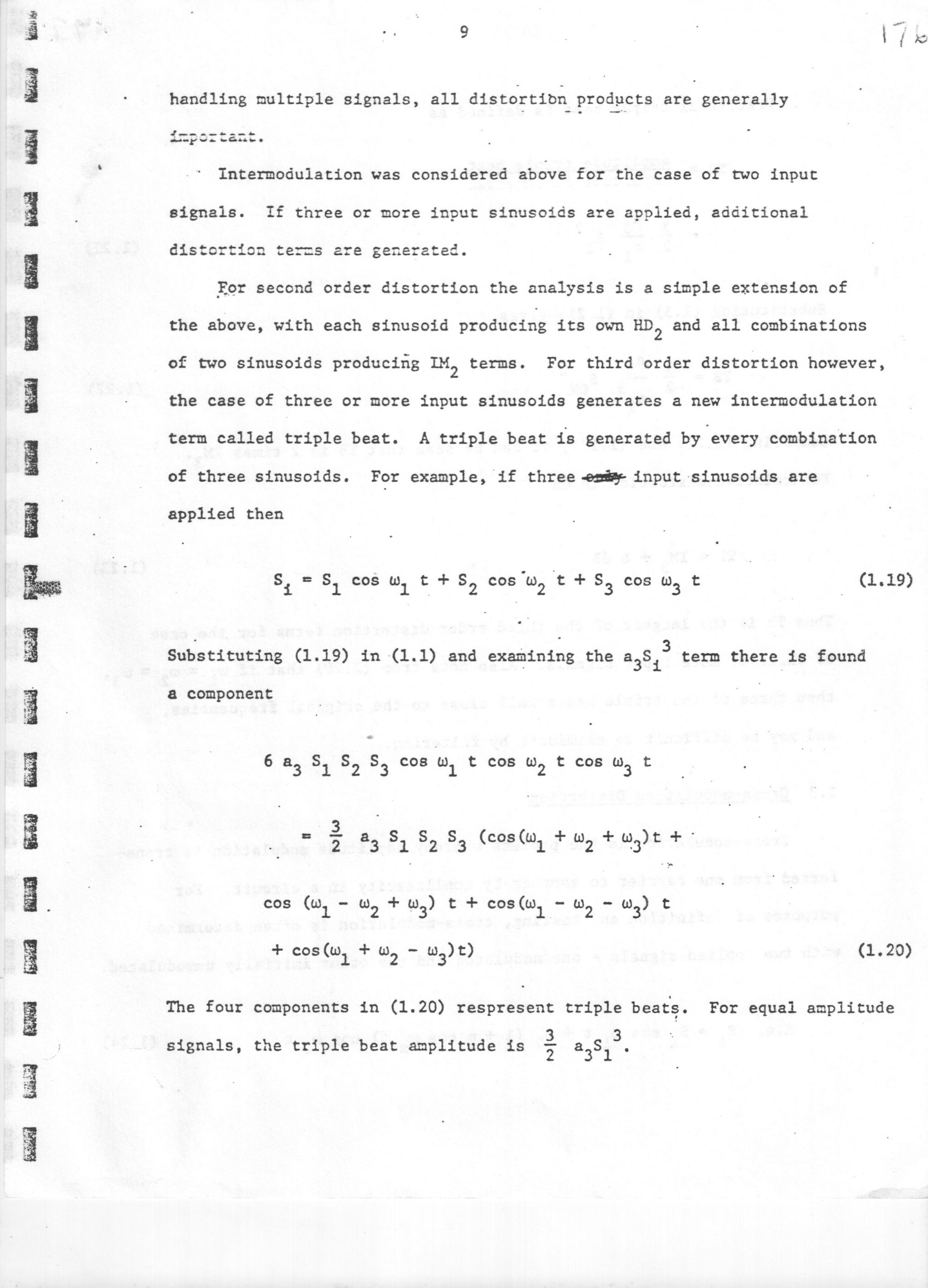

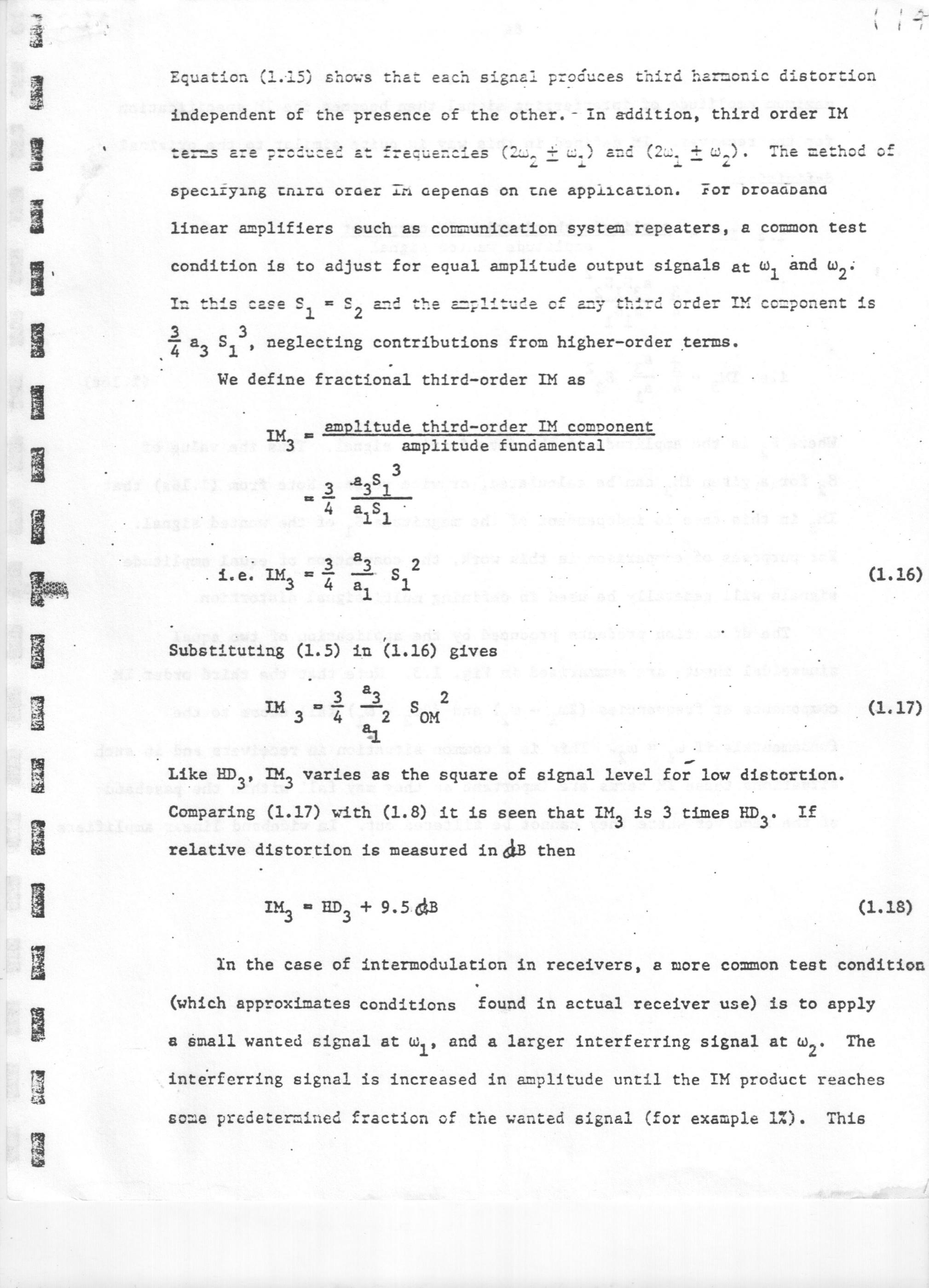

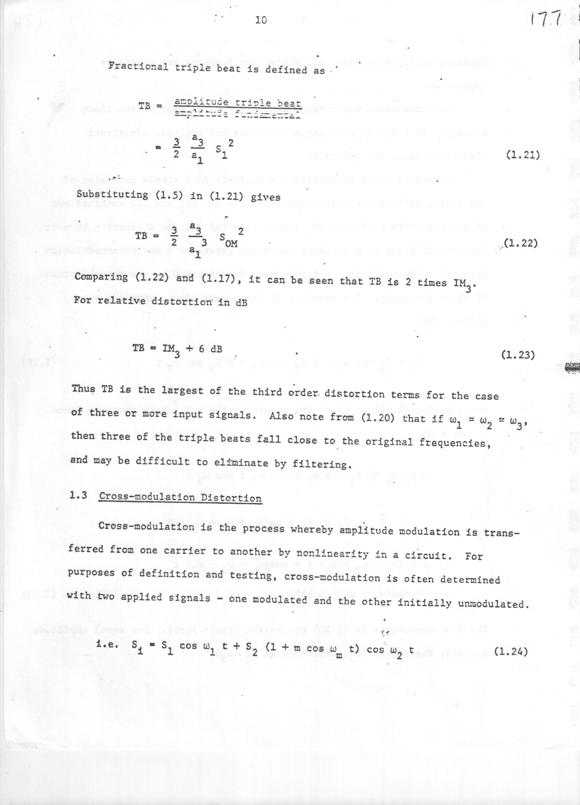

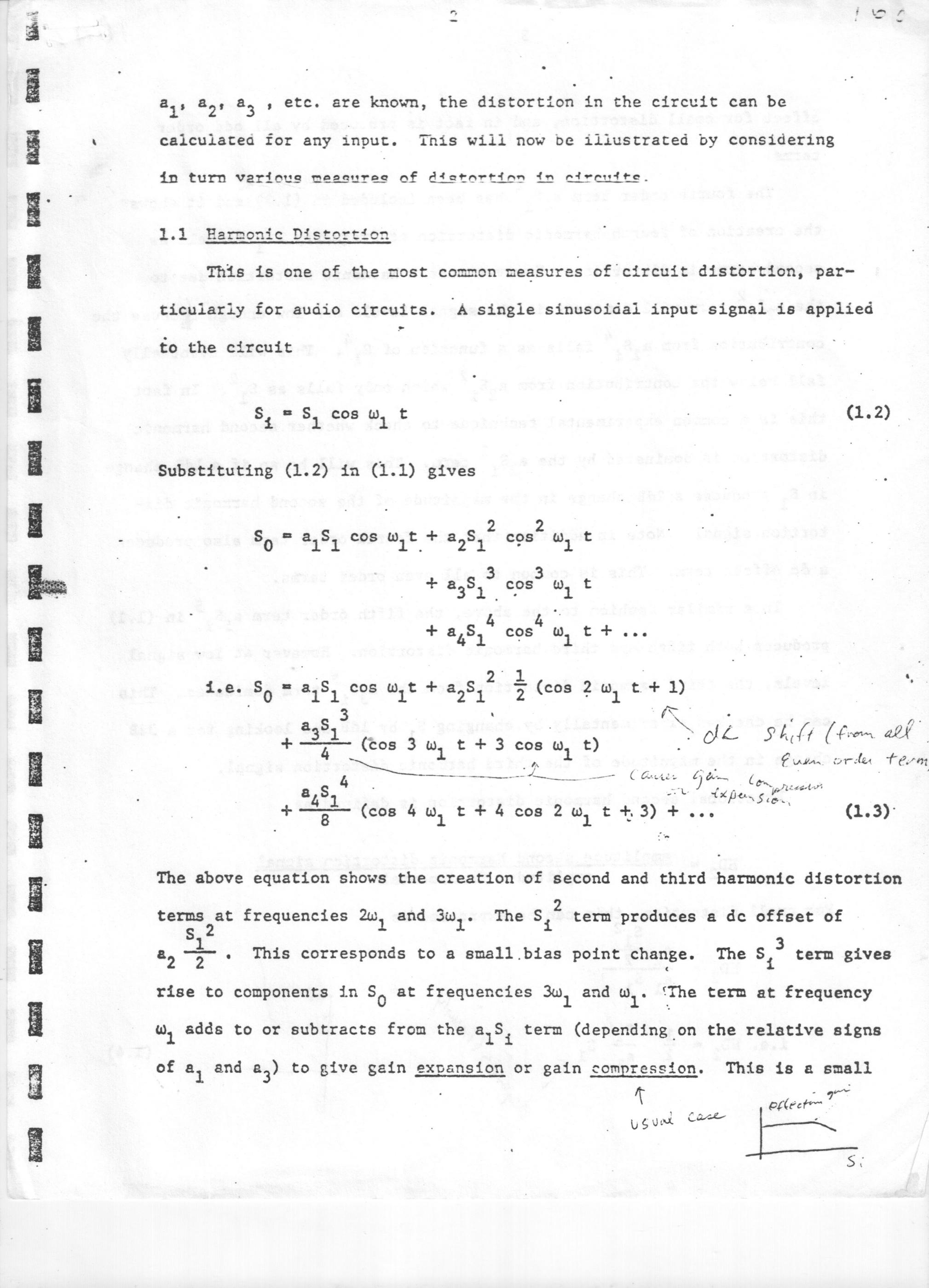

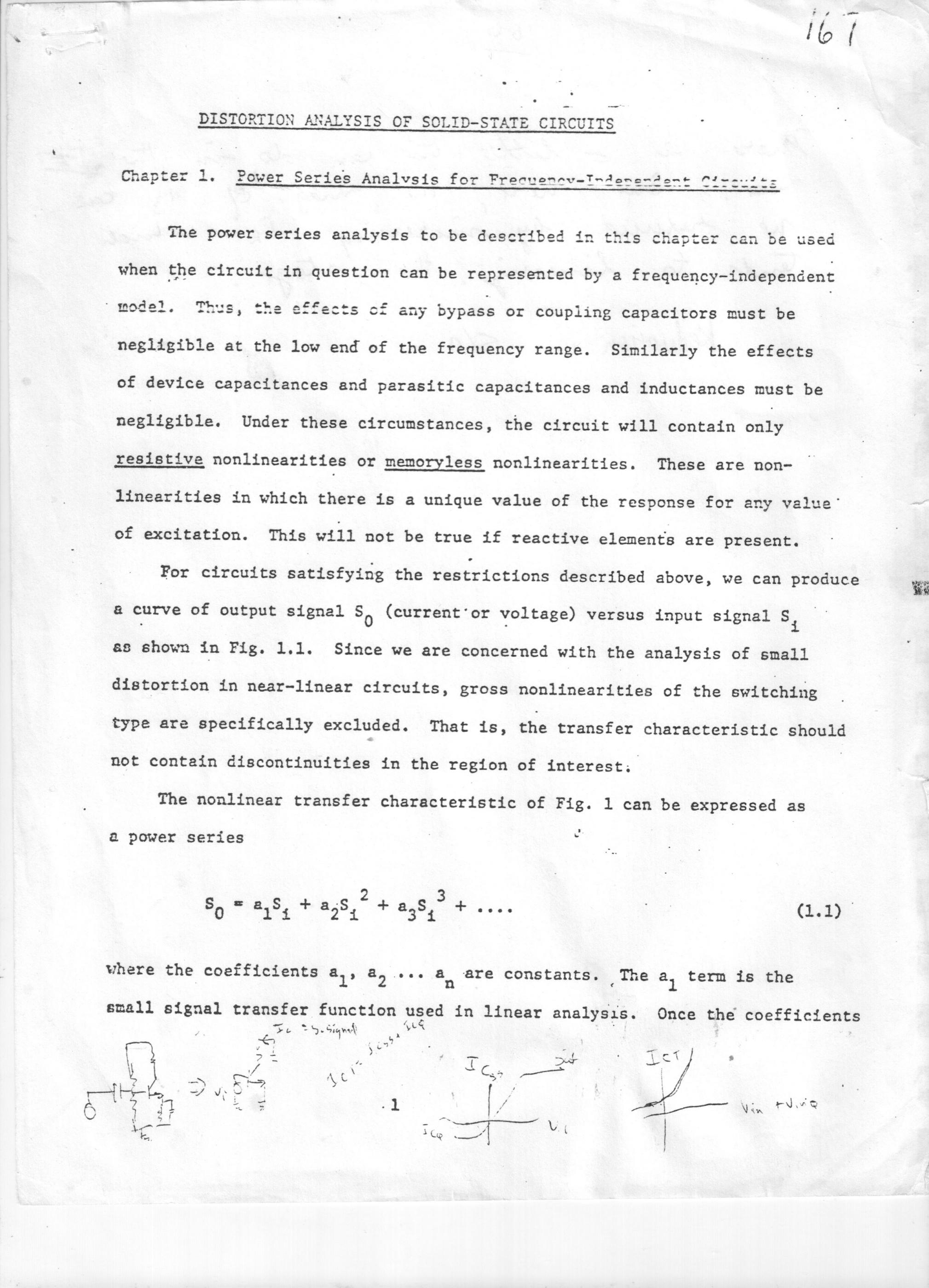

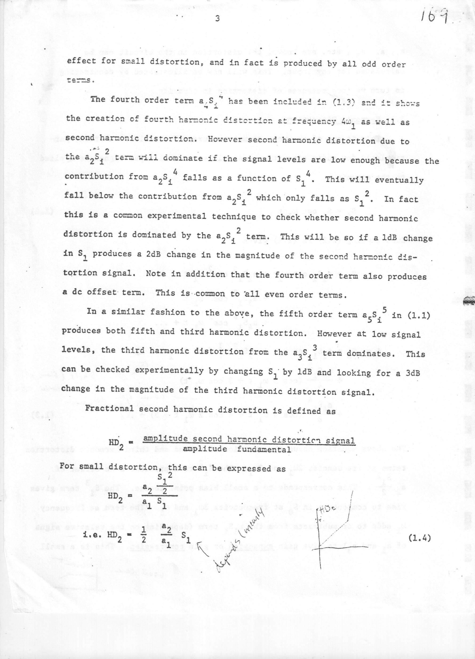

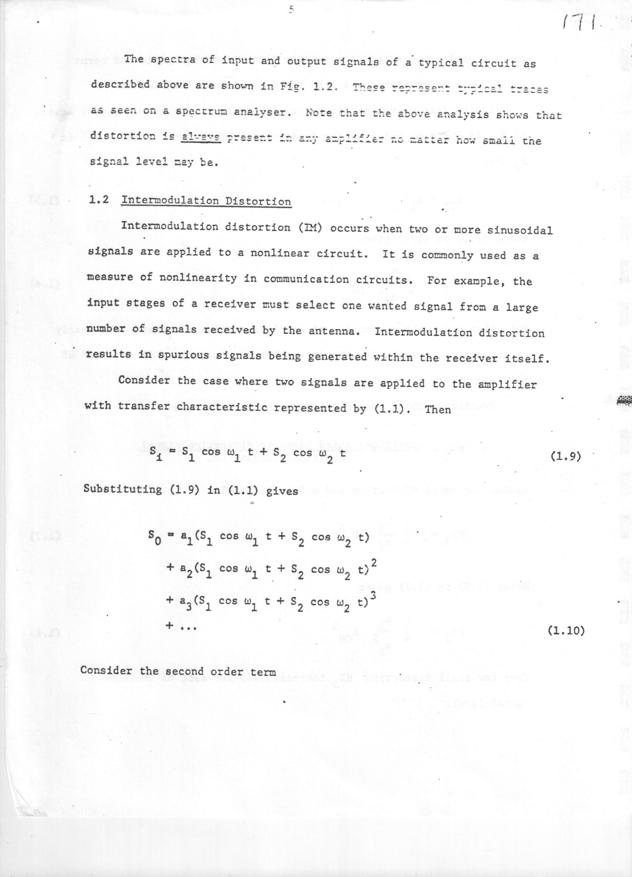

more distortion lecture. These are lecture notes from Prof. R.G.Meyer formally teaching at UCB.
