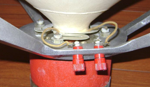

This is the Hartley spider that a variation is still in use (or so they claim). its a spring. NOW AVAILABLE
Most speakers rely on the surround to limit the travel, not the spider.it can be another source of distortion, both from radiation and nonlinear flex.

yes. That is cookie-cut from thin fiberglass sheet.... very stiff. The cone edge surround is rubber/cloth.... very flex.
Both have same affect as to tug on the VC/cone and cause distortion.

You could make a spider like the one above out of phosphor-bronze or beryllium-copper and use it for lead out connections as well.
Read through the white papers on the Hartley site. They mention a "magnetic" suspension they worked out in the 1950's along with a number of other interesting ideas.

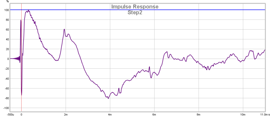

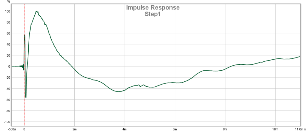

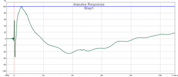

PMA, I hope you realize that I was being polite. '-) What I see is a 3 way speaker with the tweeter leading, with a midrange out of phase, lagging by about 0.5ms, then the woofer coming in sometime. I cannot make a direct comparison, because the usual measurement is a step response that has more low frequency information, so far as I can tell.
Is it the fact that you used a pulse rather than a step and how relatively 'clean' it graphs?

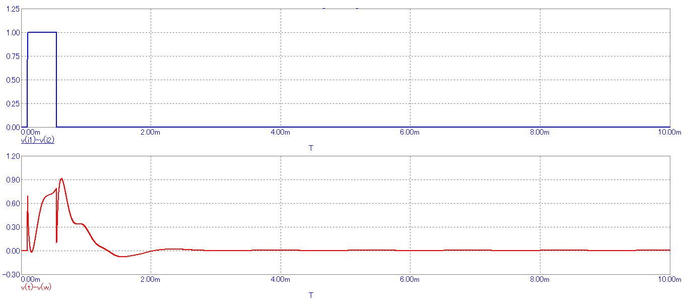

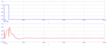

It is a 2-way speaker, in fact. Those time responses are difficult to interpret correctly and even more difficult to get any correlation between visual shape and listening impression. What we call "time lagging" is in fact a phase information of the allpass cross-over circuit. Impulse response is more useful than a popular step response. We need to get a proper phase from the drivers to prevent dips and suck out of the frequency response, that would lead to strong sound coloration. It is the electrical signal from the cross-over that creates visual time lag. The step response is as it is and is a secondary product, not a primary goal.
I used the impulse of finite length to get some energy, a single sample impulse produces low SPL amplitude. I posted the time record intentionally, because the popular interpretation is often incorrect, IMO, and should not be a primary goal in a speaker design, separately from frequency responses and directionality pattern.

Excatly. Point in case. The step (or any other time-domain) response contains no other information than the total phase (and magnitude) response. By looking at it in isolation, it is absolute impossible to see how many drivers are involved and how the XO is setup, if any drivers are inverted etc. I always have a healthy laugh when I see how people try read things from a step response that just aren't there (and quite often they are wrong, myths and dangerous half-knowledge are spread this way), even the "professional" reviewers in Stereophile etc are prone to this guessing. For me it is clear indicator that they have no clue about speakers from a systems theory standpoint.It is a 2-way speaker, in fact. Those time responses are difficult to interpret correctly
