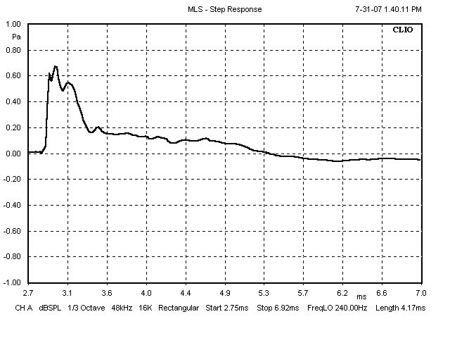

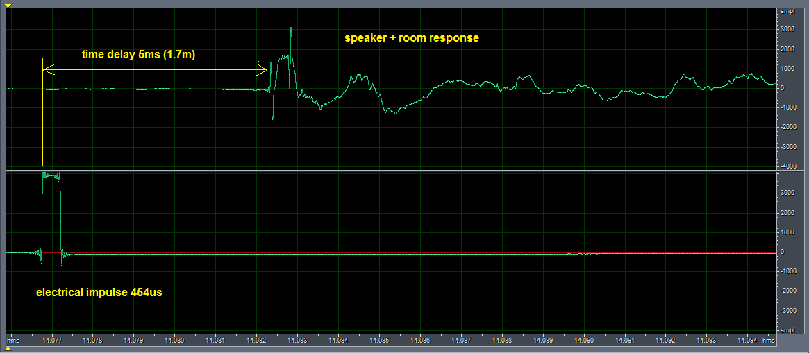

PMA, I hope you realize that I was being polite. '-) What I see is a 3 way speaker with the tweeter leading, with a midrange out of phase, lagging by about 0.5ms, then the woofer coming in sometime. I cannot make a direct comparison, because the usual measurement is a step response that has more low frequency information, so far as I can tell.
Is it the fact that you used a pulse rather than a step and how relatively 'clean' it graphs?

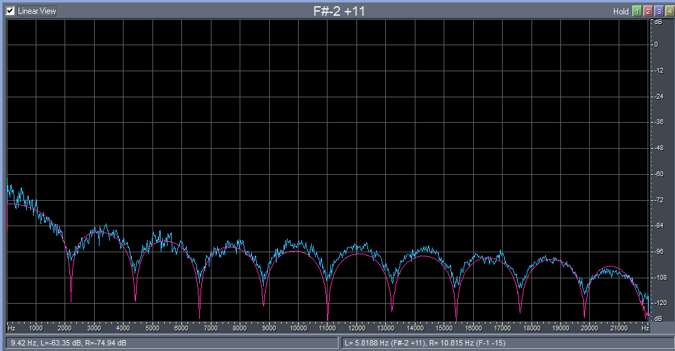

An example of a very crude crossover design, it seems. When polarity doesn't matter then the drivers are about 90 degrees apart, and +90 or -90 gives the same result, except for total phase. The polarity with the smaller total phase is the more correct one (more compact impulse response).What's so strange is that there is almost no difference in measured frequency response when I invert the tweeter in the B652-AIR speakers I got. Just a change in absolute phase.
The hump at 3.5k seems to be my microphone. 3rd image is the difference
Actually, a two-way like this should have a Linkwitz-Riley crossover that has the drivers in phase everywhere (not only at the XO). This gives a deep and narrow notch when one driver is inverted. Also, the main lobe is normal to the baffle, not tilted as it is now.
I severly doubt the woofer on those can accurately play much past 800hz.
That box should probably be stuffed tightly, but instead it is lightly.
