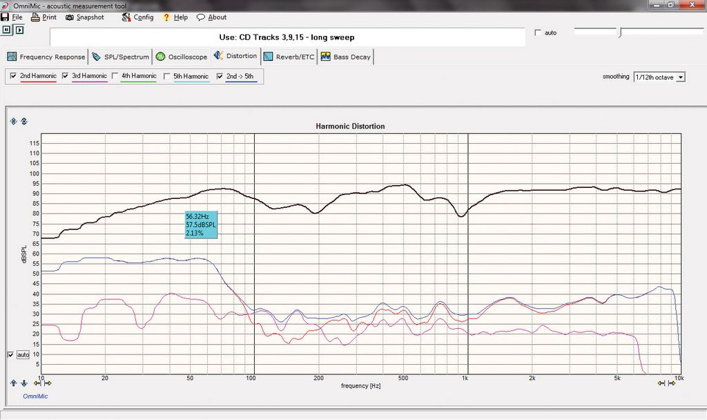

So. here is some useful data for you to think about.... The 1/2 inch diameter mic made under the Dayton and other names has harmonics in the 0.1 - 0.25% range at 90db SPL.
0.1% at 500Hz region.
This is marginal, but price is right, so I think we could use them for most things related to dynamic speaker/driver design and mods.
Thx-RNMarsh
[Dayton OmniMic, EMM6, ECM-8000, MiniDSP, etc]
Thx-RNMarsh

The electrets seem to be fine for this ??
See # 12665 above.
If the dynamic driver mods leave us with <0.1% then we have to go to the more expensive mic's.
But then, if it is <0.1% maybe we dont care below that?
Anyway, one of those electret's is what i will be using for now.
-RNM

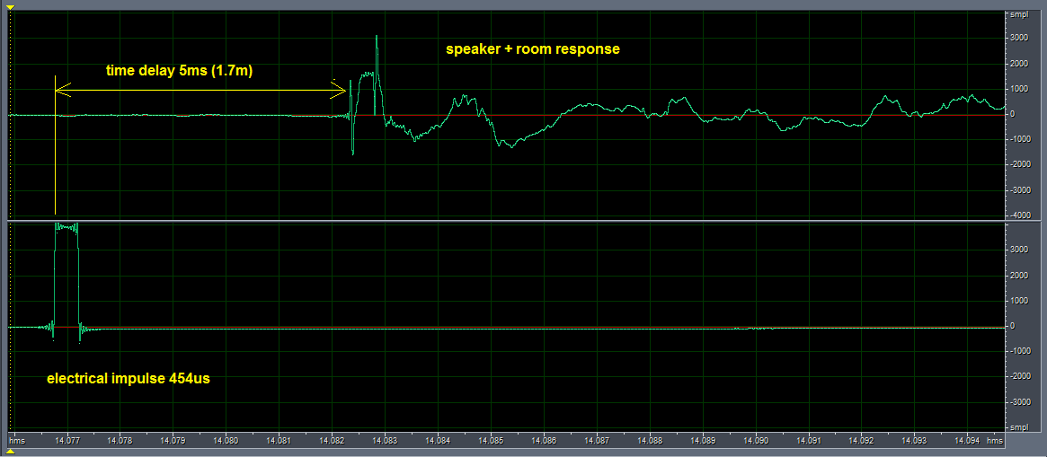

Speaker time response
I hope this is something that John C might like to see 😉. It is a 2-way speaker response to a 454us wide rectangular impulse. Bottom trace is the el. impulse, top trace is the speaker&room response. Time delay about 5ms is the time needed for sound to travel from the speaker to the microphone.
