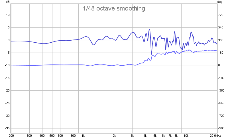

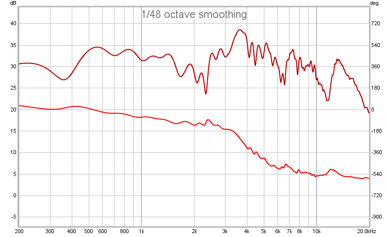

What's so strange is that there is almost no difference in measured frequency response when I invert the tweeter in the B652-AIR speakers I got. Just a change in absolute phase.
The hump at 3.5k seems to be my microphone. 3rd image is the difference
