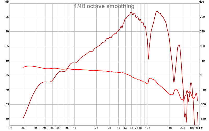

Well the window is 0.5ms, the waterfall chart is 3ms long with 6 windows. The previous FR measurements are without a window so they do include room reflections.
When using the sparker as a calibration source, the 11kHz null in the calibration curve is very deep and doesn't result in sensible output, so I stayed with the compressed air method.
Could you clarify what this is? I found the spark technique to match a lab calibration to ~1dB but it needs some care and slight correction. After reading about it on the Earthworks site the actual literature was not that easy to find. If the energy of the spark is too low the high end rolls off as a first order Bessel function too soon and there can be a null.

Figure 2b in the second one is what I was talking about. You can get this response (first null >20kHz) with a BBQ grill starter from Home Depot. The literature was sparser 12yr. ago but someone found a thesis from MIT with the derivation of the N wave for me.

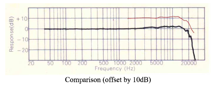

The black line is a B&K chart that came with a calibrated electret capsule that Nakamichi sold in the late 70's. The red line is what I measured.
I'm using one of these:
Amazon.com: Camco 57533 Olympian GM12 RV Multi Sparker: Automotive
With a weak battery so the sparks don't repeat too fast. With a stronger battery the null doesn't move up noticeably, but I suspect the risetime of the HV supply isn't enough to increase the spark energy. Maybe I should try and increase the capacitance?
Attached is the response of the spark recording.

I tried the taser. Unfortunately the HV supply squeal is too low frequency and interferes with the measurement. Also I think the static pulse from the taser is causing a LF step in the recording. The taser spark might actually have lower energy than the sparker pulse, the null is at a lower frequency.
Thanks I see now, the grill starter (manual, one of those push button clickers) that I got had that first null at 25K or so which was fine for me. I had to make sure I windowed out the button.
