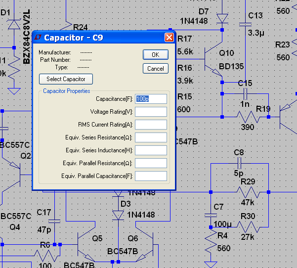

does it have accurate polar and bipolar models? leakage and DA and esl and dielectric DF, esr, TC C change with freq/voltage etc etc etc? if so thats cool.
-RNM
Just fill in, or ask the one who works for you on circuit design in spice to do it.

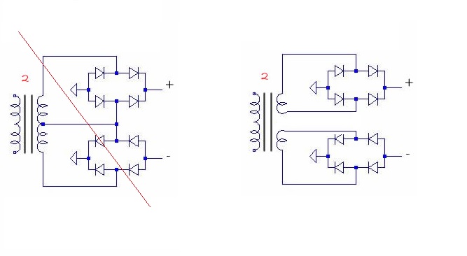

There is an error in dual bridge drawing (secondary is shorted through diodes)
Oh, yes, dimitry, you are right (as always) and I'm shamed.
A copy/paste stupid mistake. That explain this smell and smoke in my LTSPICE. I think I have to change the model of my diodes in it, the ones I used are probably exploded. ;-)
[edit]They are still alive: i did not powered the schematic, pushing the "run" button ;-)
