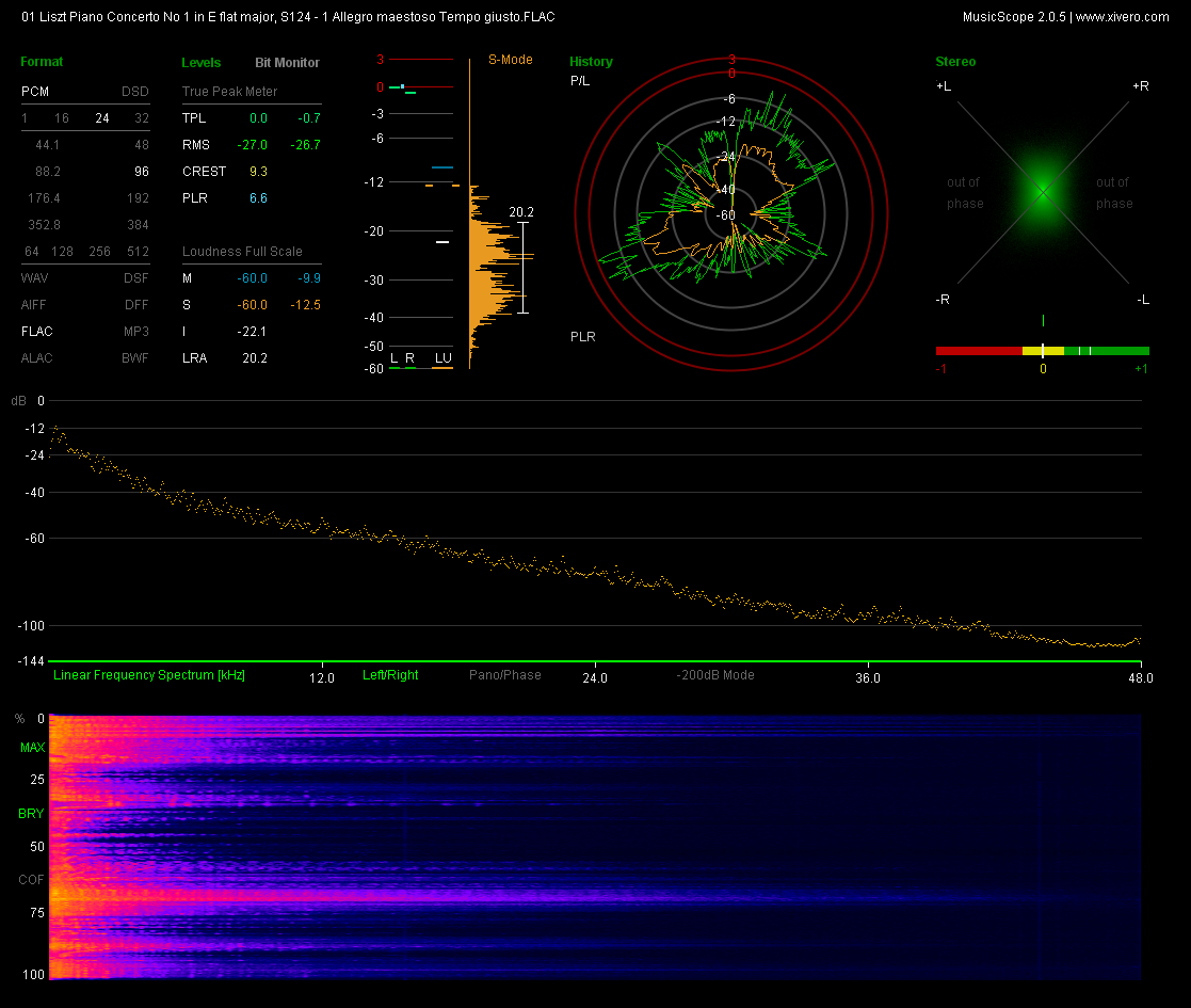

A record I dare recommend for the dynamics is the Grieg & Liszt Piano Concertos by S. Hough (Bergen Philharmonic, A. Litton) on Hyperion.
The polar diagram in the MusicScope analysis report of the 1st Movt. of the Liszt shows a dynamic range of some 50dB (difference between the lowest RMS value (orange) and the highest peak value (green), the angle being the time axis). I've got it in a HD version, downloadable from the Hyperion web site; a CD version is also available.

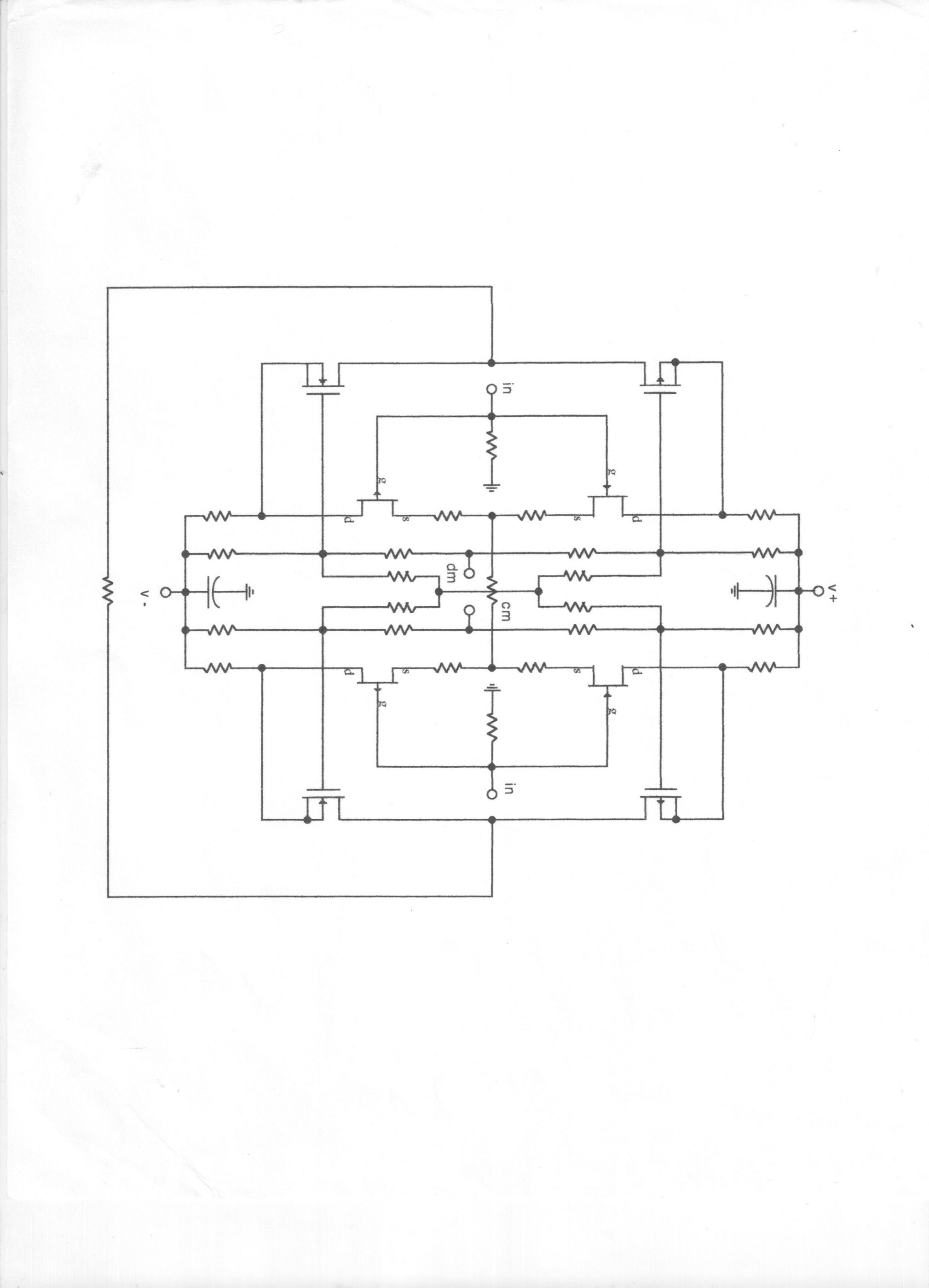

It has been about 12 years since I was first asked for this 'schematic' that started this thread. Of course the reason for all this has been lost in time and squabble. '-) But here it is. I have left out the servos and the power supply buffers, do your own thing! (PS, I stole the original circuit from Charles Hansen so blame him, not me.)
