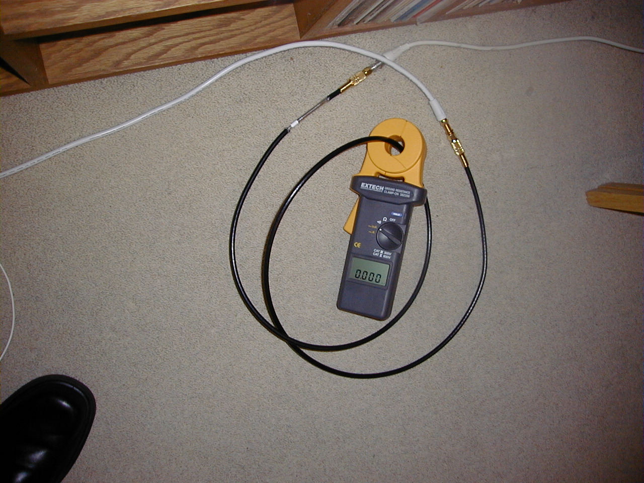

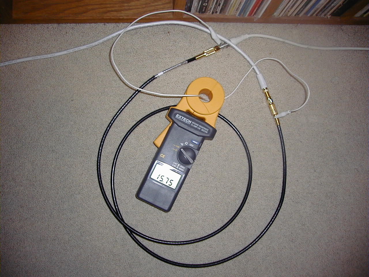

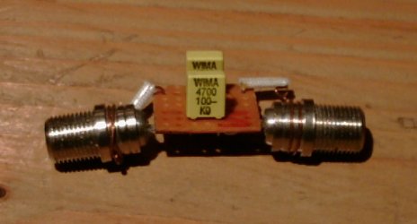

Uh huh. I have about the smartest TV on the planet. The latest and greatest, as they would say. Somewhere that Netflix signal gets into your home... commonly via a coax (some lucky ones might be F.O.) via your cable provider.
That cable system is connected to earth ground and not necessarily to the same earth ground as power. New laws require it but if your home is not made recently, chances are the cable signal for internet is grounded where ever the cable enters the home. And not at the power utility box.
Thus, when two systems are connected together. a ground current loop is created.
Not that there are not solutions, because there are but maybe we should talk about it.
here we see the resulting current flow of two separate grounds.... between CATV cable grounding and utility power ground (wall outlet)
from being physically grounded outside the house at two different earth ground locations.
The solution was to cap couple the shield for RF only to pass.
THx-RNMarsh

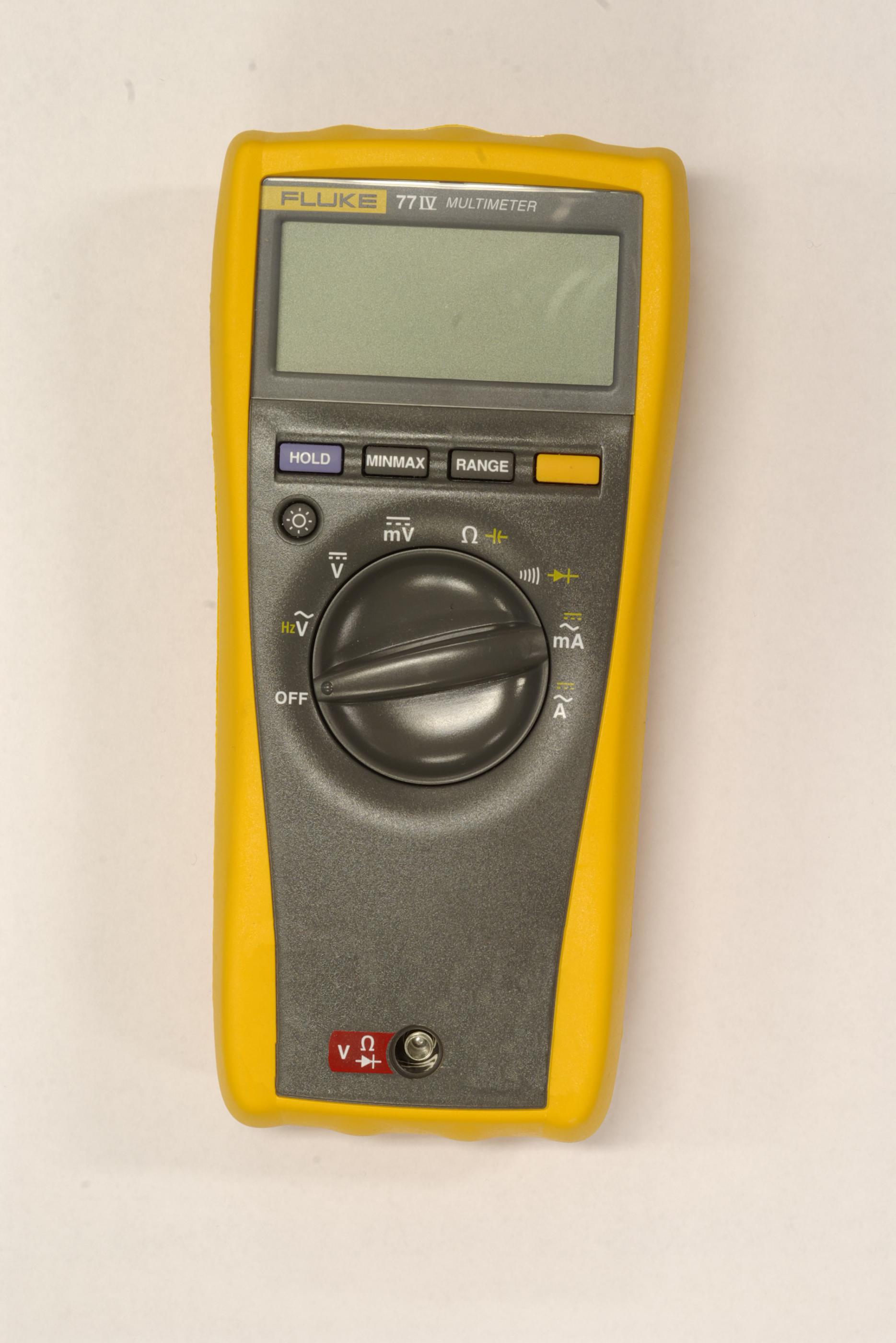

Could-you indicate how, in your infinite goodness ?
Probably not. These things often become clearer after long years of experience with issues, falling on your face and finding working solutions. As they say, if you have to ask the question, you probably will not understand the answer :)
Edit: your multimeter probably looks like the attached :joker:

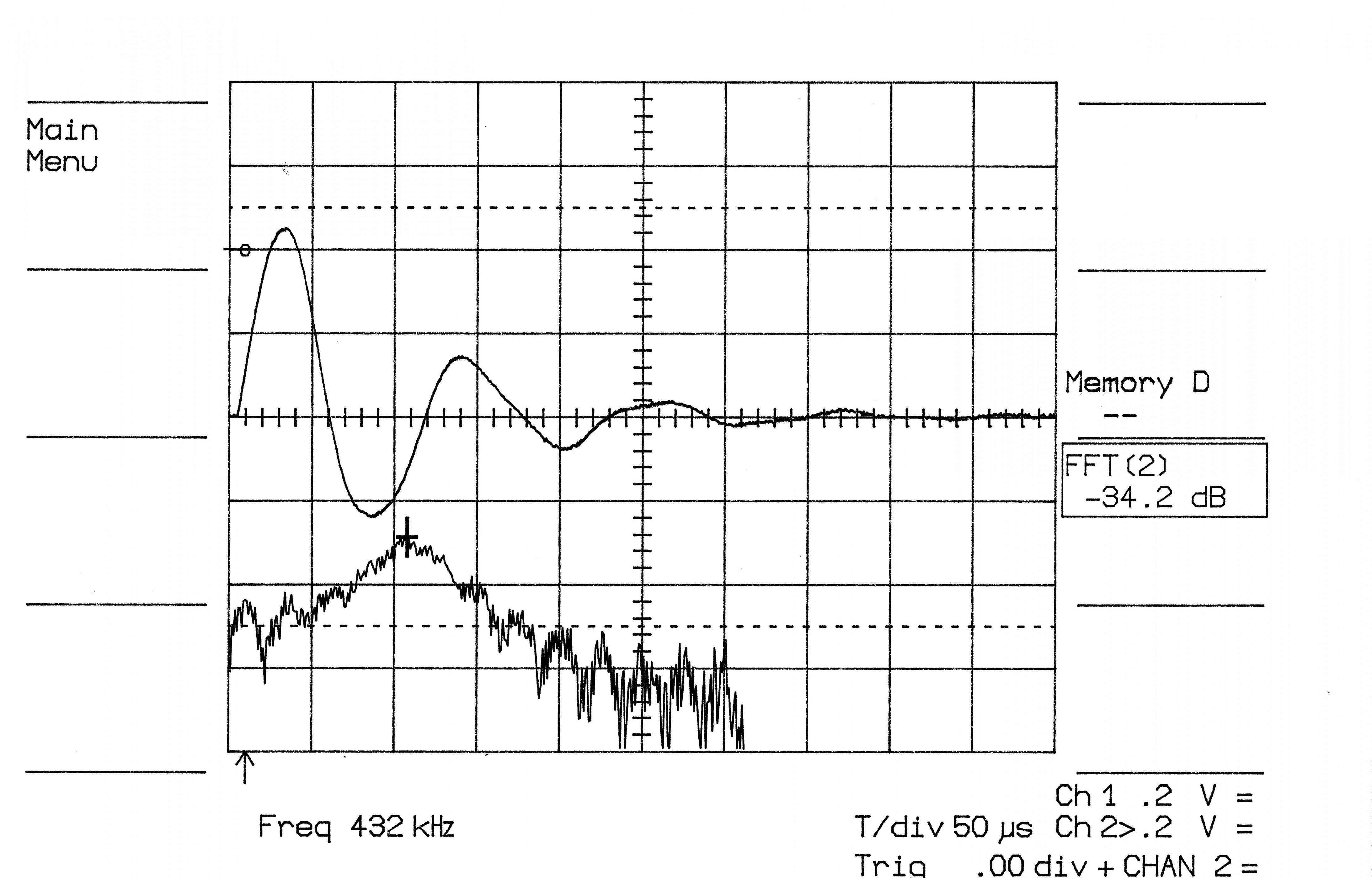

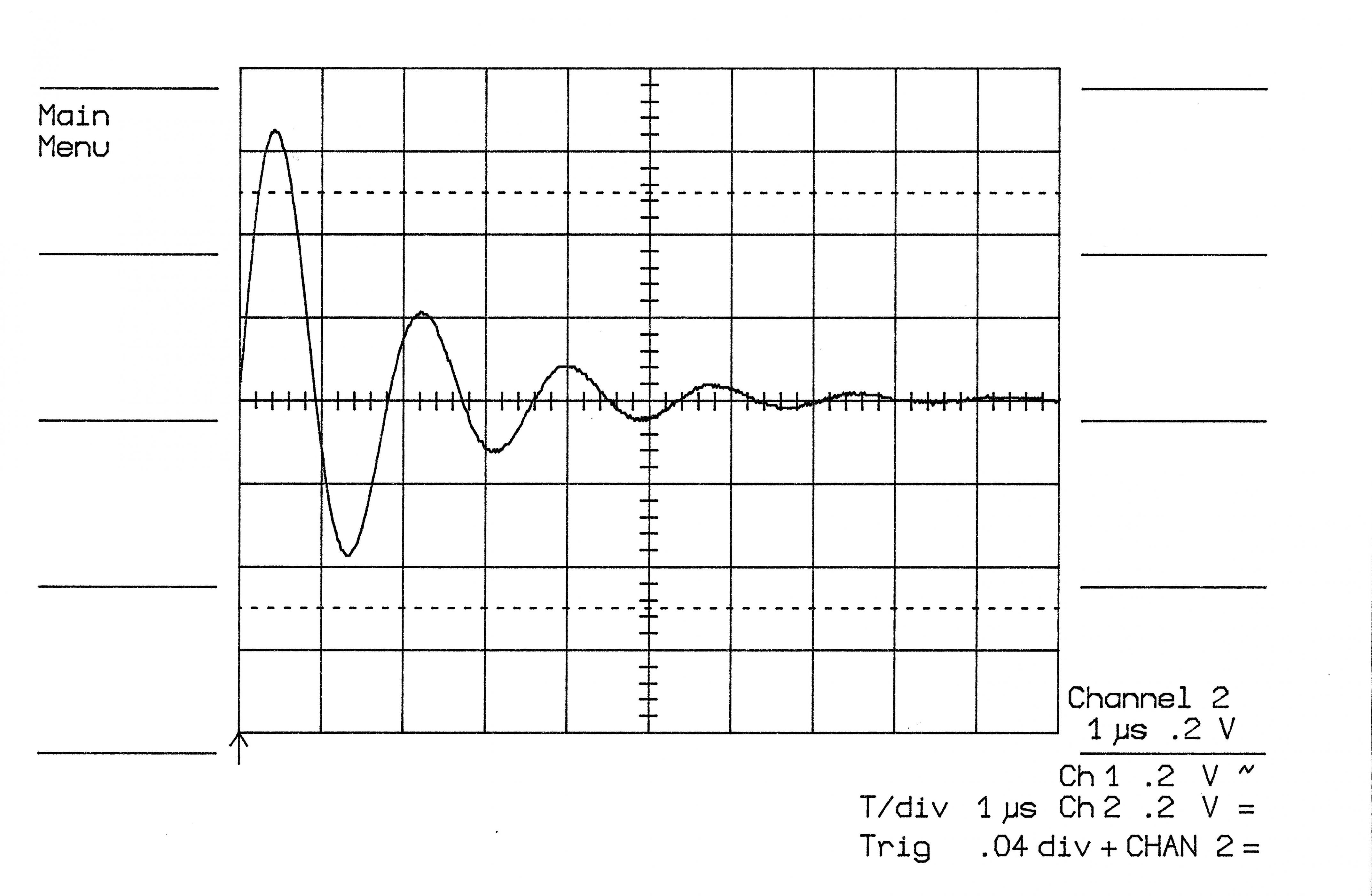

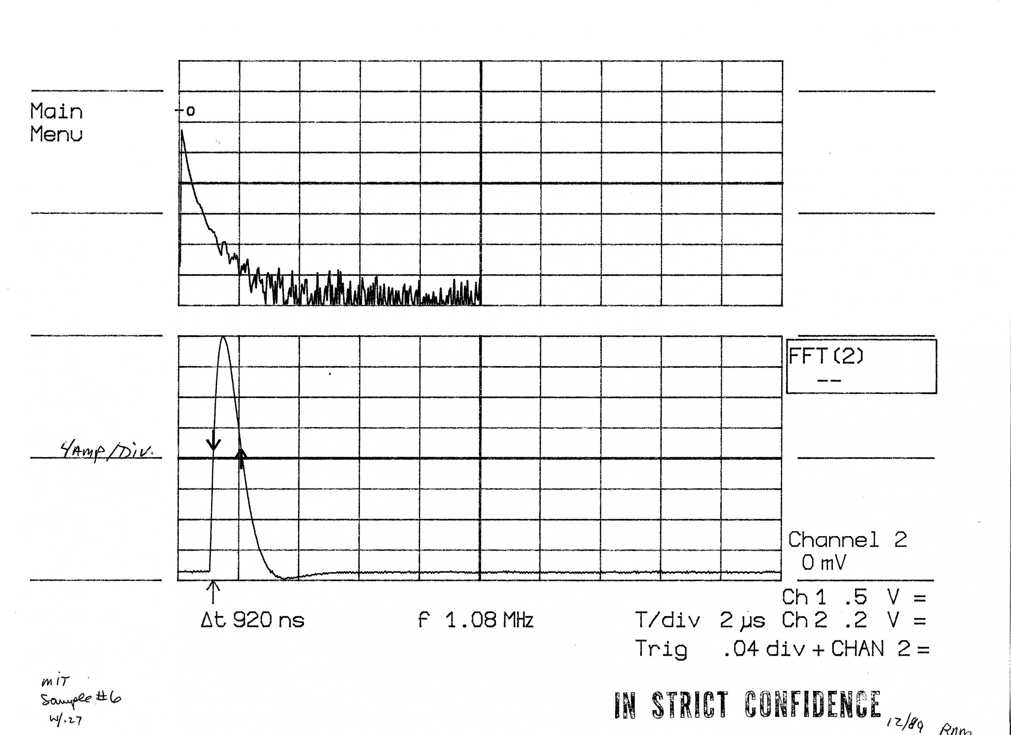

More cap stuff....
These are plots from around 1989 and 1990. I was developing an ultra fast cap, high current cap as I was working around high speed cap discharge banks. Wasnt intended for audio, BUT ...
They are current plots from discharging a PP film & foil cap charged to DC 5v into itself. The scale is 4A/div. 1.0 ufd/600v (1/24/1990)
Note the nice damped sine wave decay. The freq of ringing and rate of decay I used to collaborate the Fr of the cap and the peak current related to total esr.
Here we have a film cap also (same C value and voltage rating) ..... The waveform isnt a clean sine wave.
Notes on back of plot say --- FFT of distortion products, rectangular window. power spectrum.
and same as first cap except it is criticslly damped. 4A/div etc

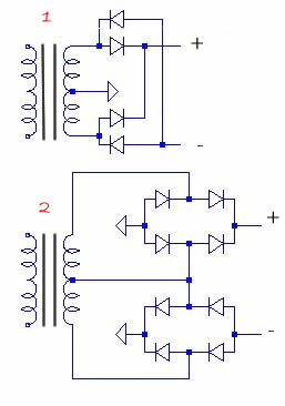

As to your grounding problem: have you successfully broken it and now need to find a less intrusive way to do so or are you stuck on the first part?

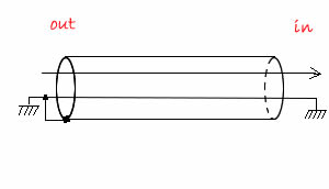

Broken ? Not totally. The first improvement i found (long time ago) was to bridge the rectifiers on my amps from 1 to 2 (see attached 1). After this, did what i exlained. But it is not intellectually totally satisfying.
gpapag, thanks a lot. I will analyse-it. As habit, bcarso has clever ideas and is a master about HF and interconnections.
I'm tempted to try wrapping mains cord around the interconnects just to see how well it works, never heard of it.
i dont think you understood the issue.
May-I try to explain ?
It is not electro-magnetic coupling between the AC lines and the signal ones. Good shielding and a good way (see attachment2) to connect the signal lines take care of this. I found CAT6 cables very good and cheap enough.
There is leakeage in the transformers, between primary and ground (secondary). By the capacitances between primary and secondary coils.
As no transformer between different devices are exactly the same, this leakage differ both on phase and amplitude, depending on the frequencies. This create voltages between grounds, and those voltages, despite the high frequencies, create a current. This brings to the input parasitic HF components (AC is full of shi...)
You dont hear-it during silences, like hum or buzz, with a good system, but it create IM dynamically with the signal.more or less, depending of the amp's bandwidths. It is subtil, but audible: less transparency, less separation between instruments.
Free to you to make your own measurements. The first one is to measure the voltage, between the two grounds, and watch it with an oscillo once your two devices are AV powered, before to connect the signal between them.
Hoping this will help somebody.
