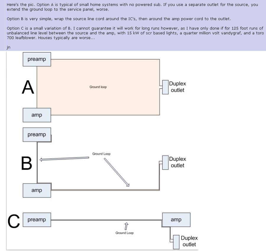

The question was about how to totally isolate each element of a system to avoid any parasitic leakages (ground loops).Bought an Teac UD503 USB dac (it has an isolated USB input) 🙂
I have CD, DAT, minidisk, Revox, Nakamichi, PC, Preamp, active crossover and filter with DAC, amps.
Jan Didden pretend it is easy. But he did not propose any solution.
What I have done:
1- Switch the grounds of the analog Equipements in my preamp, in the same time than the signal inputs.
2- Chose the AC sens of each power plug to minimize the phenomena.
3- Use digital optical connexions when it is possible.
What i will do:
1- Replace the PC with an other digital source.
2 Replace the big linear power supplies of my amps with switching ones.
But, as i have limited financial ressources ...
May-be i will consider to modify each analog gear to be totally symmetrical.
But 600/600 transformers has their own flaws and are expensive, and active is not so efficient. I tried SSM2142 etc, but was not fully satisfied with the way they sound.
PS: I am not interested in comments that says the problem does not exist. Or that i have HF oscillation problems in my amps

As to your grounding problem: have you successfully broken it and now need to find a less intrusive way to do so or are you stuck on the first part?
Tryphon
I suggest you try the radical approach that jneutron kindly shared. It works
George

Ground loops are a fact of life when dealing with Class I equipment. I would just avoid using unbalanced I/O.
Nowadays, ground loops are not an issue for most normal consumers as they are using HDMI sources into their AV receivers (mostly Class II anyway), which drive their speakers.
I'm tempted to try wrapping mains cord around the interconnects just to see how well it works, never heard of it.
Most? Are we forgetting how many now also stream off the internet? Another grounded system.
-RM
