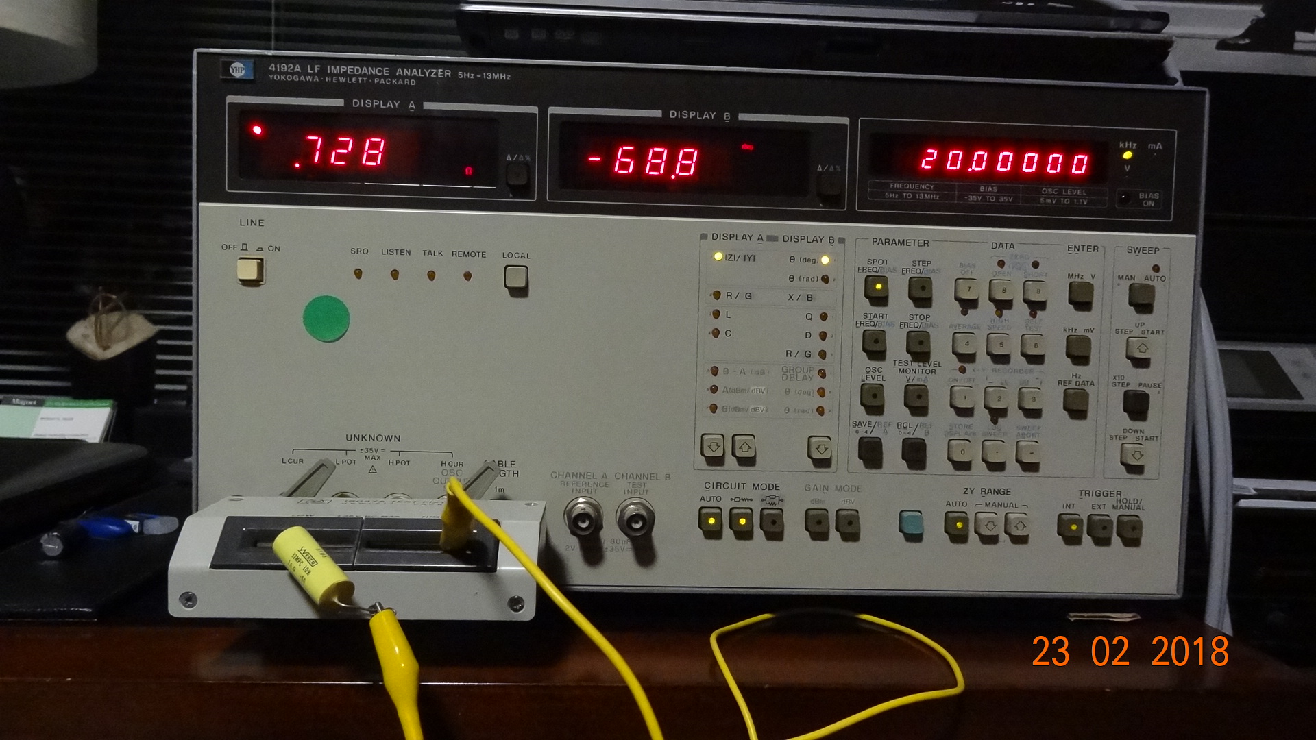

Here is an example of ignoring parasitics in a speaker cross-over design -->
take that nice 90 degree from a film, i showed you. Add 18 inches of wire in series with it. Not much L or R, but here is same cap with 18 inches of wire added:
Double the length and you are at 70 degrees/5KHz. A bi-polar would be a lot worse to begin with.
Anyone here using wire from driver to cross-over that length or longer? And what does it look like with a length of speaker cable added?
Any wonder when in-play the perfect cross-over doesnt always add or subtract like you wanted it to be in CAD or even on the test bench? So you start tweeking and fudging values to get it to sound/measure better? Small details again.
measure your passive cross-over from PA output and at the driver terminal through the cable and wires. And, yes the load Z matter and affects this result or high z or low z but also larger C values etc. cant be exact without specifics.
Similar if you measure at the pcb or at the power supply when the HF bypass is located some distance from the circuit thru power wires/harness. How many times do we see bypass on the big filter caps and then wire off from there to the circuitry. The bypass needs to be at the PCB/circuit if you want low HF Z to common.
