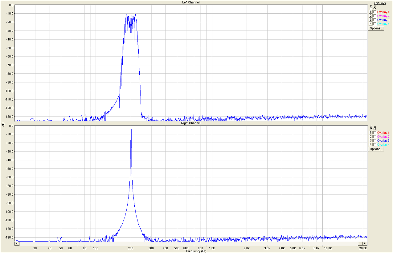

Anyone listening to this would say the 2Hz modulation is obvious but of course there is no 2Hz component to the sound.
This signal will not have any low frequency components unless is passes through a non-linear process
but the 2Hz is an audible impression almost as much as with AM. One point might be that it is very easy to fool yourself into thinking something is there when it isn't. See for instance Diana Deutsch's AES presentations.
Since it is audible, one can conclude that another point may be that the non linear process that this signal has to pass through (in order to become audible) is our ears or the processing of the acoustic signal by our brain, no?

It was just CoolEdit.
Dropbox - vibe.wav
I used a 10 sec .wav and 441000 FFT to avoid any ambiguity. I can't go back to tools that only do power of 2 FFT's too much fiddling with details.
George
Maybe it is much more simple, our ears + brains just evaluate the rate of change of base signal frequency in the left channel.
