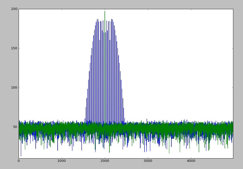

It's been quiet on this issue but since I'm back home from holiday with all my toys, so here is another input. This is the spectrum of a 200Hz tone FM modulated at 2Hz with a peak deviation of 20Hz.
Anyone listening to this would say the 2Hz modulation is obvious but of course there is no 2Hz component to the sound.
The scale is relative dB with arbitrary reference and the green plot is just 200Hz without modulation as a reference. The frequency scale is 0.1Hz per bin so divide by 10.
This signal will not have any low frequency components unless is passes through a non-linear process, the DA model with a ladder of ideal R's and C's does not qualify. Therefore filtering this signal at 20Hz has no effect on the envelope whatsoever.

Scott, would you mind posting the wav? Or, I can generate the FM tone myself based on your definition. I was playing with FM test tones about 15 years ago (generated by CoolEdit). For a reasonably linear amplifier, they had shown nothing. I would go even farther and declare that the real music is the easiest test signal for the amp that we can imagine. Just opposite to popular beliefs.
It was just CoolEdit.
Dropbox - vibe.wav
I used a 10 sec .wav and 441000 FFT to avoid any ambiguity. I can't go back to tools that only do power of 2 FFT's too much fiddling with details.

Did you mean to say FM modulated?
Howie
Howie
Yes, 20Hz peak at a 2Hz rate. The level is flat i.e. there is no envelope but the 2Hz is an audible impression almost as much as with AM. One point might be that it is very easy to fool yourself into thinking something is there when it isn't. See for instance Diana Deutsch's AES presentations.
