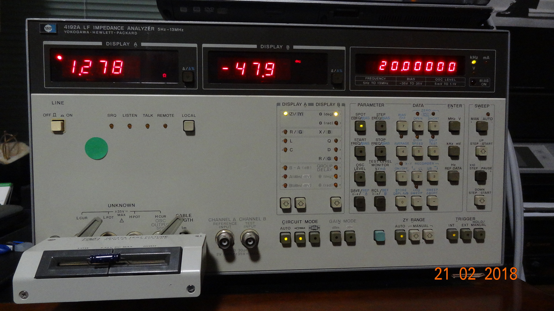

90 degrees at 150Khz

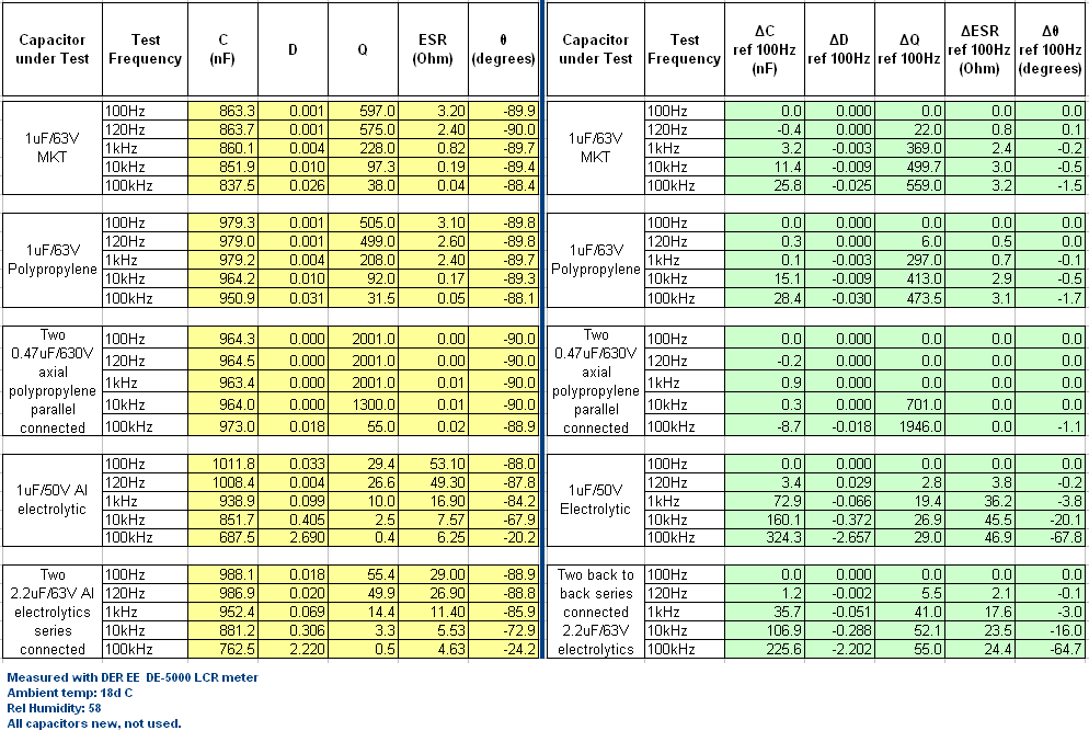

Some measurement data.
I think another good point is the leakage current.

you show the same relative change between polar and film. Much worse degraded with polar. However, the values you choose -- 1 ufd -- is hardly the common value for coupling or fb cap. Much higher C are used and thus higher esr etc and worse phase. try a 100 or 1000 ufd cap range. Something likely to be used and heard, as I did.
Of course, then you have a problem comparing same value with type. But, still, I only use polar values that are typically used and listened to.
But, you show the trend.
Interesting though are the back-to-back polars. typically they have lower thd (lower volt drop across each) but the esr is in series so there was no improvement with phase.
THx-RNMarsh

leakage current for an electrolytic cap is 5-20 uA per ufd -- new and at room temp.

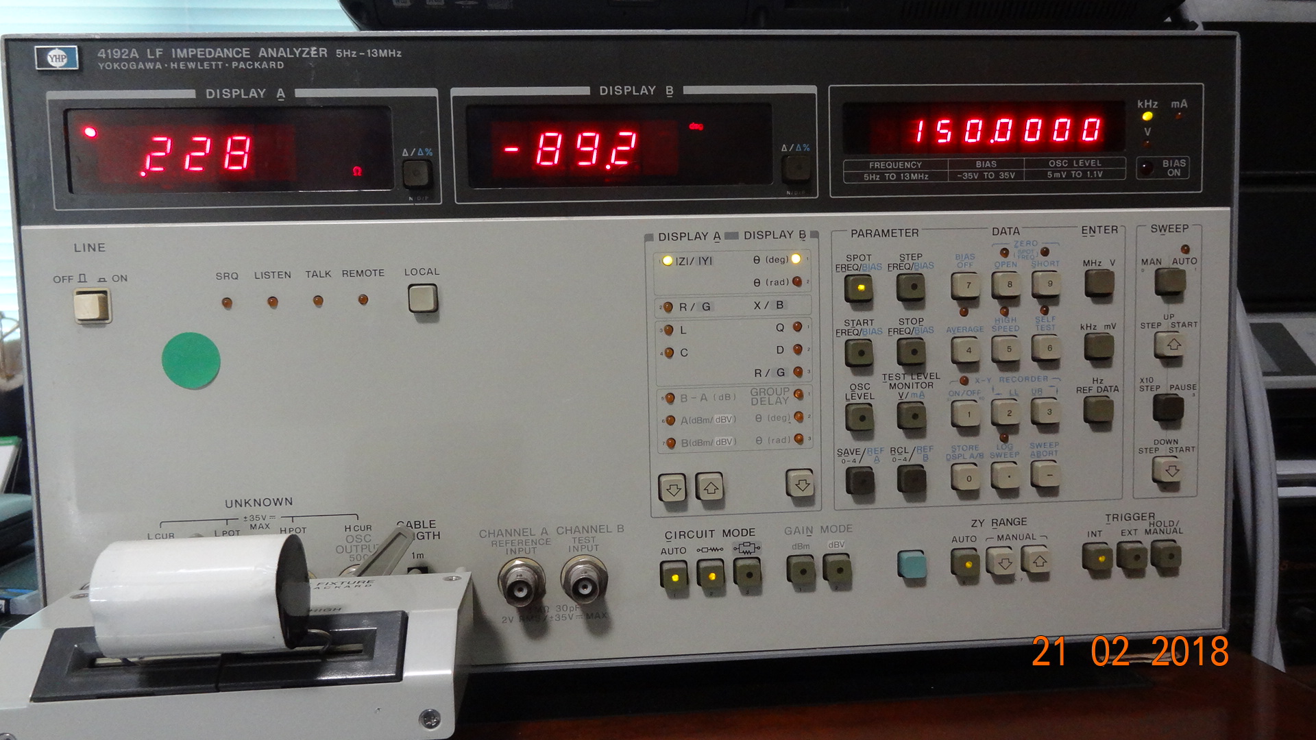

This is what a good film does to phase.
It is my patented design built by Rel-Cap. PPFX
REL-Invested $50K USD to have a custom cap making machine to do it.
It is only company who can make it. Co-patented by Bas Lim - owner of REl-Cap. I figured out what to do and how and Bas figured out how to make the machine work to make it to my design.
Its self resonance is much higher than typical PP caps. The esl and esr are lower. Up to 1/10th lower.
It is the esr + esl which causes the change in phase.
The cap you use in fb to ground, should be like this; Using PP film. But, its going to be huge for large values.

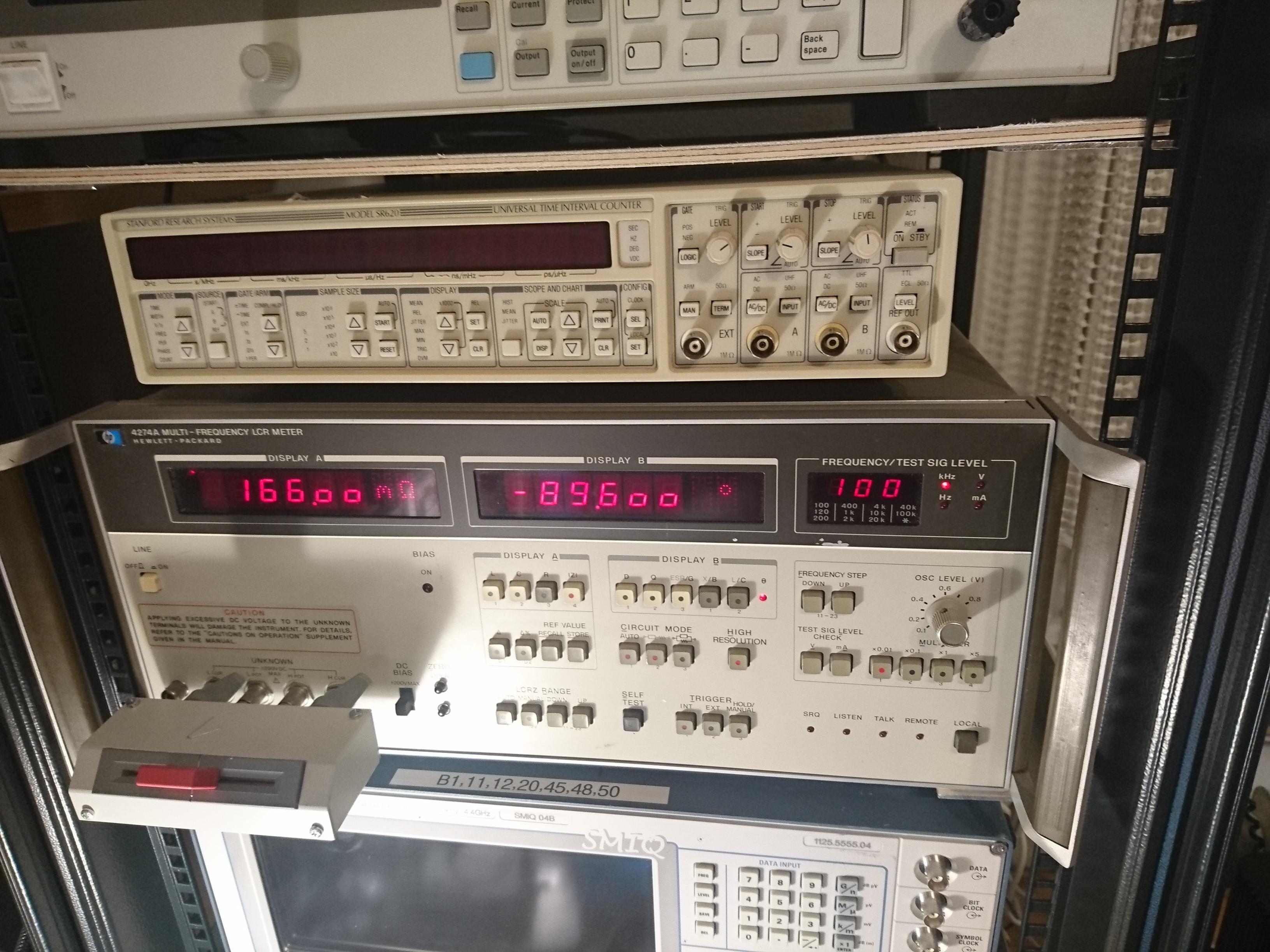

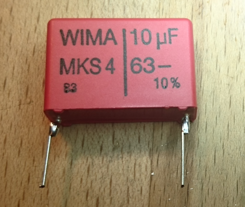

This here is a WIMA MKS4 10u 63V. I have a bag full of them, about a pound.
The Wima 10u 16V in 11 * 7 * 15.7mm is about 1.5° worse.
Sorry you got that impression ?? ... I also said elsewhere any PP is almost as good. The large cap I used is 400vdc rated, film and foil. . I didnt show the brand name printed on it so as to not promote it.
WIMA is fine also. PP made by anyone is preferred for audio over polar types. PP is way way better than electrolytic is the point I made in comparison. Using my cap as example.... for a film-foil... not metalized... its self resonance is very high making the design useful to a higher freq. and very stable at high current. Nice for speaker cross-over, maybe.
To be clear -- the patent long ago expired (15 yrs?) and I do not get a penny for any sold. That cap I used from my spare parts bin is about twenty years old. They might still be made and sold because there is demand but I dont have the machine so I cant make them and have to buy them like everyone else. But, then i dont use them -- i go to dc-servo.

MKS4 is metalized Polyester.
Then it will be smaller than PP. Other parameters are better if you use PP.
