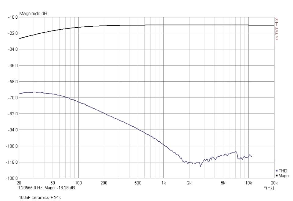

Well, yes, with some objection. In case of heavily nonlinear ceramics I would rather say that the Z is to be almost negligible compared to load resistance. Please check my measurement of nonlinear 100nF ceramic capacitor loaded with 24k resistor. Both amplitude response and THD plot are shown. Please see that distortion starts to be negligible more than one order above F(-3dB) frequency, though amplitude response seemed to be perfectly flat.
