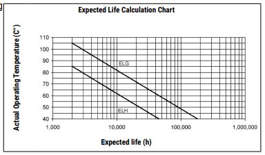

"1000 -5000 hours operating time, on the shelf: 1000"
-> 41 - 200 days ;-(
this is at 105 deg C!
life of a capacitor doubles for every 10 degree Celsius decrease in temperature (within limits)
He is a "Knight of Orthodoxy."Well deserved as the knight of sanity and knowledge.
And it's guaranteed life span, they fail after it, but when is unknown.
If it was only a few thousand hours that would be a major problem for longevity of any electronics.

I know, and I had seen the graphic (see attached)this is at 105 deg C!
What surprised me was: "On the shelf: 1000 Hours."
On the shelf at 105° ?
Not a good place to keep your chocolate bar.
As I said earlier.... life is where they will not meet the published specs any more. take the spec and double it and you have the "life" of the cap. ---> where leakage doubles, esr doubles, DF etc etc.
Or, the C is 1/2 etc etc.
Doesnt mean it out right fails.... just degraded to a point and how long it takes to get to that point. It continues to degrade after that.
105C do a lot better ... slower to degrade to same %age.
THx-RNMarsh
