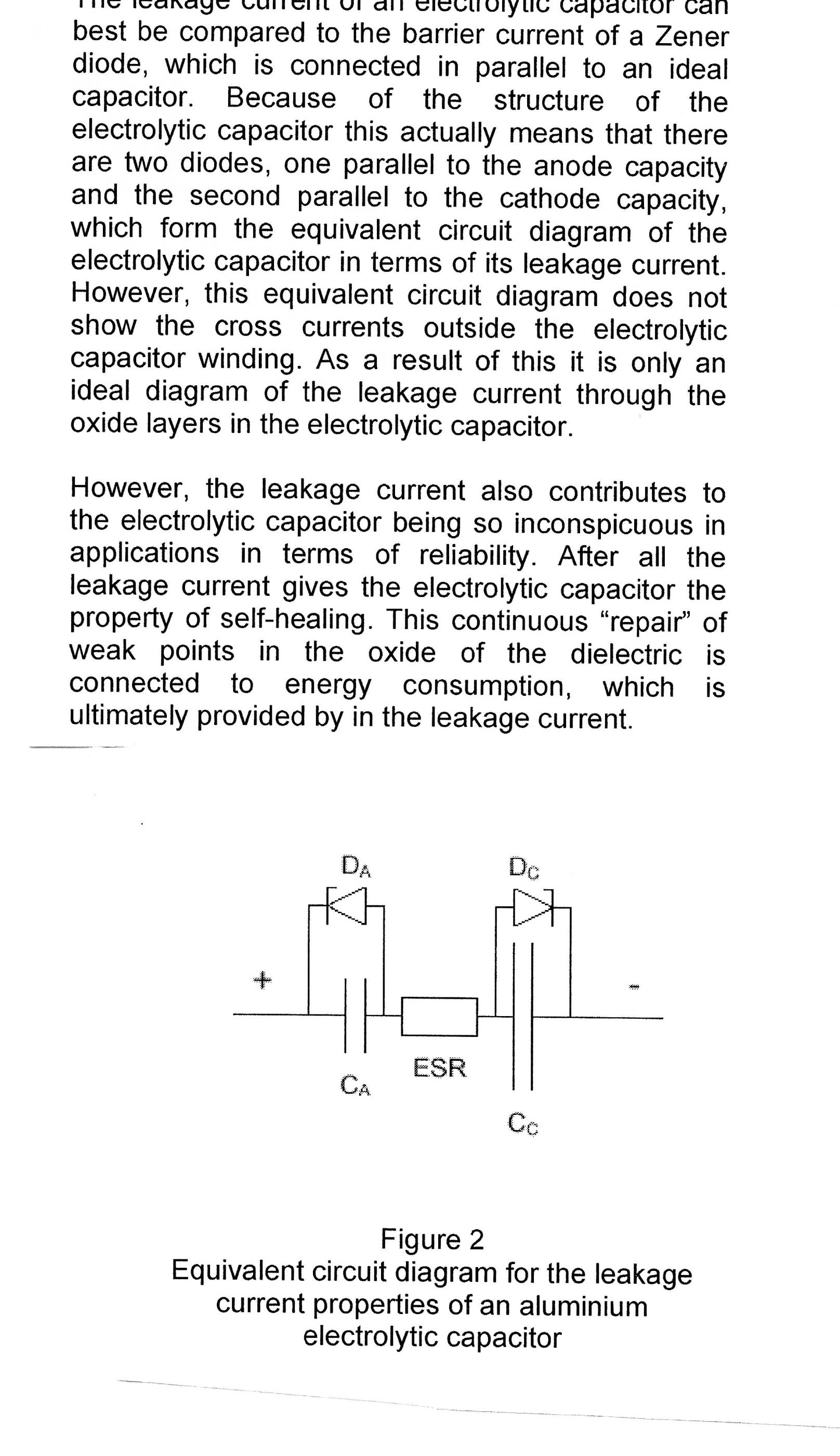

I don't know what this straw man argument is regarding THD and polar caps is about. Walt and I showed in 1980 Audio article the distortion increase when voltage is across the cap. And how it goes down when lower voltage is across the cap. So, others more recently did same tests and find same results.
What is the big deal?
Of course there are many places where a volt drop is part of the necessary function and design. Filters.
We also showed the affect of zero vs DC bias on polar cap distortion.
many tests of polar caps do not appreciate the effect of the diode effect in those tests. Most models of electro do not show the poor quality diode of the polar cap but it is responsible for distortion if the signal applied to a non-biased polar capacitor. namely, 2H.
if your tests are below the diode threshold, you wont see much 2H but if a signal peak exceeds that diode volt, you get 2H. Depending on volt rating of the cap, the diode volt can easily be exceeded with zero vdc on cap. So a test must consider the test ac voltage level. Some test levels have been just under the diode turn-on voltage.
Here is a model you could use for sim.

In 1980, most music sources were still from LP. Many amps/pre-amps at that time used the coupling cap to roll-off low freq artifacts (HPF) so rumble, flutter, wow et al would be attenuated.
Today with the new standard of DAC sources, Almost all CDPs/DACs analog outputs have signal strengths of 2- 2.3 volts. Peak levels can more easily cause distortion with unbiased polar/electrolytic coupling caps.

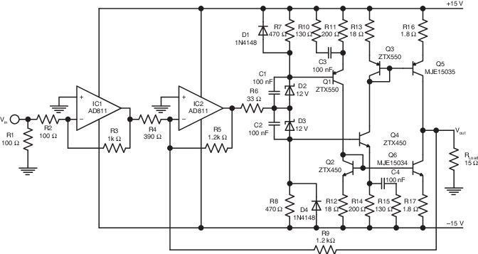

I tracked down the article of the schematic you posted and as I suspected it is a video/RF amplifier and I am trying to understand its use in our application(audio). The author says that to maintain stability you have to limit the gain and I suspect the amp is only stable into a specific load and not a real world speaker.

Try it. Learn the characteristics of a CMA. Thats the reason for posting a CMA design. With 811 it is quick to DIY and easy to build/test.
Most are not stable at gain = 1 unless specifically made to be. You will get sever peaking at top of BW limit if you tried. Yes, the gain setting R's are critical to proper operation of CMA. Its isnt so willy-nilly values as in VFA.
It will need some tweeking as i said for my app. But, you could learn a lot about CMA circuits if you actually built a CMA.

I have Richard, a variation of the circuit I posted.
Issues you usually have to add a buffer (which increases the complexity) and usually an additional gain and then add compensation to get the whole mess to work in harmony, no elegance here. I still don't see the need for DC to light bandwidth, could you explain that one to me.
Problem is, it might measure good but they sound flat and lifeless once you have it working (probably due to all that complexity).
Maybe Richard you should post a working circuit, that you think qualifies, that we could build and test.😉
