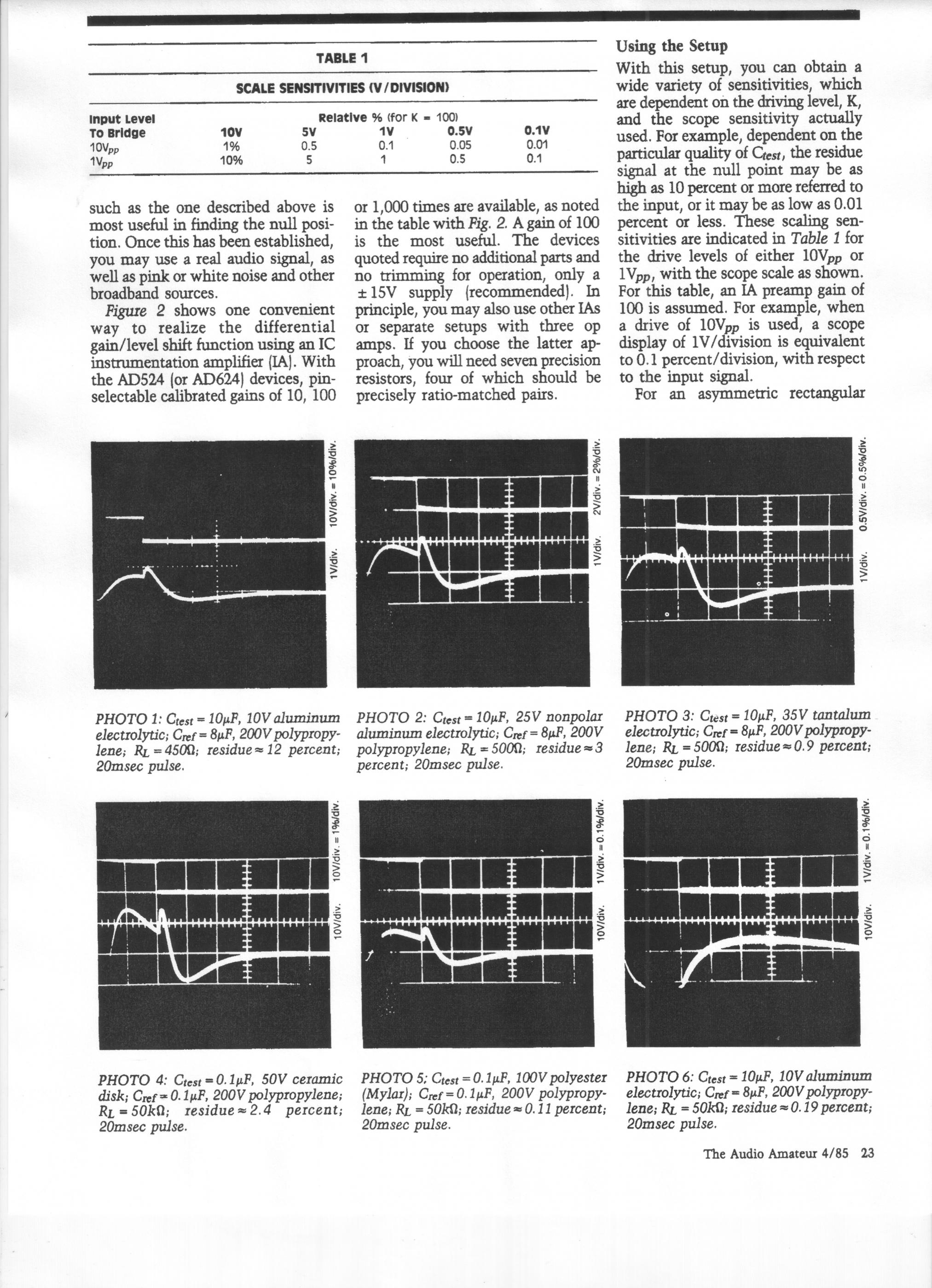

I would like to go on a little more about caps. First of all DA, and harmonic (or IM)distortion are SEPARATE problems, and have to be measured differently. Ignore DA if you want, and live in ignorance. No matter what we try, there is no IDEAL cap for audio. Some caps can be fairly neutral, like REL-CAP's, some can add a pleasant change, like some of the very expensive, oil filled caps. Others can add a small change with the best, and a really edgy change for the worst. Before some of us actually evaluated caps more thoroughly for audio performance, we thought much like most here today, but after evaluating and measuring hundreds of different caps, you really find that they can be a problem, usually. For the record, many independent manufacturers and modifiers have found REL-CAP's to sound just about the best. They are not the most attractive, or the most expensive, but they are well engineered, and that seems to make a difference. I use REL-CAP's, have for 40 years now, I use them with the best Parasound, Constellation, the CTC Blowtorch, and the Vendetta Research SCP-2, and just about anything I get my hands on. I am not alone, as PS audio is using REL in their RIAA networks, just like I do. Yet, I hardly know those people. Why? Because they sound better? Probably.
Unfortunately, Rel is now shut down to the rest of the world, and probably even me, as Dave Wilson's company bought it and moved it to UTAH, so that they would have a continuous supply of crossover caps of sufficient quality. You can still buy some at Michael Percy's mail-order service.
Now what about DA? Back 35 years ago, I measured hundreds of different kinds of caps, virtually everything that I could get a hold of. Walt and I published a few examples in that article that we shared.
Now some here do not realize that DA does not easily go away as easily as normal non-linear distortion. Yes, it can go down with light loading, but it doesn't go easily away. Just look at Fig 1 and Fig 6 of the page I am putting up here. It is the SAME CAP with different loading, yes, 450 ohms in Fig 1, and 50,000 ohms in Fig 6,. That shows that DA is going to be present in virtually all audio music.

Scot showed a write up a few years ago where DA was modeled using IIRC an RC network in parallel with the main signal cap. If you ran a distortion plot there was no effect. If you put an assymetrical wave through the setup, you got some of the artifacts you see in the plots above.
I don’t know what the outcome of that exchange was (can’t recall) but we should resurrect it as it’s important we recycle through this stuff every few years

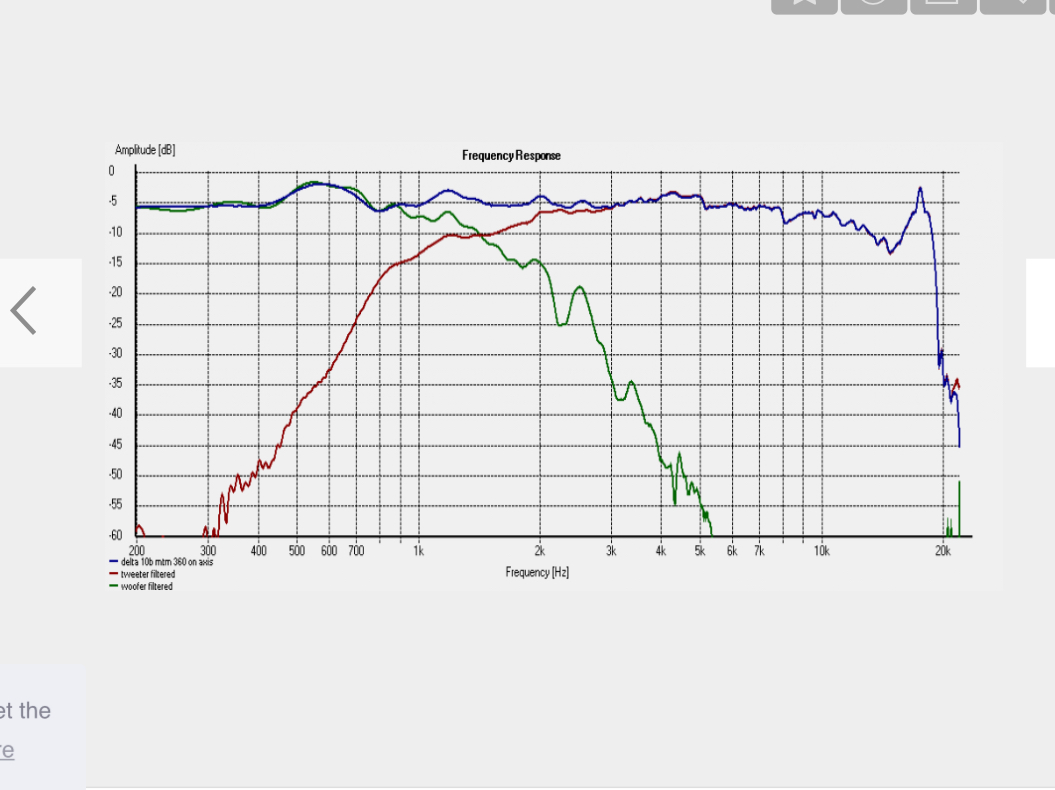

That should give you all the SPL you need!
Yes, I’m trying to figure out a better mousetrap for the dsp end of things, looking like a mini dsp shd is in the lead.
Already have a crown xls 2002 for subs, gonna run the 10” drivers with the my yammie. And the Hint has a HT bypass so I can run the tweets from that (should stay in class A for the most part!)
So except for a cap on each tweet it’ll be all active.
I didn't want to make that comment earlier but now that I see you are ordering a mini DSP: MTM's are hard and big MTM's are impossible. The problem is that the two M's will have a very narrow horizontal lobe the higher the frequency becomes. The right thing to do this is to put a 6 dB low pass filter on the top M, after the normal bandpass.
I suppose this scope was AC coupled for these measurements, also for the perfect square waves on top. What was used for AC coupling .... ? So, a square wave can survive a coupling cap. No further questions.

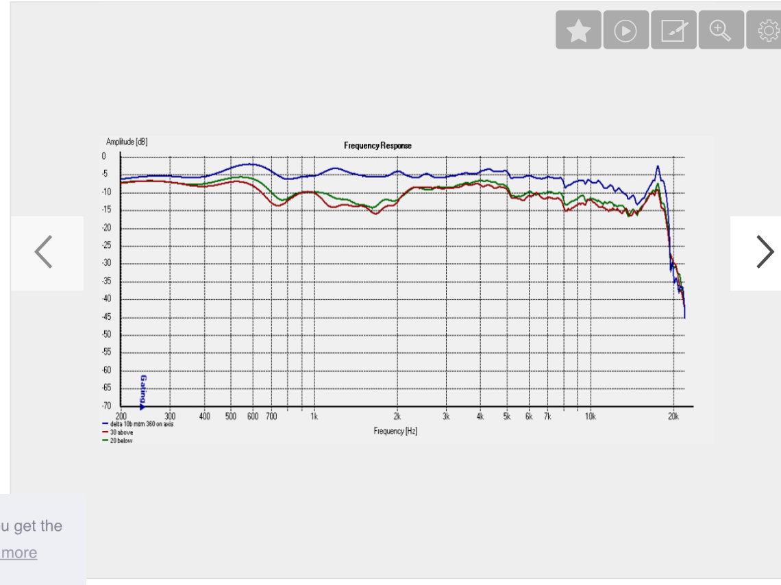

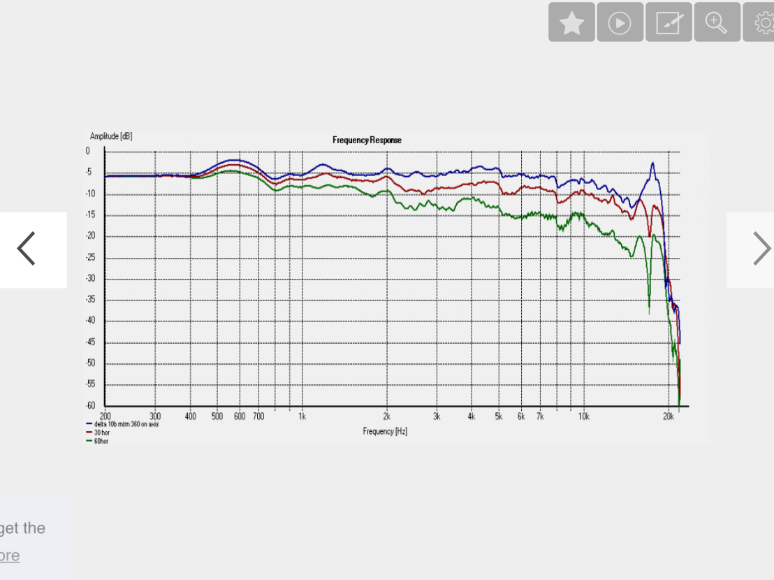

Thought is i’ll be able to listen at my normal level of 95db @ lp without anything breaking a sweat.....and then when I want to get crazy there’s still plenty of pedal left.That should give you all the SPL you need!
Thx for your input vac, the whole idea is to keep the room out of the equation as much as possible.....I bookmarked the polars but can’t find them now,they weren’t bad though. Way better horizontal than vertical.....all of my critical listening is done seated anyhow and tweeters will be just below ear level.
Low pass on the top is definately easy enough to experiment with....but judging from the critiques of those who have built them horizontal was not an issue.
We shall see I suppose, if I don’t like them I could try mmt .
