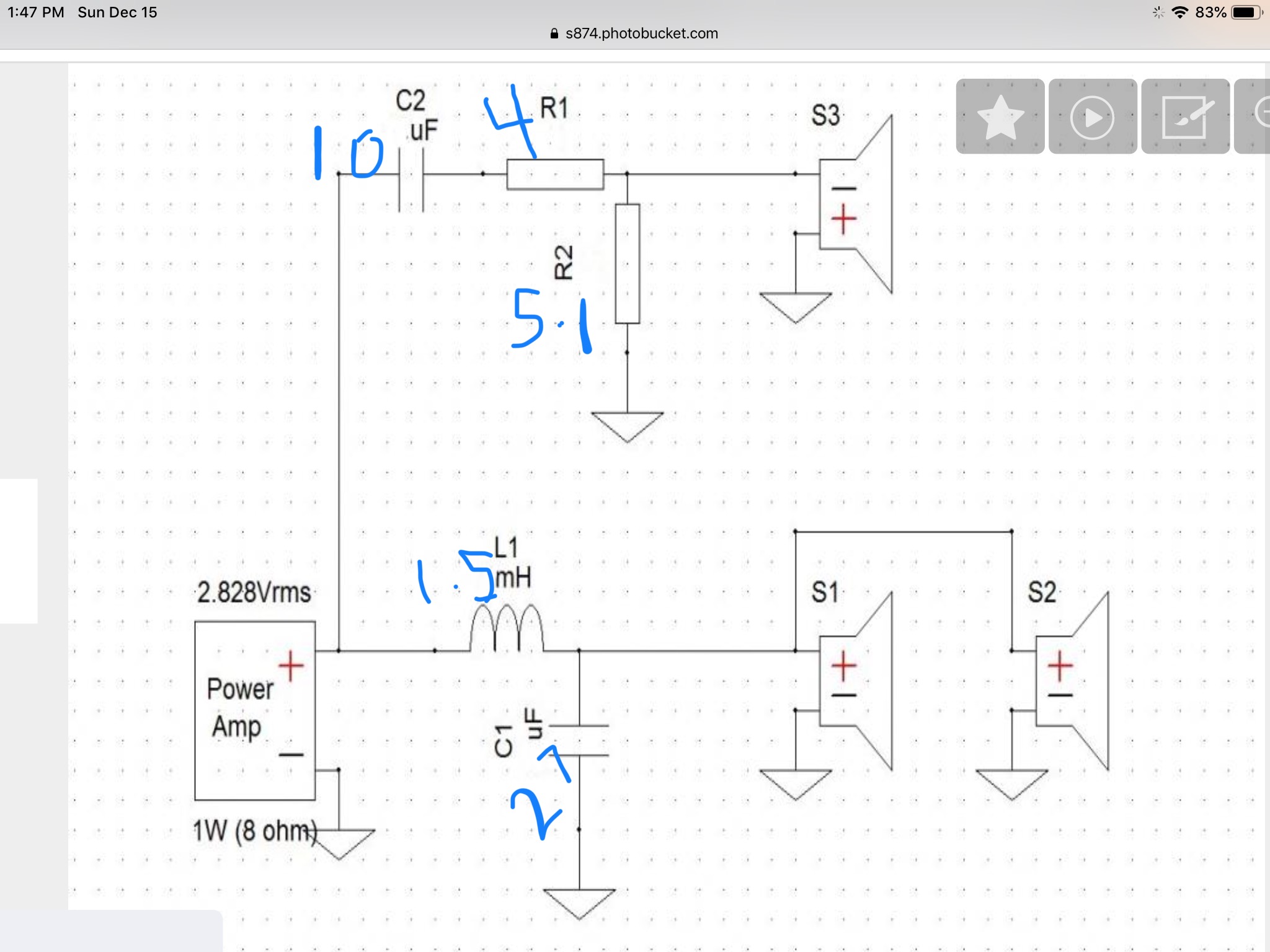

Bob, from the looks of the horizontal polars, the two M's are already asymmetrical. Do you have a schematic for the xover. Polars look great btw.
This is going off memory on the values.....the components are packed in the closet and I’m not sure which box their in, gives a rough idea of how simple it is though.
10’s are 16ohm, tweeter 8 ohm wired reverse polarity, 15” bass modules will be crossed dsp,
Gonna try the xo by itself b4 going full dsp on the mids.

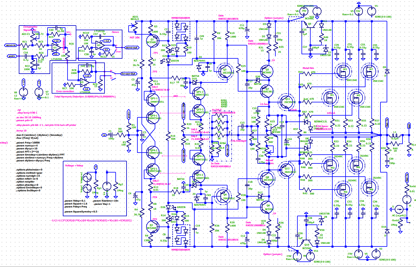

- I think a problem exists. DC offset in the output. Means the need to adjustments to minimize-it. In an industrial production, it has some cost and drawbacks.
- What are the artefacts you are talking about ?
On an objective and technical point of view, if there is no phase turn at 10Hz, and no increase of distortion (but the contrary) with the servo, could-you justify this assertment ?
https://www.diyaudio.com/forums/attachments/solid-state/787498d1570966205-pizzicato-200w-low-distortion-cfa-amplifier-pizzi-schema-gif
Here, the unusual* servo I use in this project.(See attachment)
The original audio signal is canceled in the comparator, before to be filtered and the remaining DC error applied.
Is here any luck we could notice a subjective and noticeable impact on the sound character ?
* No patent pending ? ;-)

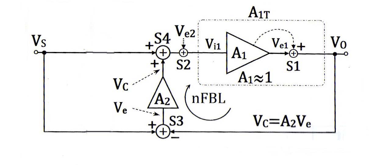

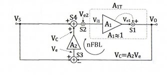

A bit retarded reaction, but just flying through the postings of this endless thread, I came across your suggested servo system, meant to remove DC from the output from the PA.
However to my opinion that is not what this topology is doing.
It should be seen as an Active Error Feedback or AEF, correcting distortion components caused by the PA, see image below.
When increasing the BW of the LPF in your schematic, it will do a very effective job of error correcting over the whole audio range, but DC at the input will come out as the same DC, not at all what a DC removing servo is supposed to do.
Hans
