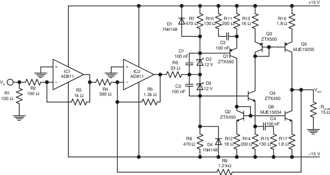

Here is a nice Current-Mode Amplifier (CMA) example I am going to try and measure and listen.
comments? Needs some adjustment to schematic;

Q1 Q4 bases AC shorted etc. sure doesn't instill any hope for good PSRR figures, add to that even poorer CMRR and PSRR from the AD811, ok that one could easily be swapped for a more hifi emphasized, but still... Richard we sure need to have a better circuit for audio before it becomes interesting studying CMA, any suggestion?

Hmmm OK. See my comments above, first. Yes, a number of things would be needed to fix it up for high quality audio use. R1 being 100 Ohms also wont work. .........
I will think of something else. BUT the point is to know the difference between CFA and CMA characteristics. Because there has been a lot of confusion about what is what or both are same thing etc.
So, one should look at the circuit from that point of view.

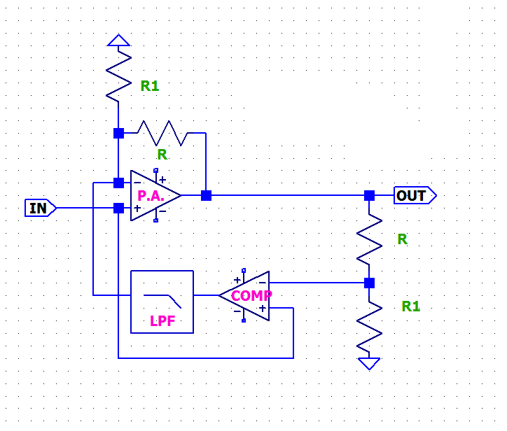

Ha ha, I wonder if you had not understood my schematic ? I use this servo AND this optional error correction you suggest (that you can switch in or out). Not at all the same purpose.
The servo is a servo, as it has no effect on the audio bandwidth, but only on DC and ultra low frequencies.
Just lke any other. The difference is the audio singnal has been removed by the comparator in order to add ecciciency and minimize any sonic impact of the servo.

Sorry, but I don't see your reason for laughing.
I should have included the original image of your "servo" that is even called servo.gif.
The text that you added to this image was:
Here, the unusual* servo I use in this project.(See attachment)
The original audio signal is canceled in the comparator, before to be filtered and the remaining DC error applied.
It seems you have forgotten all this.
But as mentioned, it is not a servo in the sense that it removes DC from the output, it is just a BW crippled AEF (Active Error Correction), crippled because of the LPF you inserted.
I have included the gain resistors in the AEF so you can compare both for better understanding.
As a matter of fact, the error cancellation ratio of Ve1 is roughly equal to A2.

I tracked down the article of the schematic you posted and as I suspected it is a video/RF amplifier and I am trying to understand its use in our application(audio). The author says that to maintain stability you have to limit the gain and I suspect the amp is only stable into a specific load and not a real world speaker.

Good find, and to publish like this without quoting a source would get you fired from any reputable research position. Richard, why did Jam have to do this for you, if I may ask?.

Thank you for the suggestion. I only have this fixation here because so many people, including Scott, keep saying a CMA is a CFA etc. If it is clear to all, then we can move on.

No it is not. Please keep glossing about “CMA”. BTW, the circuit you missed to quote the source for is an abomination for any audio purposes, starting with performance and ending with the load dependent gain. Don’t forget to post some measurements results when you will finish experimenting with, then some listening impressions from a collective sighted session.
I was not laughing at you, but the fact you proposed an idea that was part of the original design. Some kind of complicity, in my mind.
But I'm sorry, the DC servo i use IS a DC servo, by its definition.
A system that reduce the DC offset of an amp auto compensating it automatically.
I don't understand your controversy. In both cases (traditional VS this one) the audio signal is eliminated as much as possible, then the DC error is applied to the main amp input as a negative feedback.
Here, the only difference is the original audio signal is canceled as much as possible by the comparator, before the low pass filter. With all the obvious benefits that we can expect. One of them being less influence in the audio bandwidth of the OPAs as only the LTP of the comparator (input stage) has to deal with the original audio signal.
May-be Mr Marsh will explain-it in a better English than myself, as he is well known for its contribution in DC servos, and had understood immediately my idea. Original ? I think so, because I never seen this idea applied before to a DC servo.
Now, may-be you wonder why error correction was not enough to compensate the offset ? It is very easy to, explain. The phase turns at HF limit the amount of correction you can add. At low frequency you can apply a lot more. All the stability margins, response curve at low frequencies and speed of the servo had been seriously studied and optimized.
It seems very strange to me that, every time somebody propose a solution that bring improvements and is a little out of the box, somebody begin to argue against-it, not trying to understand or test-it.

Well, I agree about some of that. But it is only to learn the difference and what a CMA is and does. I dont know of any high end super audio CMA. Do you?
