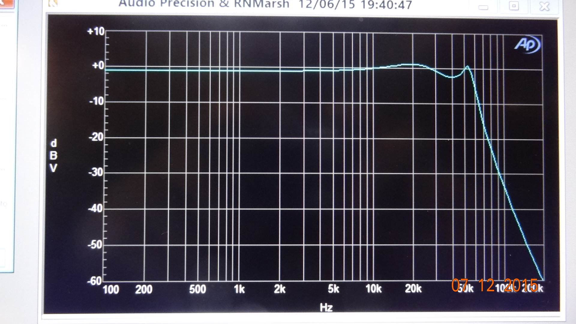

Here is a passive 5-pole flat Group Delay LPF for most audio VFA.
I am not concerned about the slight rise at 20KHz.

Look -- there is a lot of HF above 20KHz. A lot of digital artifacts which is supposed to be all filtered out but isnt all gone. fairly high levels which get amplified. I showed the spectrum analyzer of that HF junk. If an amplifier isnt linear up there, IM can fall back into audio range.
Many audio VFA may not be as linear up in HF area as CFA. It is harder, at least. So, LPF is applied to VFA input to keep HF junk from creating audible IM. Or even potentially audible.

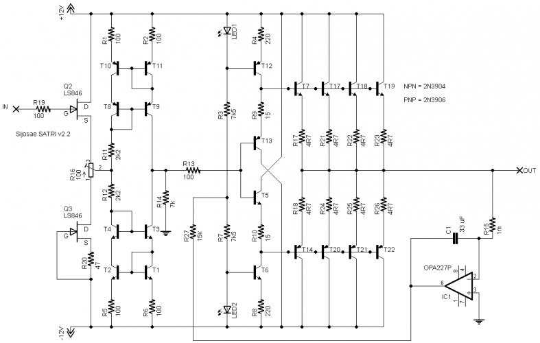

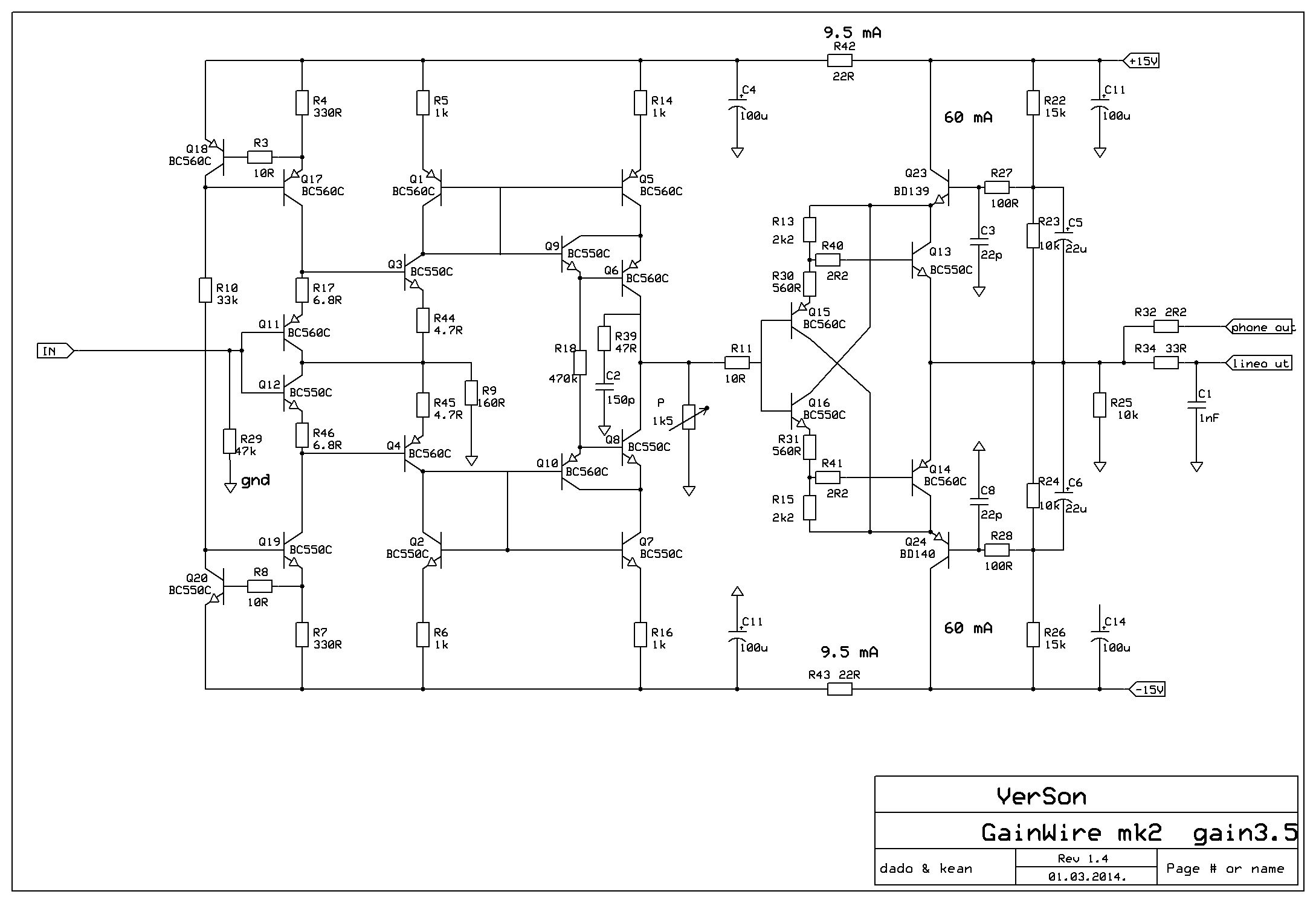

Richard, schematic you showed use current conveyor, is that definition for CMA?
Have you heard of SATRI circuit used in Bakoon amps? AMP-41 - Bakoon International Corp.
I use in my GainWire mk2 and mk3 current conveyors.
attached preamp with SATRI circuit and GainWire mk2 with volume control after IPS (current conveyor), no GNFB used.

I asked about that Bessel filter, what is the relevance in the current context?
Now that you repeated the same (IMHO wrong) explanation about why we would need high slew rate, let me come up with a numeric example:
In order to avoid ANY large signal slewing distortions, EE101 tells us that the amplifier has to have a slew rate larger than SR=2*PI*Vp where Vp is the amplifier output peak voltage.
Let's take a rather extreme example of an amplifier delivering a continuous 400W/4ohm load (which I hope you would agree it is more than enough for any imaginable home use) and a bandwidth of 200KHz (which is 10x the maximum audible frequency range). To avoid the large signal slewing distortions, this amplifier needs a SR of 2*3.14*56*200000~70V/uS. Note that the rule of thumb delivers 56V/uS. I don't see any reason why a lareger slew rate is required, your "HF over 20KHz" argument is simply false, since it is supposed to be removed by the input filter that any competently amplifier employs.
This input filter not only removes the HF junk, but it is also avoiding any entering into slewing limitations; that's because the input signal slewing will be limited to the input signal amplitude divided by the rise time that is 0.35/bandwidth[GHz]. So any slew rate provisions in the amplifier are in fact completely useless, since the slewing limitation will never be reached.
WOW. You really dont get it, Waly. It is the linearity above 20Khz which is not always steller in VFA. It may have a BW > 20KHz but that is no guarantee it is low distortion over the entire BW of the amplifier. usually, the neg FB falls off and distortion rises.
I said higher SR amps also seem to sound better and that maybe the distortion is lower at HF.
The filter on a VFA would be preferred to limit the signal BW IF the amp cannot linearly amplify HF and cause IM <20Khz.

Thanks Richard, you just proved you are unable to read more than 2 lines in a post and get through some elementary calculation. Nothing you are saying above holds any water, and to add insult to injury you are saying that an input filter is required only for a VFA. For the very wrong reason (in fact, it is intended to avoid EMI ingress, same for CFA, "CMA", VFA).
