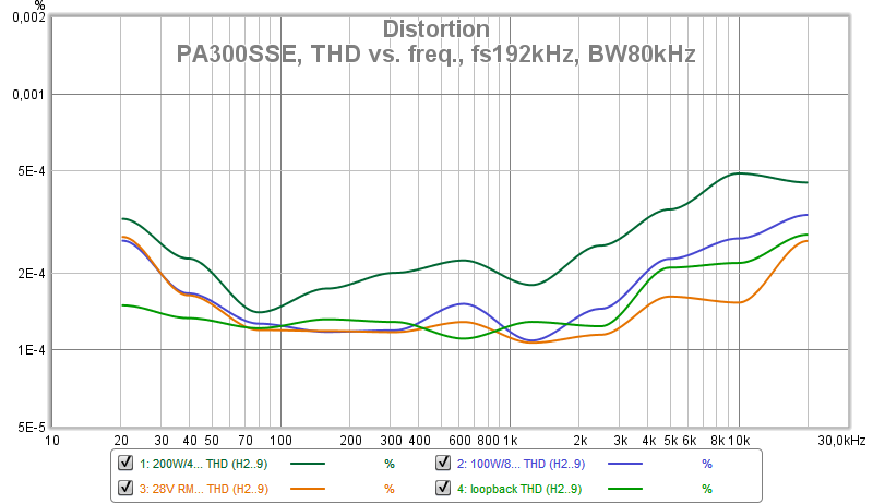

Impressive! Into what load?
As I wrote, no load at otput. Just to show "capacitor distortions"..With load it looks like this, in picture is also no load measurement and card loopback.

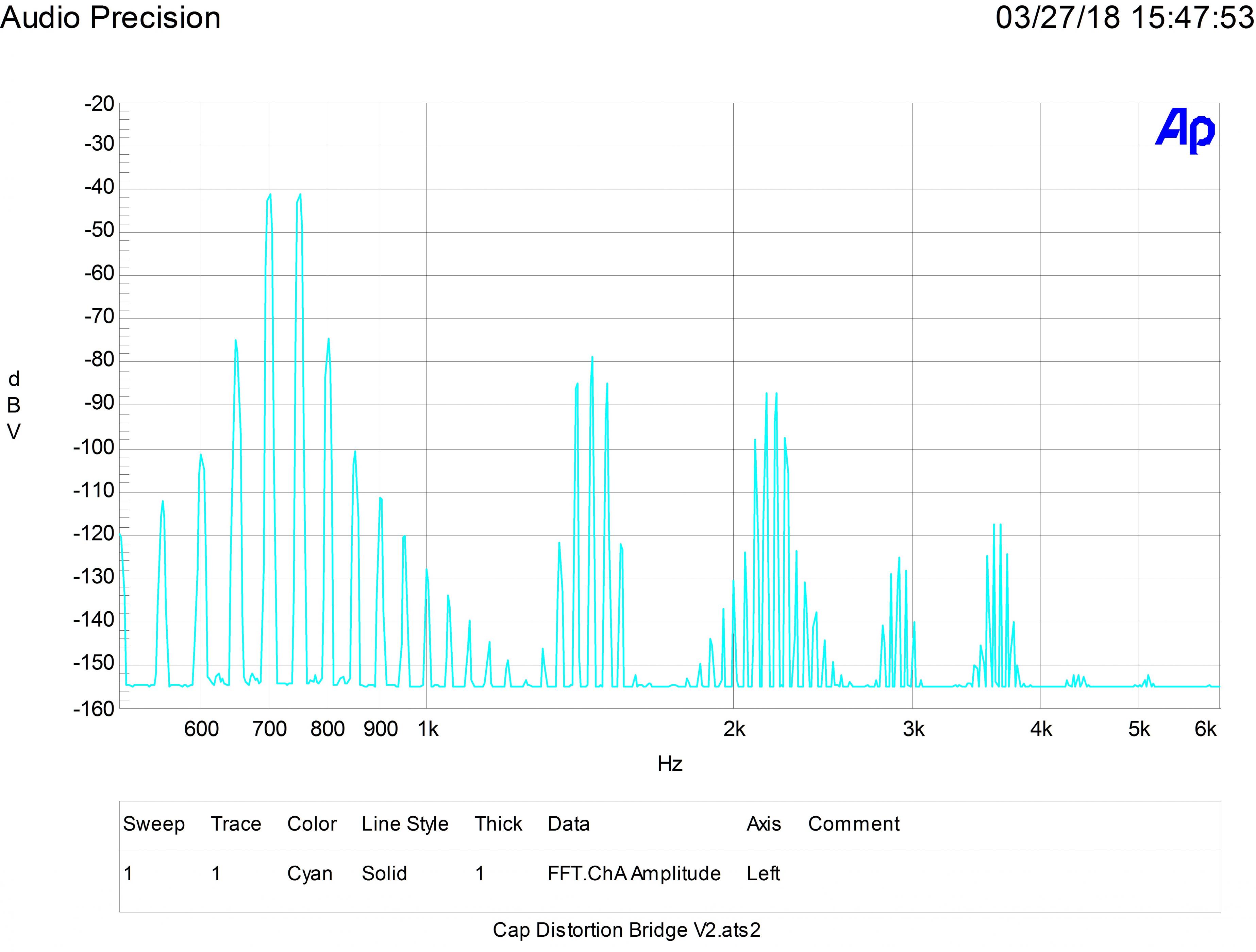

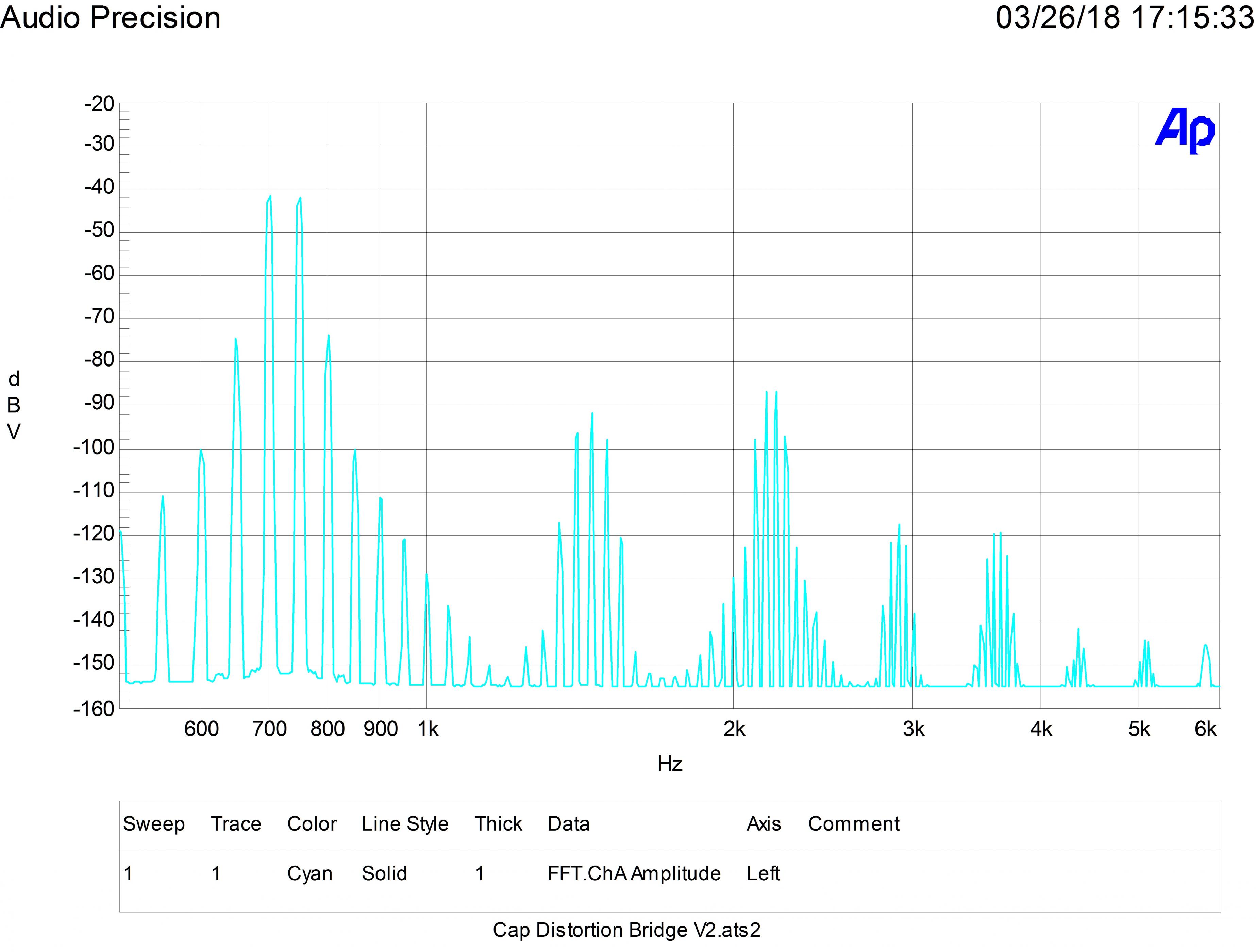

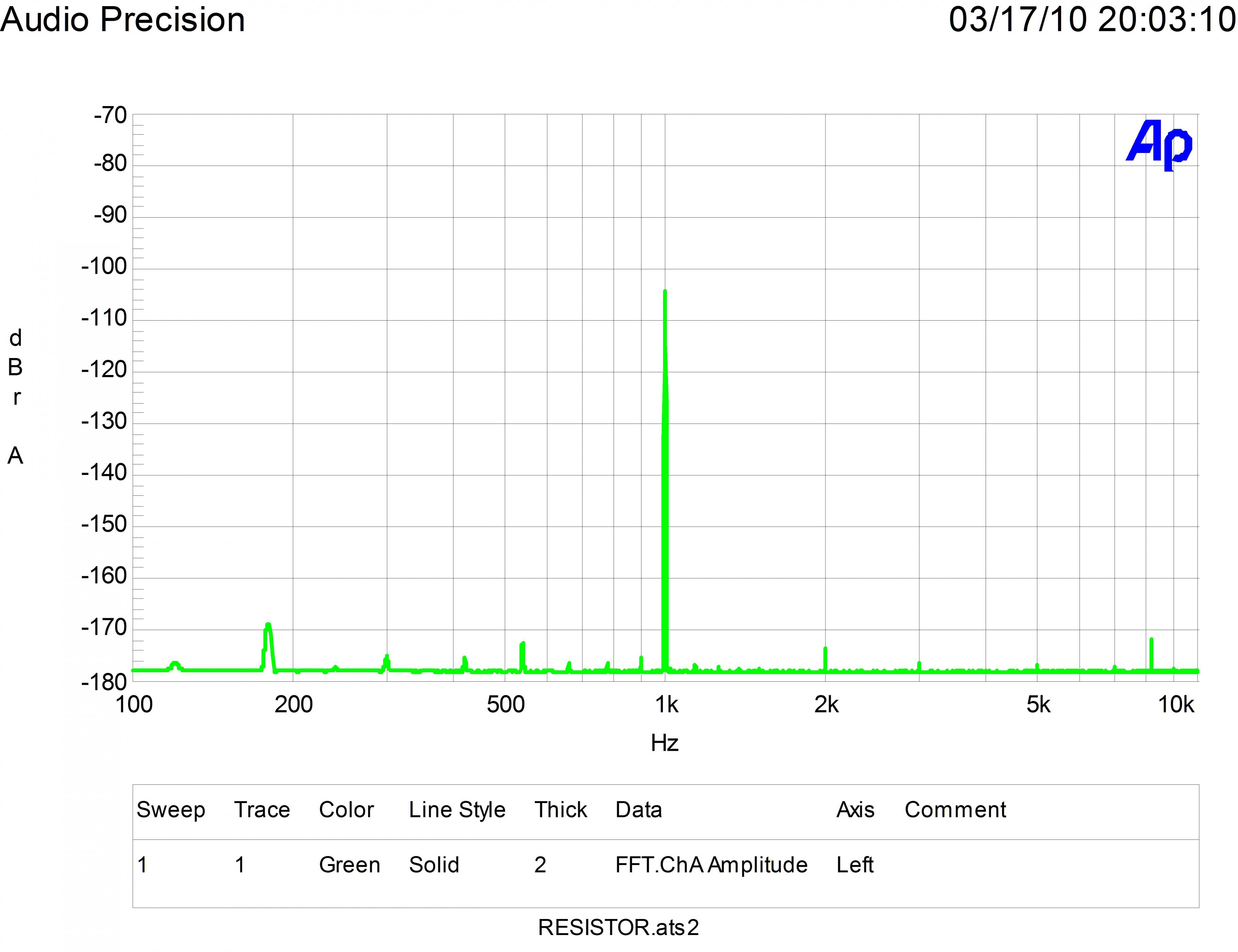

Resistors can be very good, capacitors are not quite as good and mis-selected can be bad. Inductors are generally the component that least matches circuit theory. However we have to use what exists.
Good or not quite as good, in what terms?
Resistors may have distortion contribution 160 dB below the signal level, good capacitors may be 130 db below the signal level. Inductors don't get near that even for small signals. Attached are my measurments on capacitors and a good resistor.
Quote:
Originally Posted by simon7000 View Post
As Demian pointed out there can be multiple capacitors in series. As their distortion mechanisms may match the distortion can add. So with 10 capacitors in series the distorton instead of being -120 dB down may be only -100 dB.
A well proportioned coupling cap does not distort.
All parts distort, the question is how much in their application.
If you hold your mouse over the thumbnail the ID will show.
Or the question could be to be sure that harmonic distortion is the main flaw in action. It seems to me that electrolytics flaws are more situated on transients. Like some kind of instant limiter, if you see what I mean. I would like to see a bit-bit comparison with good musical signals (Acoustic guitar, drums kit, percussions).
