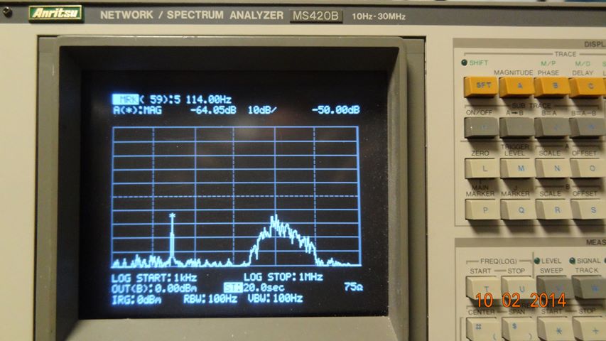

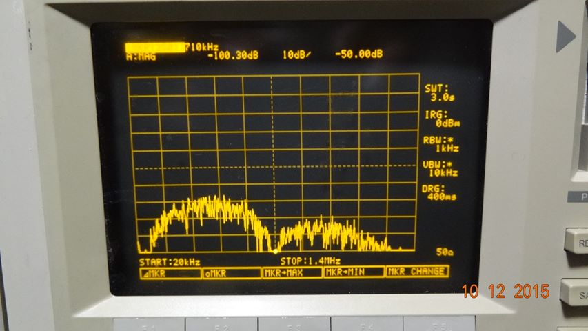

Here is my reasoning why CFA often sounds better. It is not because of distortion within 20Khz BW. It is what happens with the HF when it get amplified. Freq above 20KHz if they are within BW of amp will try to amplify them also. If it cannot do it with low distortion, IM products fall within the audio range.
Here is a sample of HF from DAC's which does NOT get all filtered out at the DAC.
59997341_395311107864660_1557298456551227392_n.jpg 60355434_339012076818448_3962280641080328192_n.jpg
If using/designing a typical high nfb VFA, you will more likely need HF filtering on input.

a) That looks like a really bad DAC with those artifacts in the 10’s of KHz range, are you sure those are strictly from the DAC?
b) What’s bad with input filtering? VFA or CFA both need it to avoid RF ingress, anyway.
Probabaly the DAC and its shifting effects of noise and distortion/artifacts above 20KHz. This is simply measured at the analog output of CD players.
It does not hurt anything to have HF filtering on both types. but usually isnt done on either type. Or not low enough freq to matter.
The CFA amp is linear and fast enough (SR) to have little distortion at HF freqs. Not so with VFA with increased distortion as fb is reduced at HF.

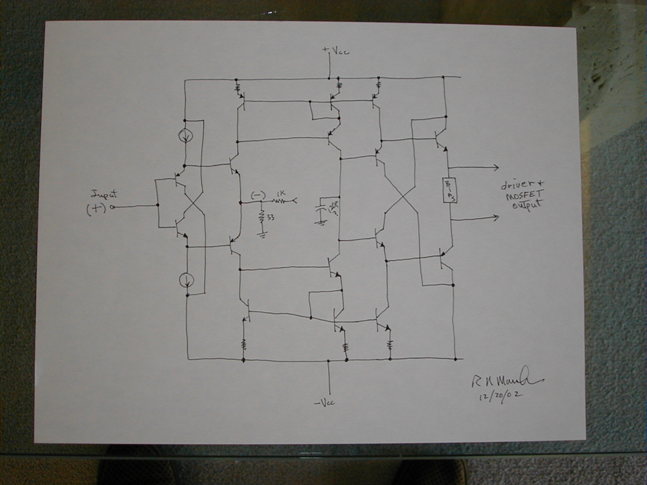

This is the topology of my choise today and variations of it.

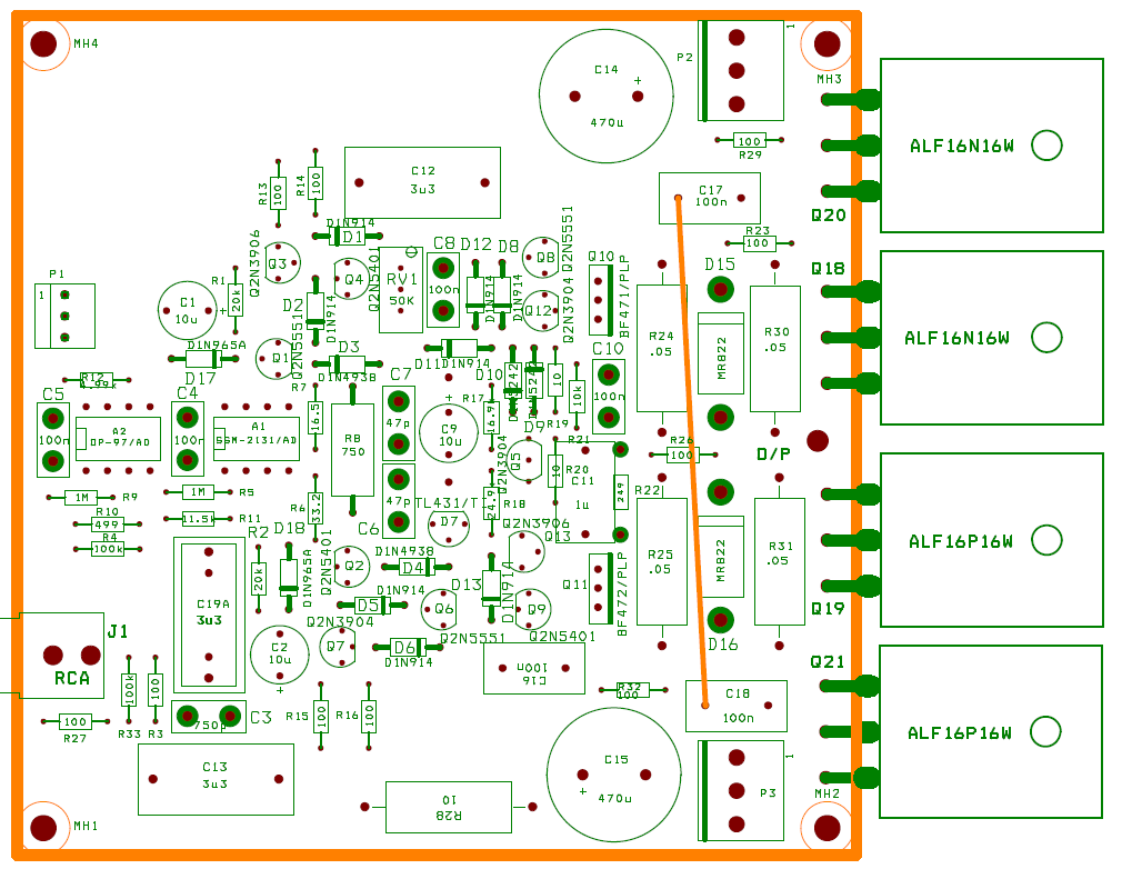

One day I will fab this design just for the fun of it. Once I clear off all the other projects on my plate 🙂 Esp now that pcb's are so cheap when you make them 100x100mm. lateral mosfets are not so cheap however.
Duh, I go looking for the Coto relay in that layout and it is not there 🙂 That's okay, the source resistors can go, told they are of no use in a latfet design, so can the IV limiter, makes a lot more room to put the relay in there, its been a few years since I looked at this design. I did few versions of this design, might have gotten lost in HDD crash years ago.
