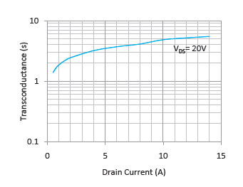

No. For a high power amplifier, lateral MOSFETs are the worse option. That’s because their transconductance drops quickly at high drain currents. One of those double laterals has a transconductance of 2S, compared to 5S for the usual vertical MOSFET. This means you need x2.5 more lateral output devices to get the same current capability. It is true that the same transconductance collapse makes the laterals very reliable, much harder to smoke compared to the vertical counterparts.
But this won’t help much if the amp bursts into oscillations, which I believe is what’s happening to yours, as the root cause for the crash and burns. You and Dadod are learning the hard way, on your time and dime, a classic lesson: there is no free lunch when it comes to negative feedback. Which is: for any fixed frequency compensation order (2, in your case) increasing the loop gain (that is, ultra low distortions) always comes with a stability penalty, there is no way around. Reason is, audio amplifiers are minimum phase systems, gain and phase are not independent and the maximum feedback theorem applies. Dadod was told multiple times, by myself and others, that pushing his amp ULGF to 3-4-5 or even 6MHz is not without a stability price which may not be easy to identify by simulation, due to the complex multi loop feedback structure, but nevertheless the limitations are unavoidable there. When I see a very high ULGF, with a second order frequency compensation network, I don’t need any fancy simulations to know that the stability is, somewhere, compromised... Dadod choose to ignore the warnings and here we go... this is feedback theory, one of those pesky unforgiven EE things.

I do not see the transconductance dropping off with an increase in current for the ECW20N20 device, I see it rising, refer to the attached graftNo. For a high power amplifier, lateral MOSFETs are the worse option. That’s because their transconductance drops quickly at high drain currents. One of those double laterals has a transconductance of 2S
The graph shows the transconductance up to Id=14A only, well under IDmax=16A. That’s the region where transconductance starts to drop quickly, so that lateral mosfets are self protecting. That, and the Vgs positive tempco at high currents helps as well. Meaning that laterals self limit their drain currents, unlike verticals and bipolars.
