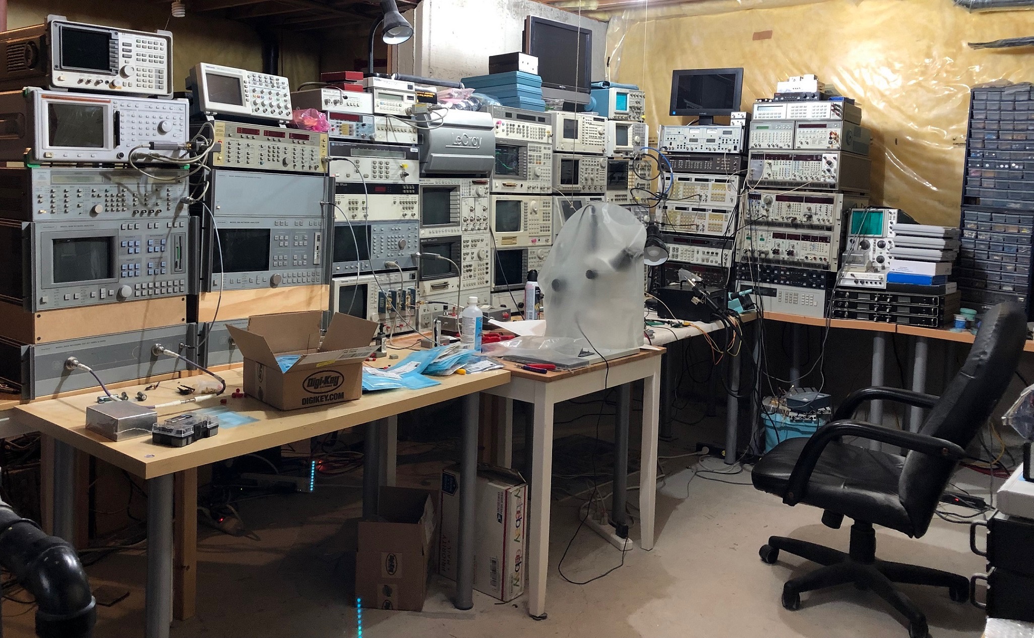

A thermal camera (FLIR) or IR sensor gun would be useful to diagnose if the blowup is device thermal issue and where.
Amusing. R.N.Marsh is one of this forum members the best equipped with measuring instruments of all kind.
