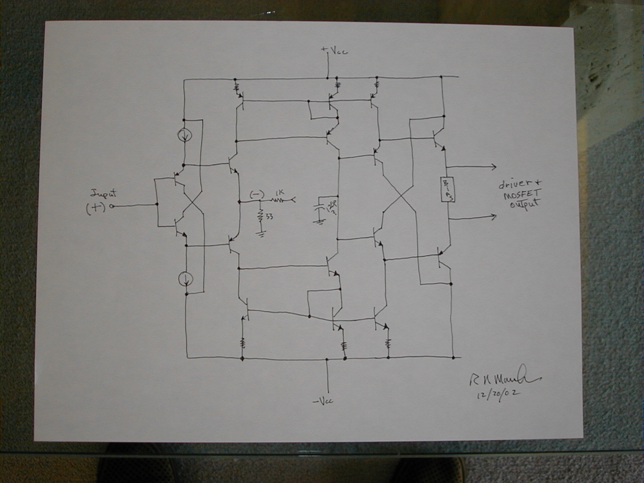

Probabaly the DAC and its shifting effects of noise and distortion/artifacts above 20KHz. This is simply measured at the analog output of CD players.
It does not hurt anything to have HF filtering on both types. but usually isnt done on either type. Or not low enough freq to matter.
The CFA amp is linear and fast enough (SR) to have little distortion at HF freqs. Not so with VFA with increased distortion as fb is reduced at HF.
This is the topology of my choise today and variations of it.
BTW -- All M. Levenson amps/preamps have been band limited since forever. A key contributor to why they sound better in most systems. 🙂
Originally, put there to prevent triggering TIM, but now useful to remove digital artifacts, also.

CFAs don't provide any extra linearity at HF compared with any other topology. You are probably thinking of a high ULGF (allowing more loop gain at HF), which is by no means not specific to the CFA topology. You already found out what is the possible result of pushing the (power audio) ULGF to warp speed values.
I'm not aware of any competently designed amplifier that doesn't have some sort of HF bandwidth limitation at the input. Those that don't once again qualify as pathological implementation an canot, by any means, be considered as typical or representative.
Slew rate has a) nothing to do with distortions, provided it is high enough to avoid large signal slewing distortions (and the rule of thumb for slew rate in audio already has a 10x coefficient) and b) it is not attainable by CFAs only, VFAs with 100's of V/uS slew rate are pretty common.
I'm not expecting to get you out of your CFA trench, but just to set the record straight.

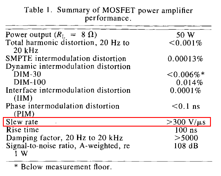

My 300V/us VFA still seems to manage quite well.
Bob Cordell got the same number in his VFA, published in JAES in 1984. He attributes it to using a different compensation scheme, not Miller-effect pole splitting in the second stage.

My 300V/us VFA still seems to manage quite well so I'm in the camp who doesn't see the magic of CFA.
Oh you mean that CFA with buffer on - input = VFA? Yeah that works good also.
An easy 8 Ohms and only 50W? Really? That isnt good enough for my system requirements.
Whats the distortion above 20KHz? Unless, you missed the message, the issues are from above 20Khz and not < 20KHz.
