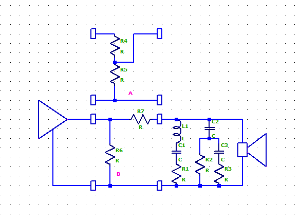

Is not it obvious to everyone? (As long the speaker is an electrodynamic one and not an electrostatic one.)The truth is that we are listening to the current of the amplifier, not the voltage of the amplifier.
So, the solution to reduce distortion should be to add the RLC+RC networks I use with all my speakers in order to linearize their impedances curves down to their DC value (amp side). And to drive them in current (high impedance source) that I never tried for bass speakers because we are looking for max damping at the resonance frequency. Happily, I use horns for medium treeble, that are > 10dB more efficient and are powered across a serial resistance.
To tell the truth, across an attenuator. You gave-me the idea to use the B circuit instead of A as a start.

Agree too. Some kind of "Choose your poison".Manipulating the bass response with a high impedance source doesn't strike me as a particularly good idea in this day and age
If you refer to my previous schematic, I'm not manipulating the bass response curve. Only the impedance curve.
About damping, if you hit a bass speaker (unconnected to a ~O Ohm amplifier) with your finger, you will hear the huge effect of the RLC on damping its resonance. Similar to the one provided by the low output impedance of an amp connected to the coil.
About " in this day and age", it has been a long time since series resistance has been added to compression chamber motors in order to reduce distortions.
From a technical point of view, this seems unlikely to be the mechanisme behind what you percieve.
With the loudspeaker terminal open, there is nothing inside a regular crossover of any order that presents a DC path as seen from the bass driver side. In other words, for the relevant low frequencies, the bass driver sees an open circuit when it looks into an unterminated crossover.
So no electrical damping at all.
