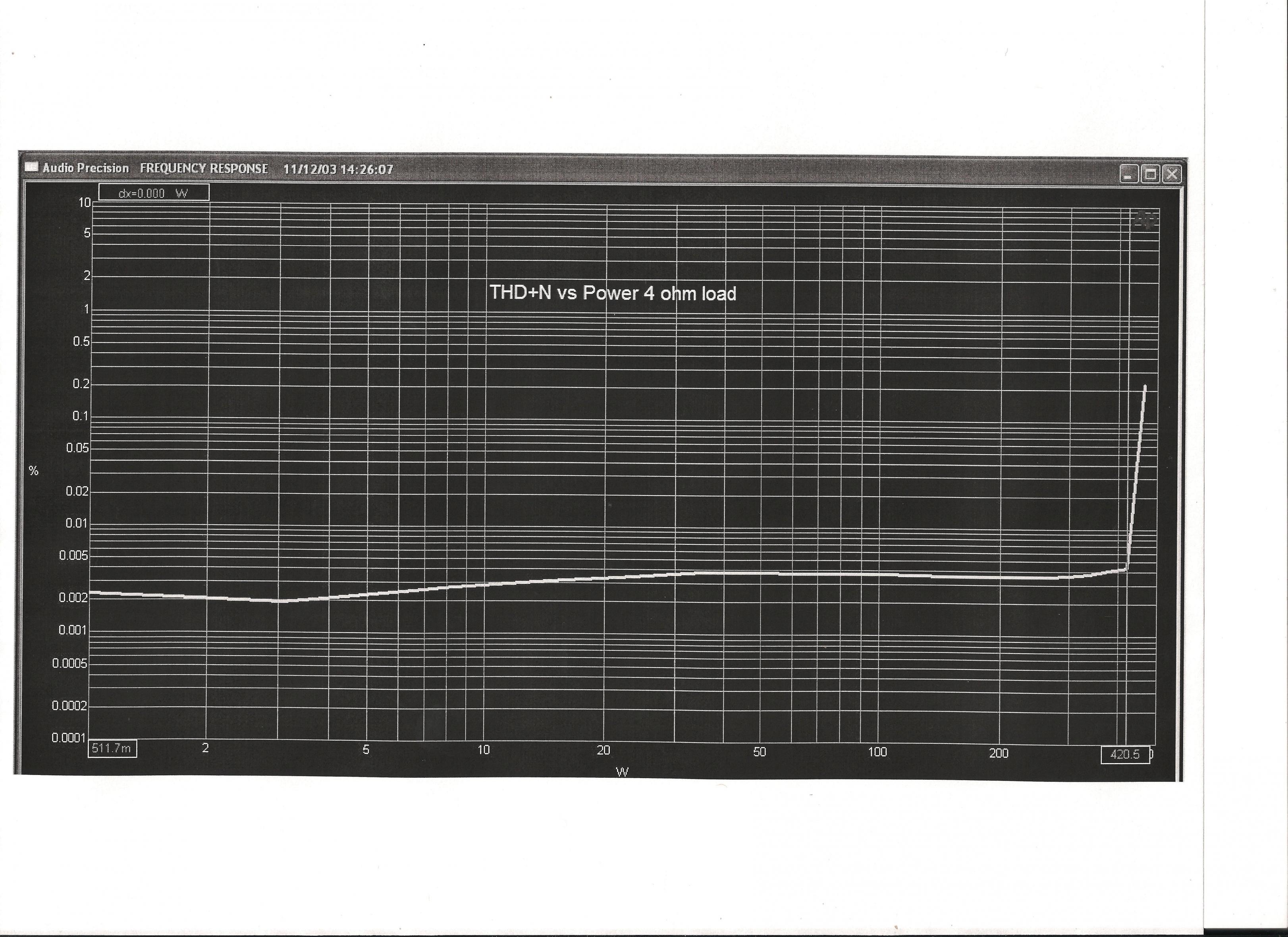

Richard measured this amp, he knows what he talks about.
Attached THD20k at different input levels - means output power.

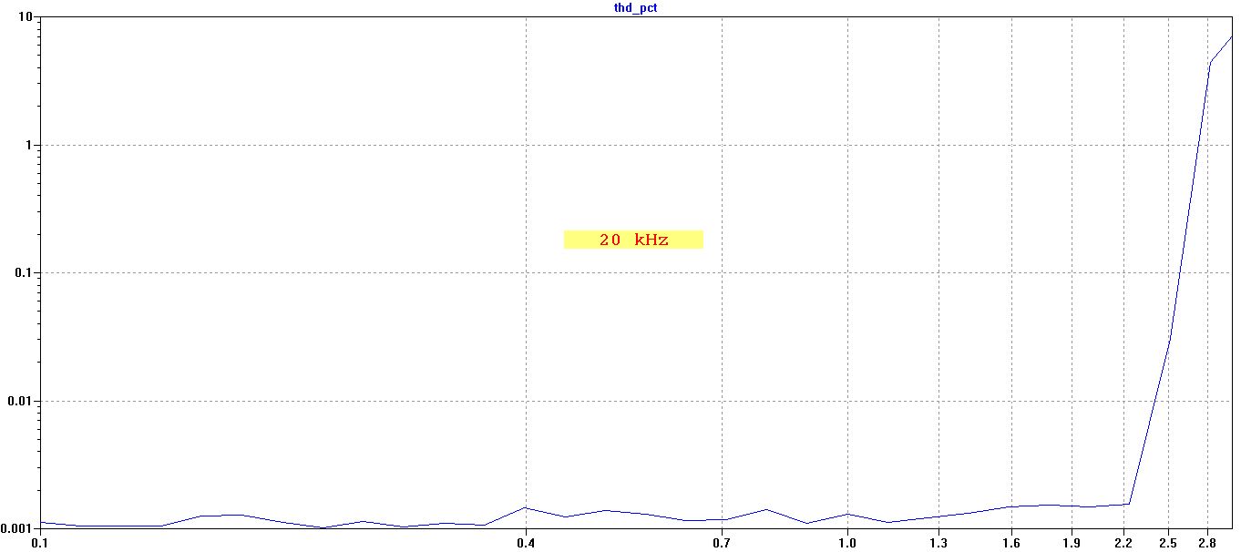

What did you do for the other 1094 days?Hi Richard, I have been working on this for three years:
That's very good. Over a 30-to-1 range of inputs (from 0.1V to 3.0V), THD-20 stays pretty close to 0.0015%.Attached THD20k at different input levels - means output power.

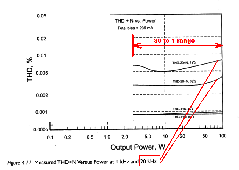

For comparison, here's the unsophisticated "teaching amplifier" BC1, from Bob Cordell's book. Chapter 4 in the 2nd edition. They're working to make PCBs available to diyAudio members sometime soon, so I have been told.
Over a 30-to-1 range of outputs (hence inputs too), THD-20 for 8 ohm loads stays pretty close to 0.003%. But, unlike the plot you showed, it never exceeds 0.005% across that 30-to-1 range.
Congratulations to both amplifiers and to both amplifier designers!

8 Ohm loads are pretty easy.... the THD is very low down to 2 Ohms with DaDOD's amp.
.001% with 8 and .002% with 4 Ohm load. Lower power and freq., distortion is well under .001%

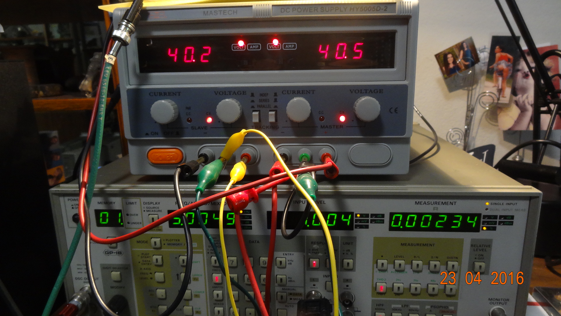

+/- 40vdc on a 5534 running just fine.
View attachment 799084 7/24/2016

Dadod, yes I know your amp that is the most impressive CFA I've seen.Richard measured this amp, he knows what he talks about.
(Could-you provide the same curve at 1kHz ?)
