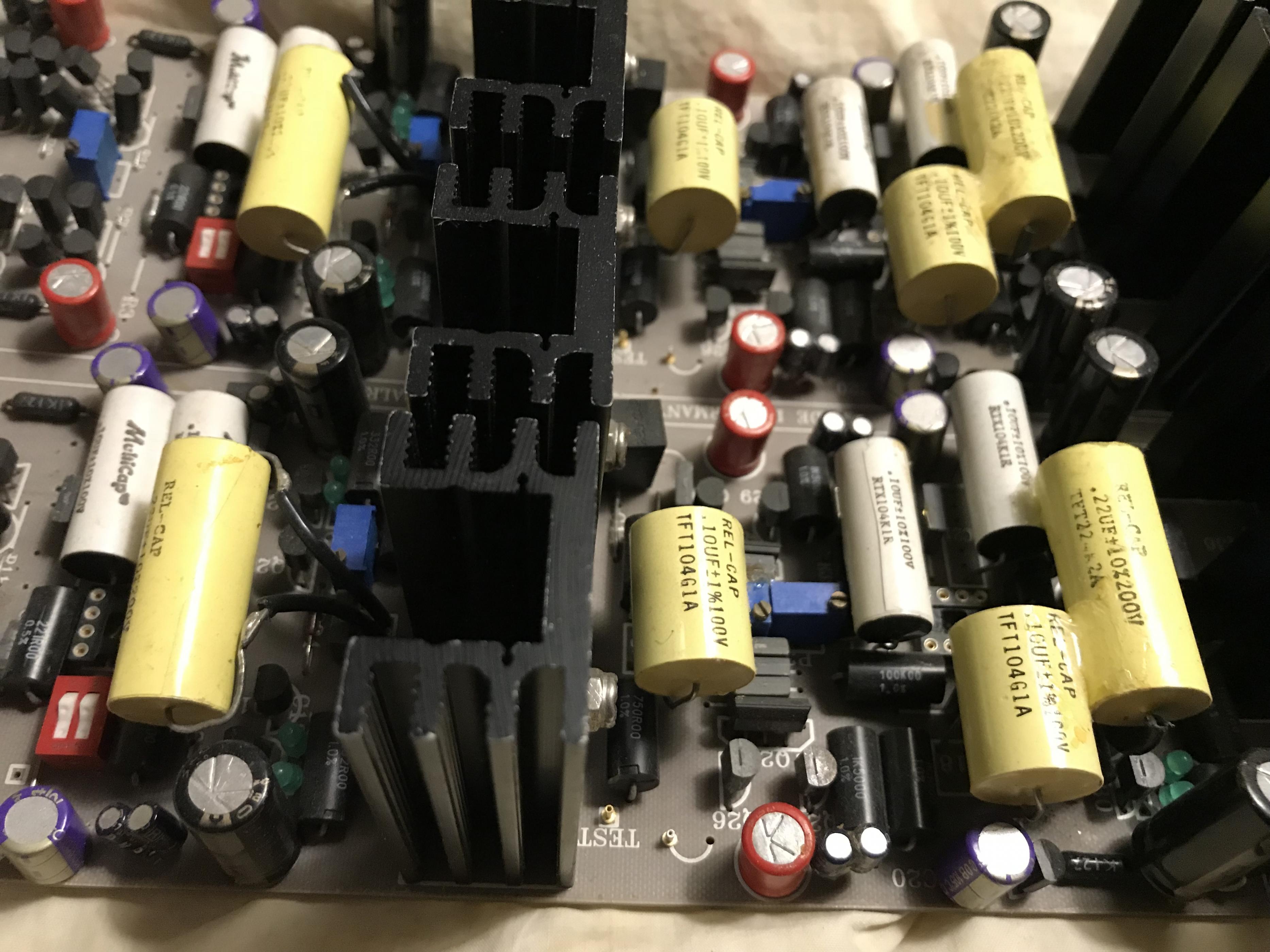

Direct coupled Borbely jfet phono stage with all Relcap films - 1% teflon RIAA caps, polystyrene servos, teflon bias bypass, and Blackgate electrolytics. And glue to hold the oversize parts in place. Teflon pc board. 90 ma output stage bias.
Front end is 4 x 2SK147 and 4 x 2SJ72 jfets
