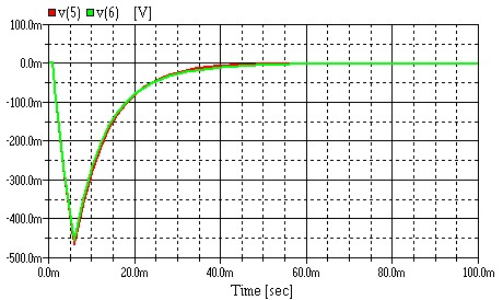

Provided its frequency is low enough, a steady state square wave input can excite transient ringing in an RLC circuit, at a frequency that is independent of the square wave's fundamental frequency or odd harmonics.
Before you go too far you should compute the spectrum of a damped ringing initiated at exactly 500us intervals (for 1kHz in for instance).
In the case of when you first turn on the square wave generator, you can calculate time time domain response by modeling the waveform as a series of steps adding up to a square waveform lasting for as long as you want. The ringing you observe in this transient case should be the same as you calculate, with no mystery new frequency production. It is completely linear.
The forced response certainly responds to the input frequency by definition, but the natural response (also called the zero input response) does not.
The steady state response only contains harmonics of the input and a single transient excitation of a resonant network does not contain only the fundamental resonant frequency. Standard Fourier analysis and the convolution theorem give the correct answer.

It will have less than infinite Q, meaning it has some ability to store and release energy at other than f0.
Once in the steady state it will be running at the forced frequency and its harmonics and off of its natural center frequency.
In the transient condition, it will have an exponential envelope converging on the steady state case.
It's linear. There is nothing that requires nonlinear modeling to explain.

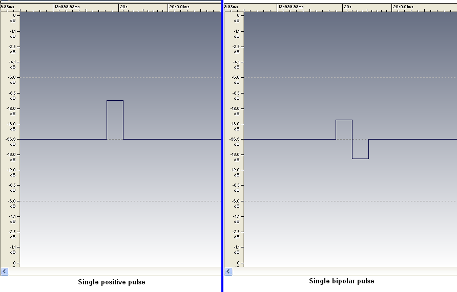

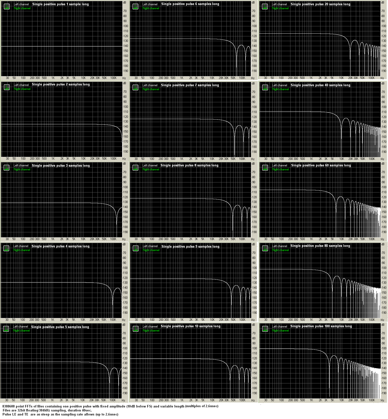

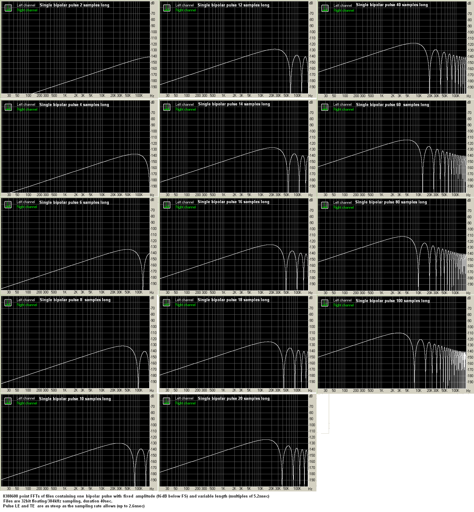

This is the FFT spectrum of a single positive pulse and of a single bipolar pulse
(I was doing some work on vinyl scratches, this may be useful here)
