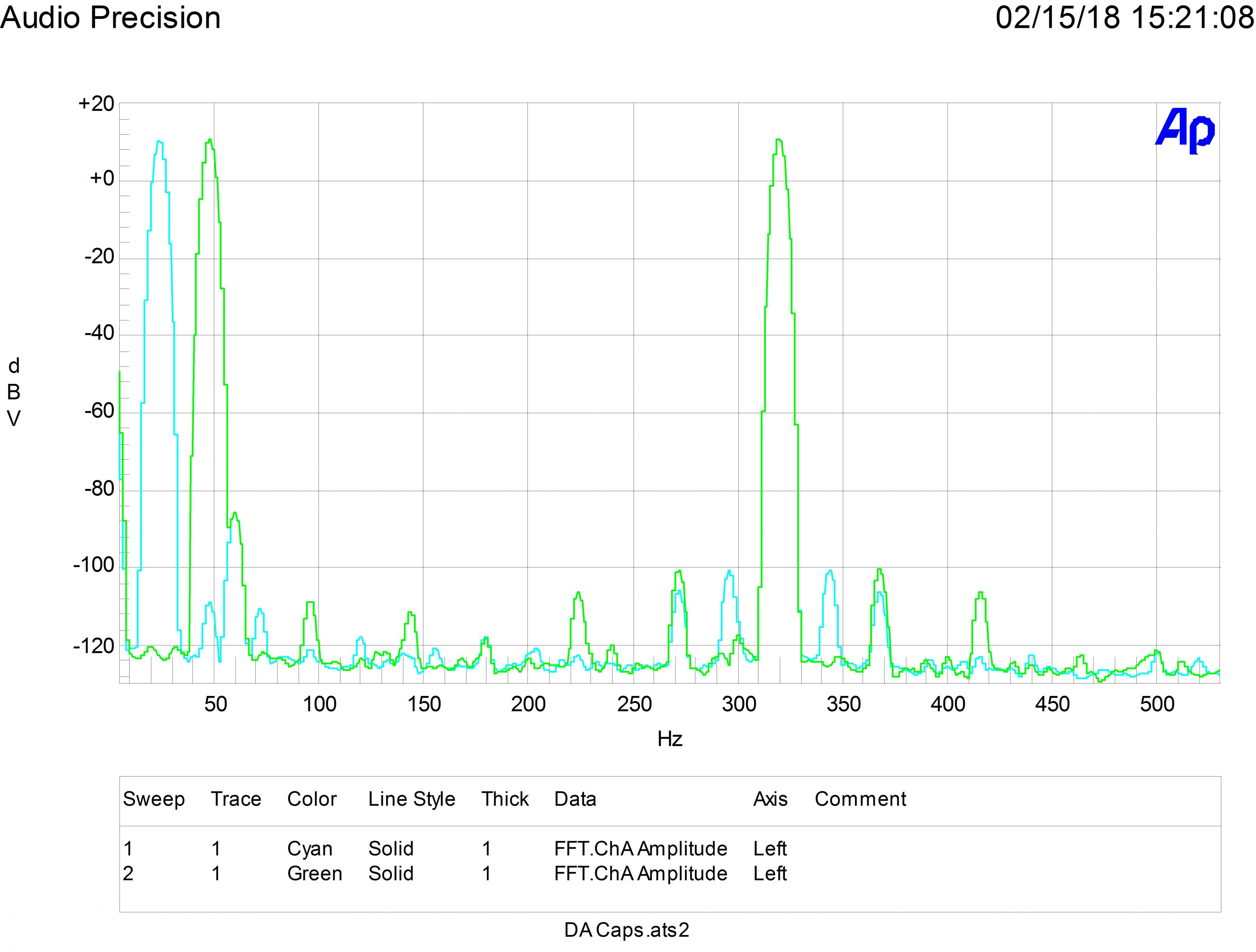

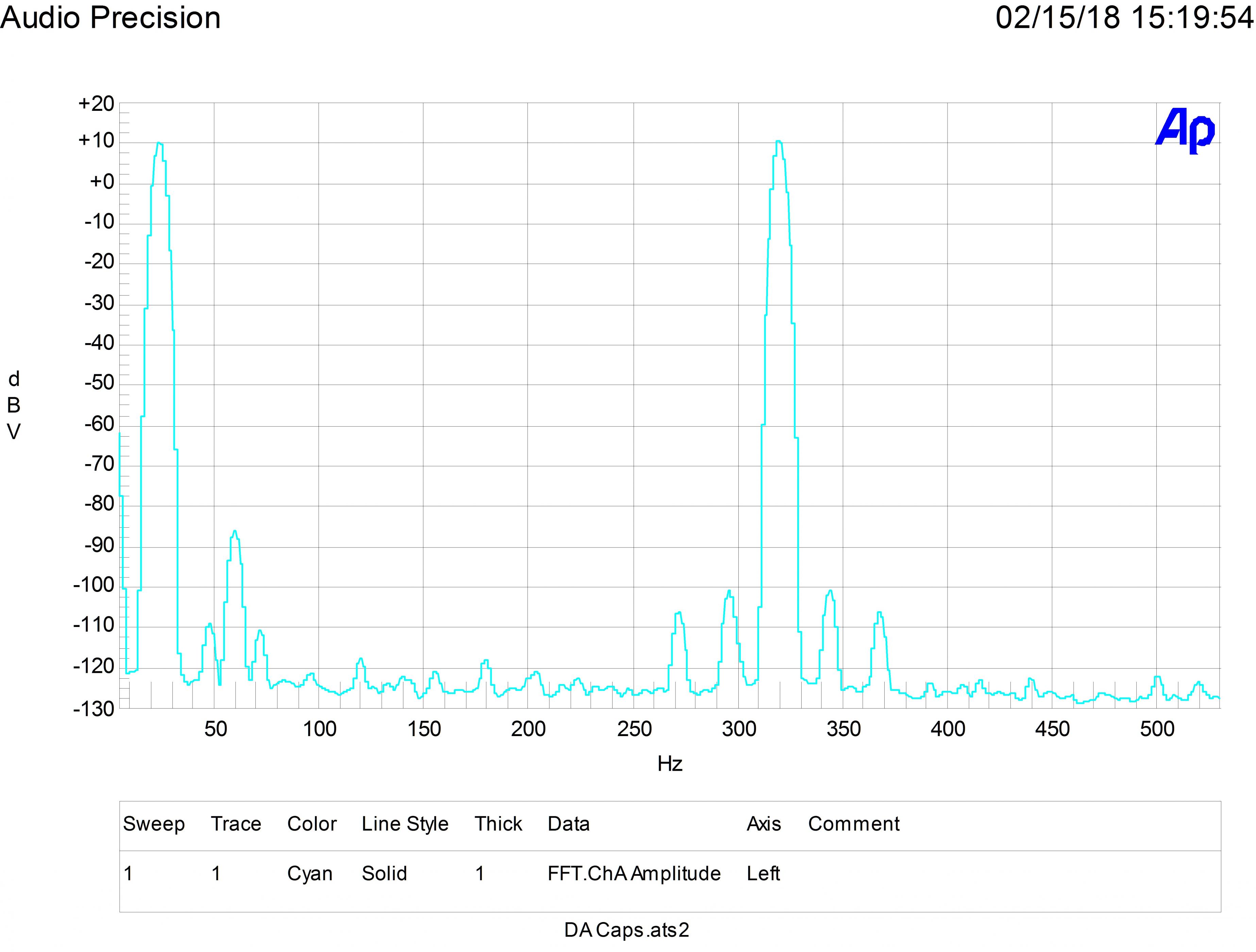

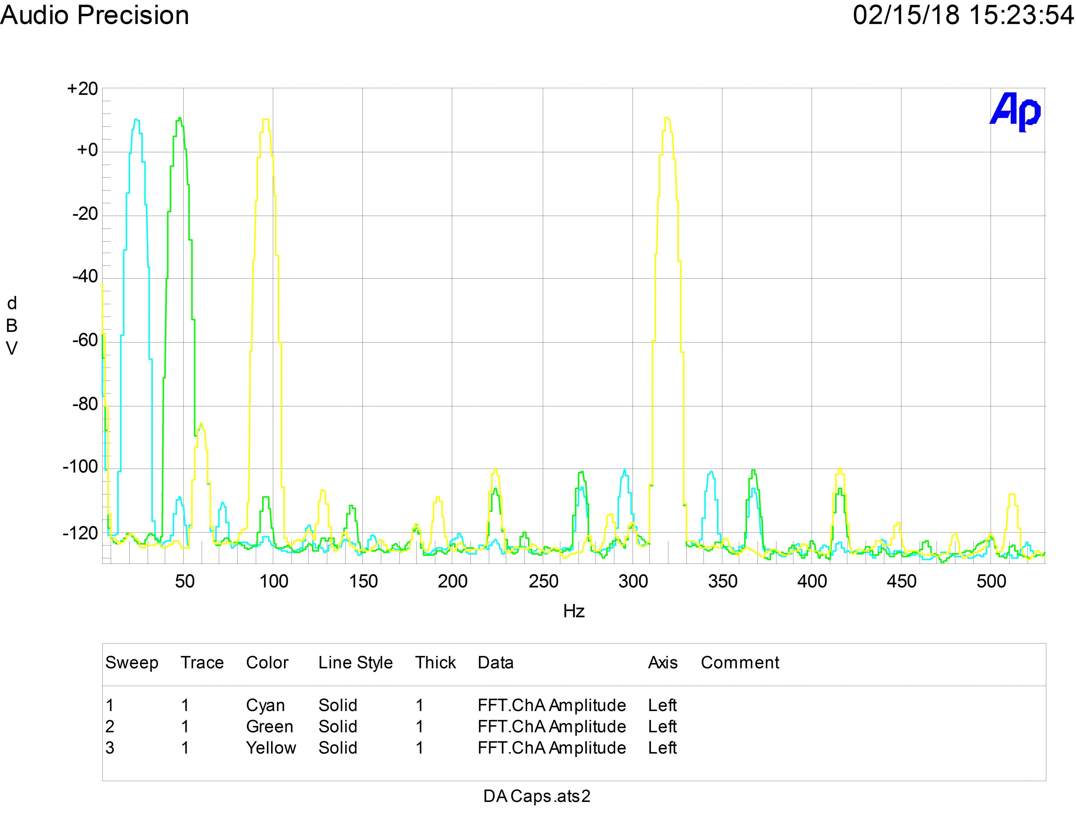

Three more runs. 24, 48 & 96 hertz through a .33 uF capacitor into a 10,000 ohm load. Note levels of harmonics and IM products.
Can you make a scketch of test setup for me to try same tests?

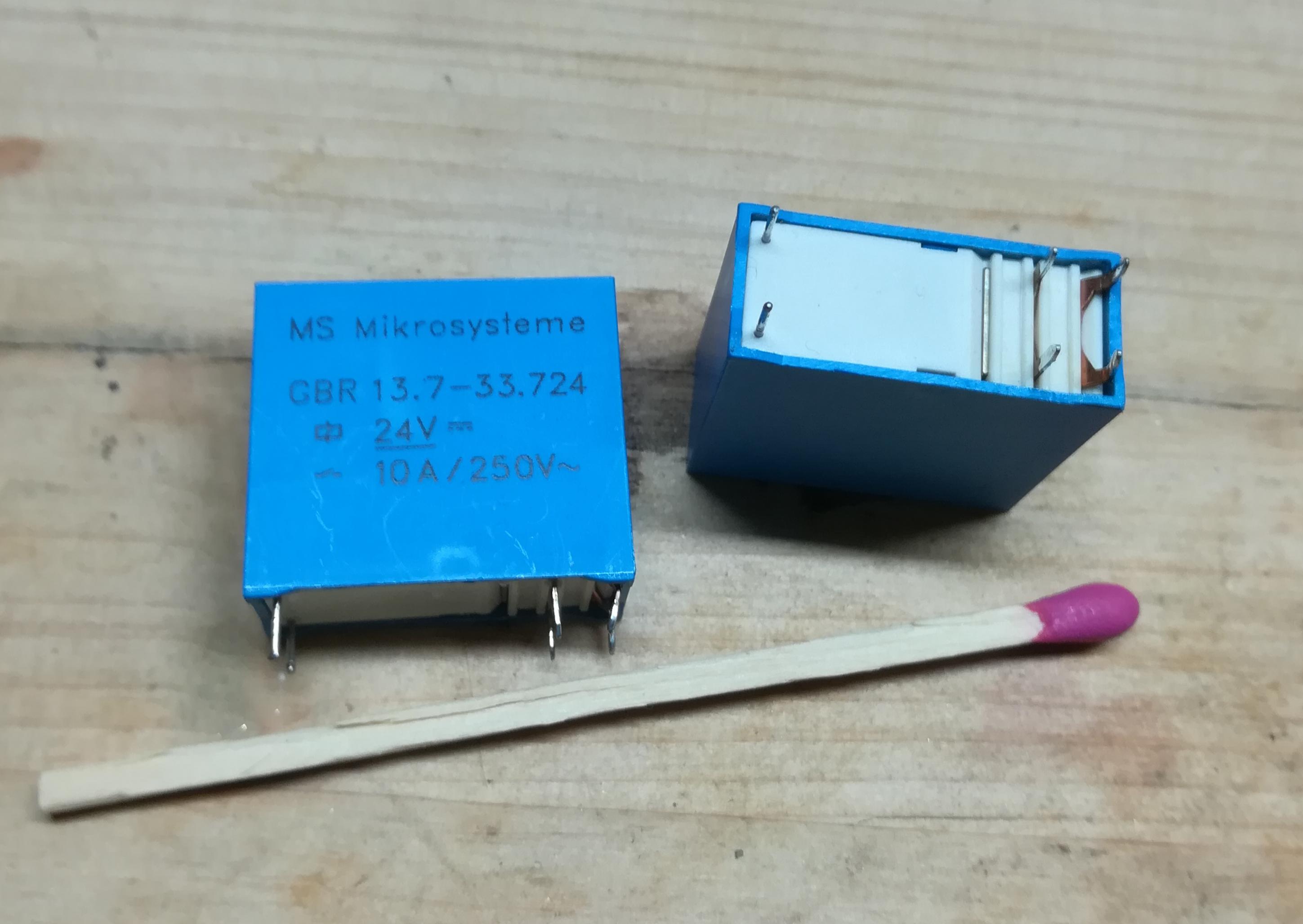

Jan already mentioned this relay as suitable if he missed it Toroidal Transformer Amplimo - toroidal-transformer.com
I know, and I would never use it ... 🙂 but I did (in the past).
This particular relay looks like 2-3A/contact. I do not think it is enough for a power amp.
You are right 🙂 it's to small for any serous amplifier.
... BTW, they claim the contacts are rated for 100A, and suggest for use in amplifiers up to 500W...
As you say, they claim...

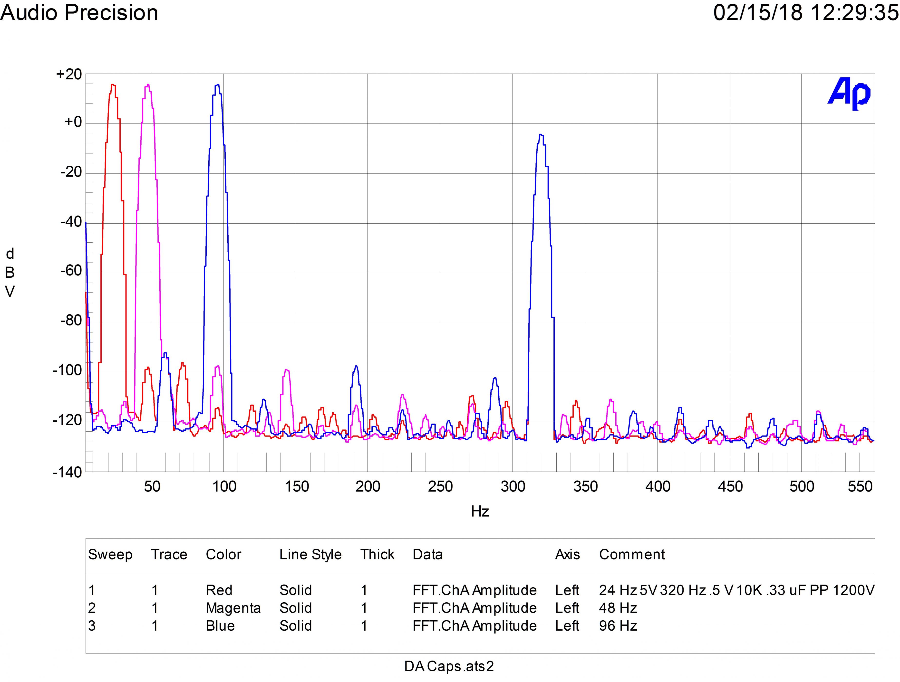

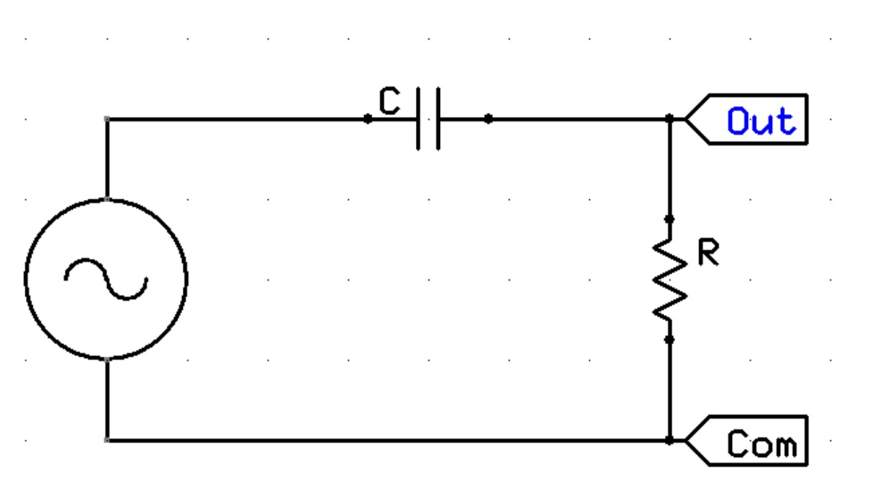

More images. Test set up. Modulation signals at 24, 48 & 96 Hz. RC 10,000 ohms,.33uF. One at a time. Difference this time equal signal levels. Note the IM is higher than the THD. This follows my expectation of modulation due to the nonlinear mixing.

Signal generator through capacitor into 10K resistor. Inject through capacitor and output across resistor.
OK yes, any time you develop a voltage across the cap, you get distortion. So, for a coupling cap, you use a very large value so the lowest freq does not develop any voltage across it. Used only as a DC blocking function.
It would be interesting if we could have a little more information:
What type of cap and voltage rating?
Test signal voltage?
What does it look like if cap replaced with a short? Perfect?
.33 uF polypropylene 1400 volt rating.
Test signal is shown 0 dB = 1 volt or 7 V RMS 20 Peak to Peak.
Just look at the noise floor on each pass that is where the dirt is, side bands are 10-20 dB above that. They also are at the levels that would be expected from the amount of exponential non-linearity for the capacitance and frequencies used. Generator harmonics wouldn't move. The 60 Hz infiltration stays the same.
Note that the IM distortion is well above the THD. It also drops very slightly at the octaves above and below the Xc = R center frequency. Capacitor deviations from perfect should show up as THD. EI curve modulation should be sidebands. Pretty much what I expected.
