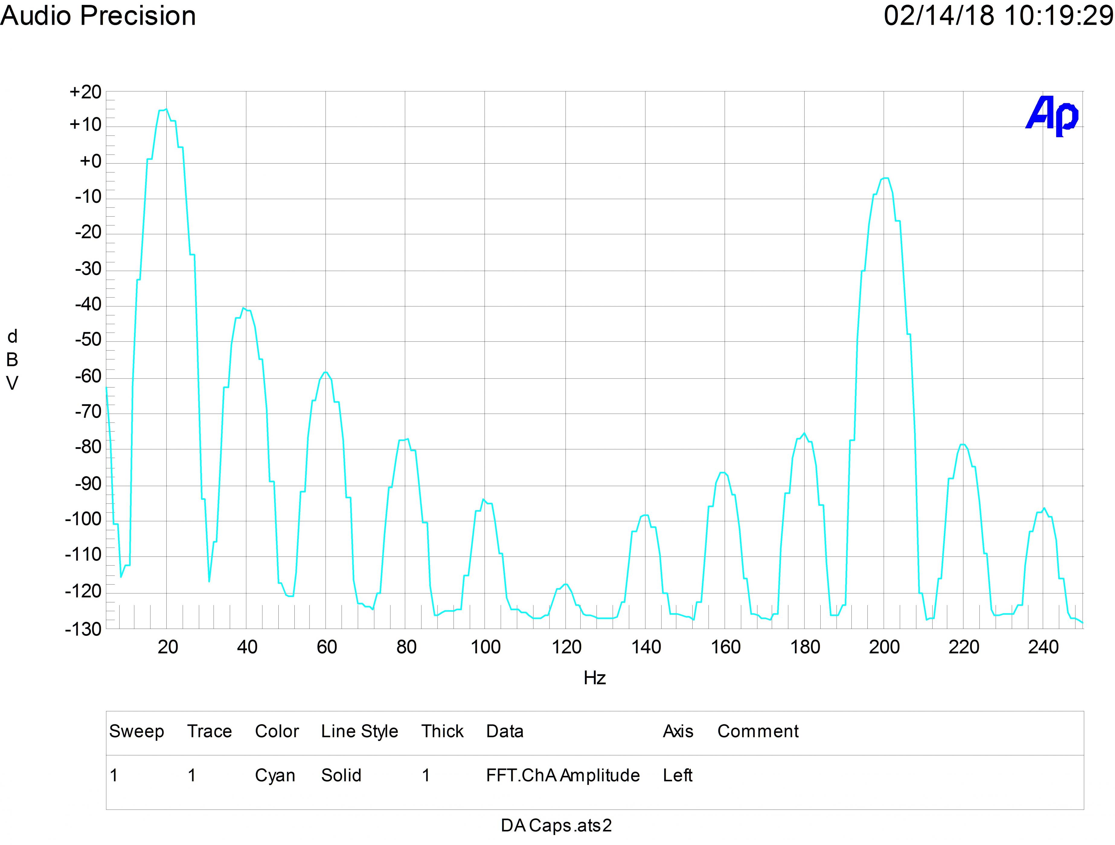

(leftmost plot in #99871)
But, it seems your AP outputs both +10 dBV signals, that would be +16 dBV for both together. At the same time you expect -125 dBV as the "no effect" level. Please, what output amplifier / ADC circuit should have that performance?
In my time at Verigy (ex Agilent) I had my "own" 93000 mixed signal wafer tester, and it also had an AP (quite a bitch to integrate, btw.) Nobody would have ever expected that dynamic range from it.
When you suggest that the capacitor is the culprit, why is there no measurement with a wire instead of the cap?
And why is the IMD3 at 60 Hz stronger than that at 290 Hz and the IMD5 falls steeper? For symmetry reasons that is not to be expected given the same nonlinearity.
Also, I miss somehow the lower sideband around the 20 Hz carrier. That should alias to abt. 40 Hz? (could be wrong, bed time overdue)
That the low frequency IMD is worse than the high freq. could mean that we see an angry AGC leveling loop, which is of course speculation.

Gerard,
Around here I have had folks disagree with the definition of capacitance which is why there is that question.
The 60 hertz spike is AC power line noise. The side bands are at 48 and 72 hertz.
But thank-you for correcting my signal level mistake. Will rerun at a lower level and do a plot without a capacitor. Did one before the set shown but that was at a lower level.
Thanks again for pointing out the obvious that I missed.

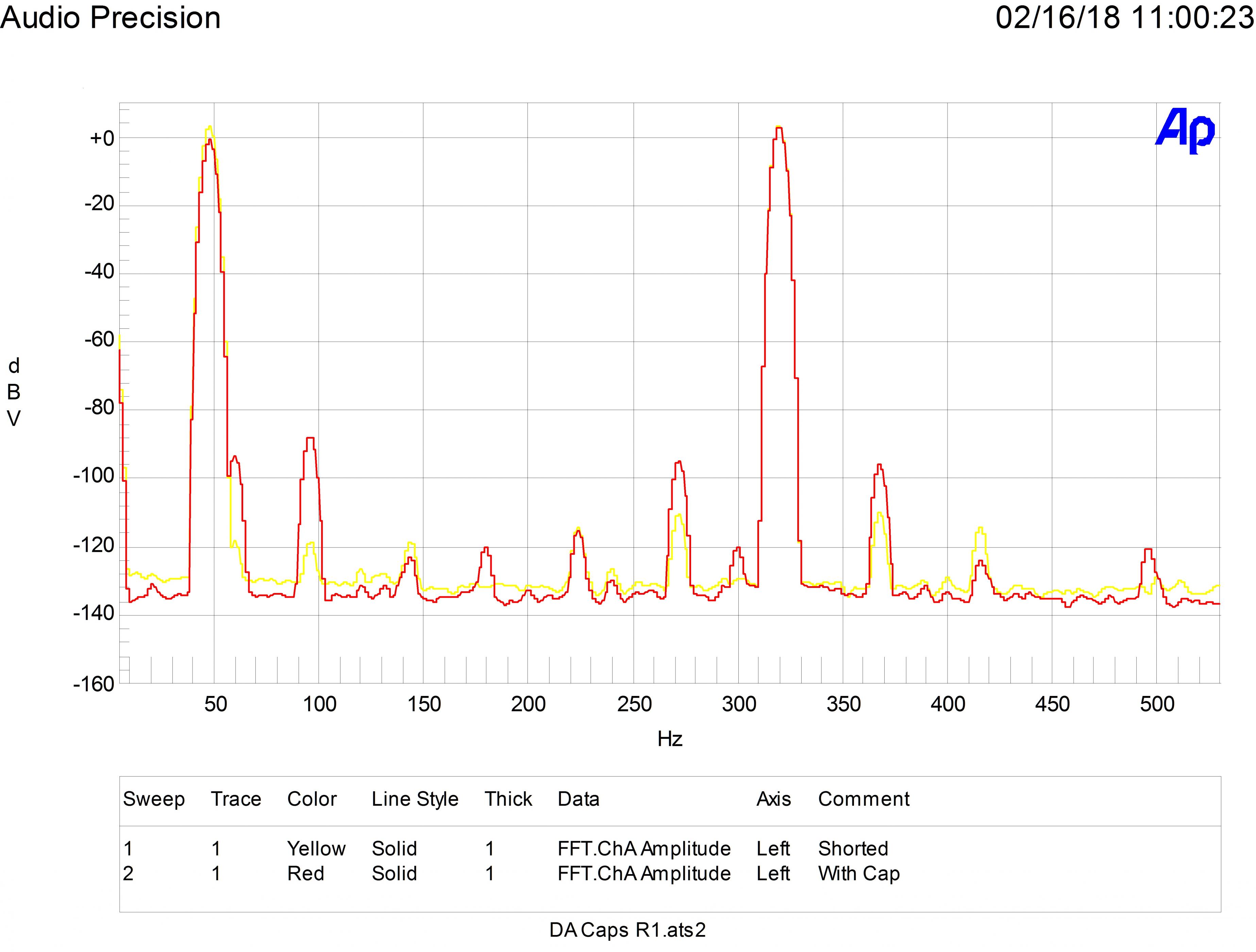

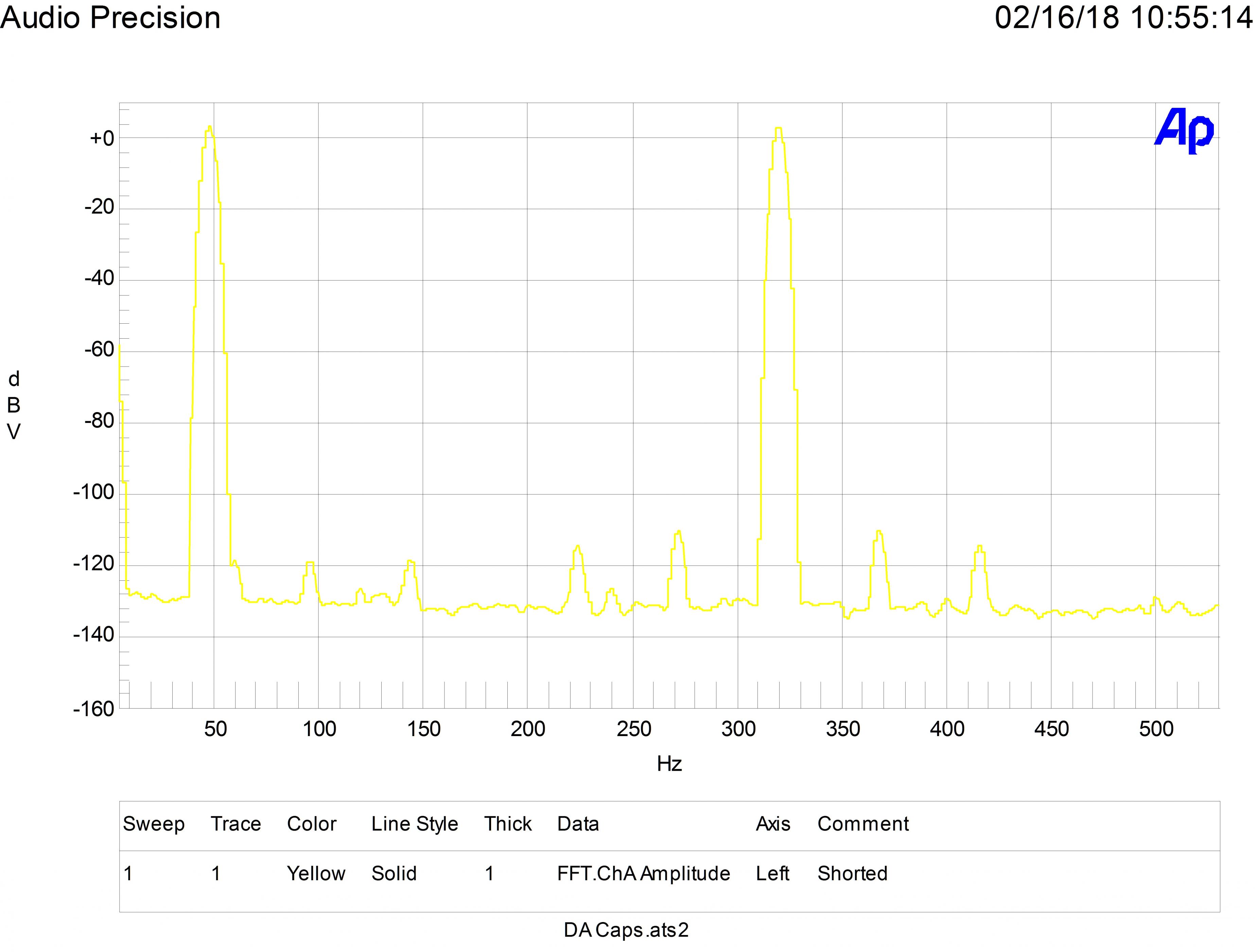

M4, Gerhard,
48 Hz with capacitor and shorted. Level dropped. 96 and 272 are interesting, 362 gets kind of lost.
More advice can be followed on Monday.
ES

M4, Gerhard,
ES
Thanks for the re-run of the plots. The 60 Hz hump sadly doesn't inspire confidence, as it's by and large the biggest change from loopback to RC circuit, which doubly suggests that the loop area of your circuit has grown considerably to pick up the 60 Hz. At 1 ppm error rates, everything under the sun starts creeping into a seemingly innocuous experiment.
The unshielded loop doubles when the capacitor is added. Exactly the opposite the 60 Hz. components show the measurements are real and consistent.

Well, Ummm, I don't have one of those AP devices. I assume it has two separate analog oscillators? If so, the question I would have is how are the oscillator outputs being combined to drive the test fixture with two frequencies at once? Maybe outputs connected together directly, maybe through an active combiner (low distortion amplifier?), or passive network combiner? Is it done internally to the AP?
Other than that, my preliminary impression is that the capacitor is quite good if ever so slightly a departure from ideal. Maybe about as ideal as it gets under the conditions as measured.
I would expect D/A and one amplifier. The inherent distortion didn't seem to change with level.
As to the capacitor I expect it is one of the best. Of course I haven't tried Teflon....
If can find it, the parts can be soldered into a full metal enclosure with BNC connectors.
Enclosure would be good. For the record, I don't doubt you are measuring what you're measuring. I'm just quite incredulous you're measuring nonlinearities in capacitors, versus carefully measuring something different. 🙂 So having a 20+ dB spike in 60 Hz show up and 10 dB change in IM products, all sitting extremely close to the floor sensitivity of the system, gives me pause.

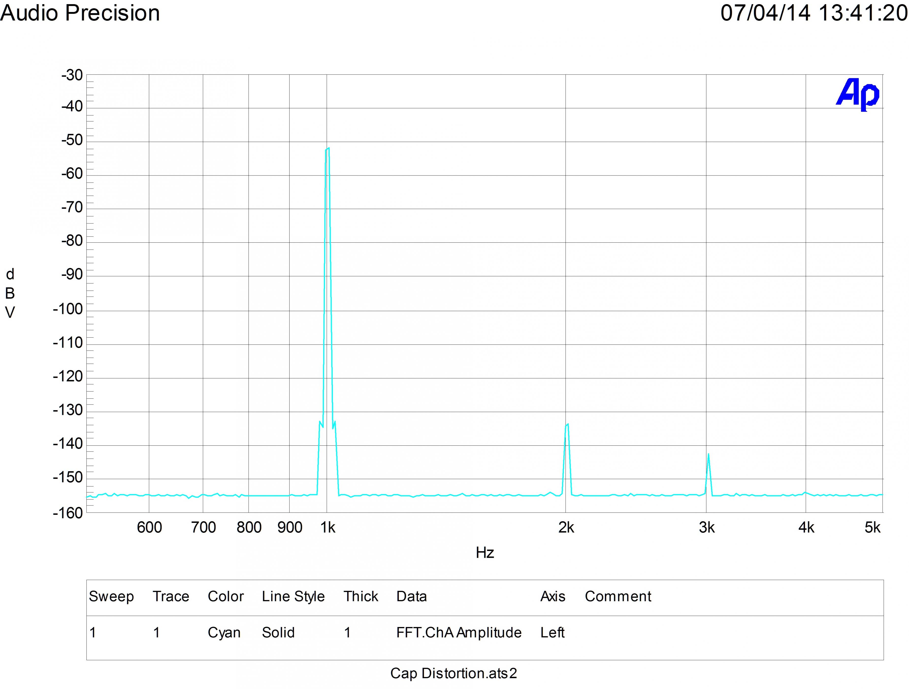

If you want to measure capacitor distortion the 4/1 and 1/4 bridge technique shows it easily.
First image is a bad capacitor in the current setup. The second is a mylar in the bridge set up. Note the fundamental is nulled a bit from the 0 level.
Hmmm. I seem to be saying that a lot recently. 🙂
It sounds like signal generation is entirely internal to the AP, with only one output connector going to the test fixture?
I'm wondering why there is as much IMD as there is with a short in place of the capacitor (but, the line frequency noise is understandable), Either the IMD is internal to the instrument, or to the remaining parts of the test fixture. Nothing else left, is there?
A few questions occur to me along the lines of these:
Is it known what's the normal residual distortion for two tone IMD measurement for the AP model you have? Can you plug the oscillator output right back into the analyzer input and bypass the test fixture? Is there an internal loopback mode to check for normal operation?
When I get a chance I can jump out to in. There are two outputs but on the dual setting they both are the same. Gerhard was right about it being the AP, but output level doesn't seem to have much effect. I expect -130 resolution doing an FFT and at least -120 on a sine output. Have to check to see what it is doing these days.
