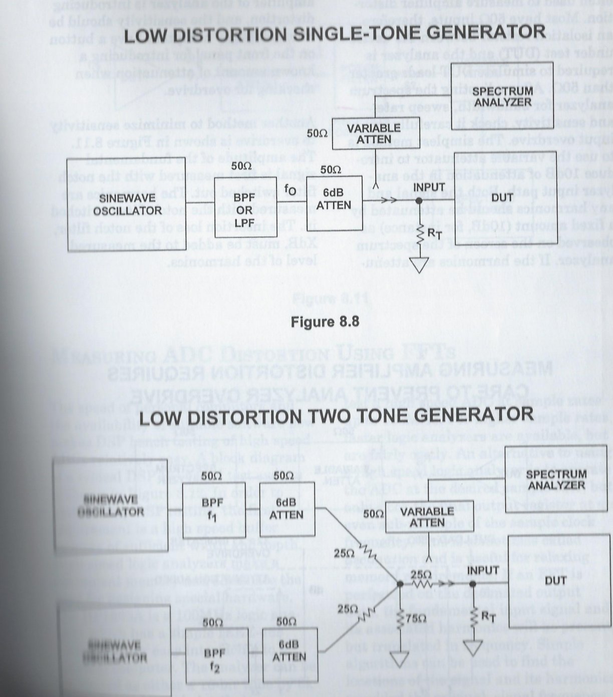

Well, Ummm, I don't have one of those AP devices. I assume it has two separate analog oscillators? If so, the question I would have is how are the oscillator outputs being combined to drive the test fixture with two frequencies at once? Maybe outputs connected together directly, maybe through an active combiner (low distortion amplifier?), or passive network combiner? Is it done internally to the AP?

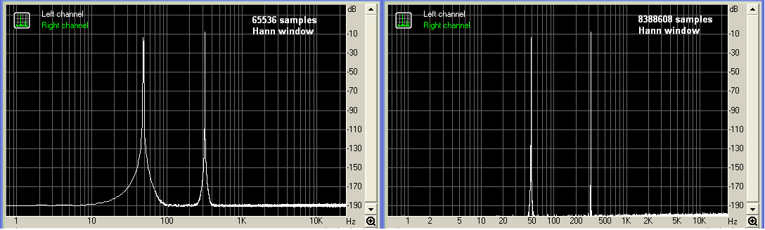

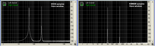

Generating a dual test tone in software gives good results.
Here is a two minutes long file 24bit/48kHz with two 1:1 sinusoids –6dBFS one at 48.340Hz, the other at 320.068Hz
Dropbox - DualTone48.340Hz-320.068Hz 1 to 1 at -6dB_24b-48kHz mono.wav
