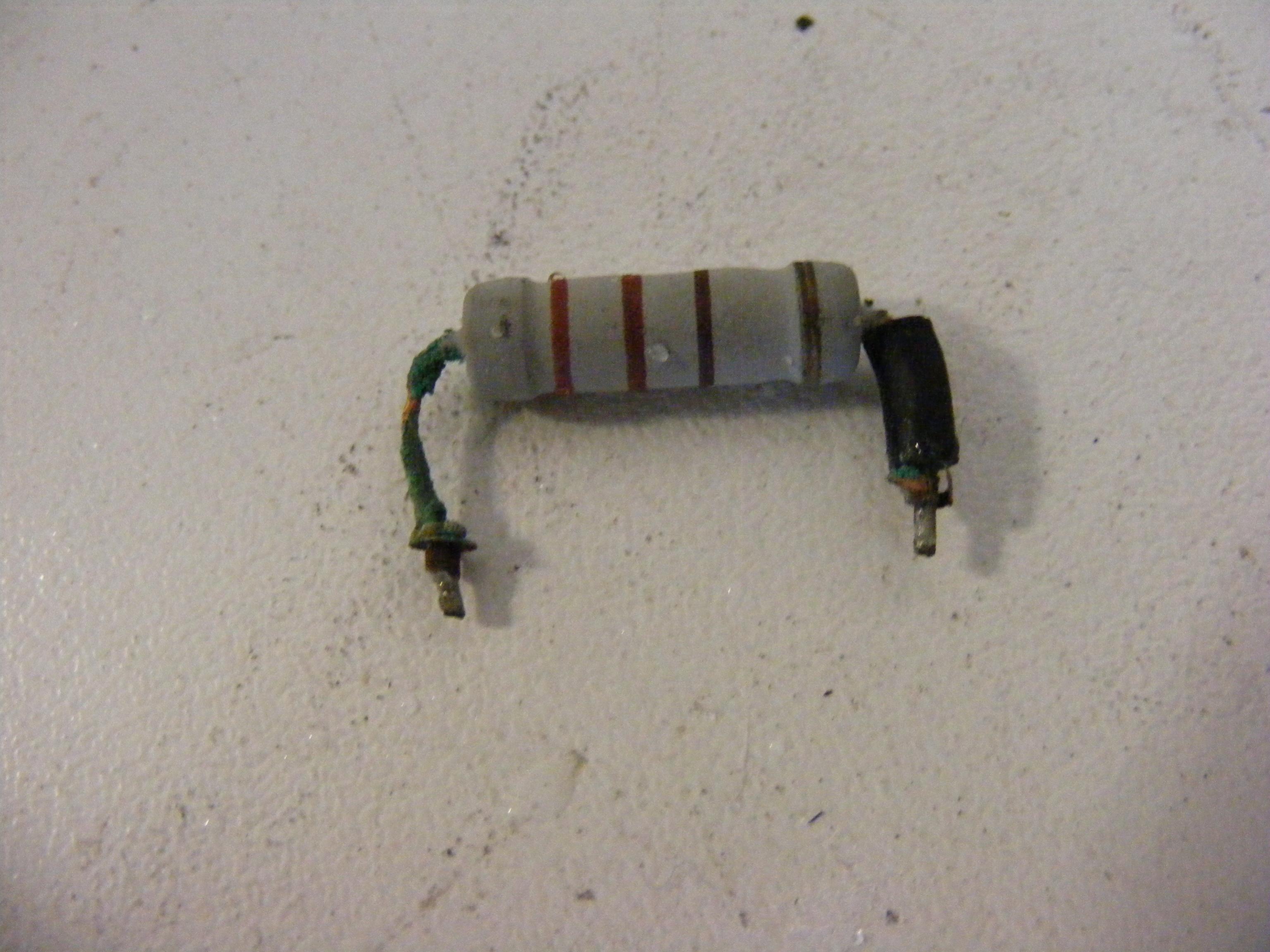

Never saw this before. A resistor used in a power supply feeding a zener diode. Spaghetti on the leads to make sure it couldn't short to its' neighbors. Four of them. 330 ohm 3 watts. After they baked in I could not unsolder them! One had dissolved the solder joint and only started to conduct after things warmed up a bit. Good thing this is all that was wrong, the replacement card from the manufacturer is $1,100.00. Yes I did have to add jumpers to replace the destroyed PC traces.
Yes a bit of browning on the card, but the unit has been in service since 2001.

That's pretty common with some manufacturers. Some look like that after a couple (as in two) years! In some cases they may be trying to get into the lower zener dynamic resistance and cook everything needlessly. What does the zener diode look like?
Sometimes that circuit can be redesigned to use a reasonable current source and a darlington pass transistor arrangement. Not horribly complicated, but if you can save a few watts of dissipation, why wouldn't you?

Chris I just used a higher wattage part. Every other part is still fine. I figure if they last another 16 years that the system will be retired before then.

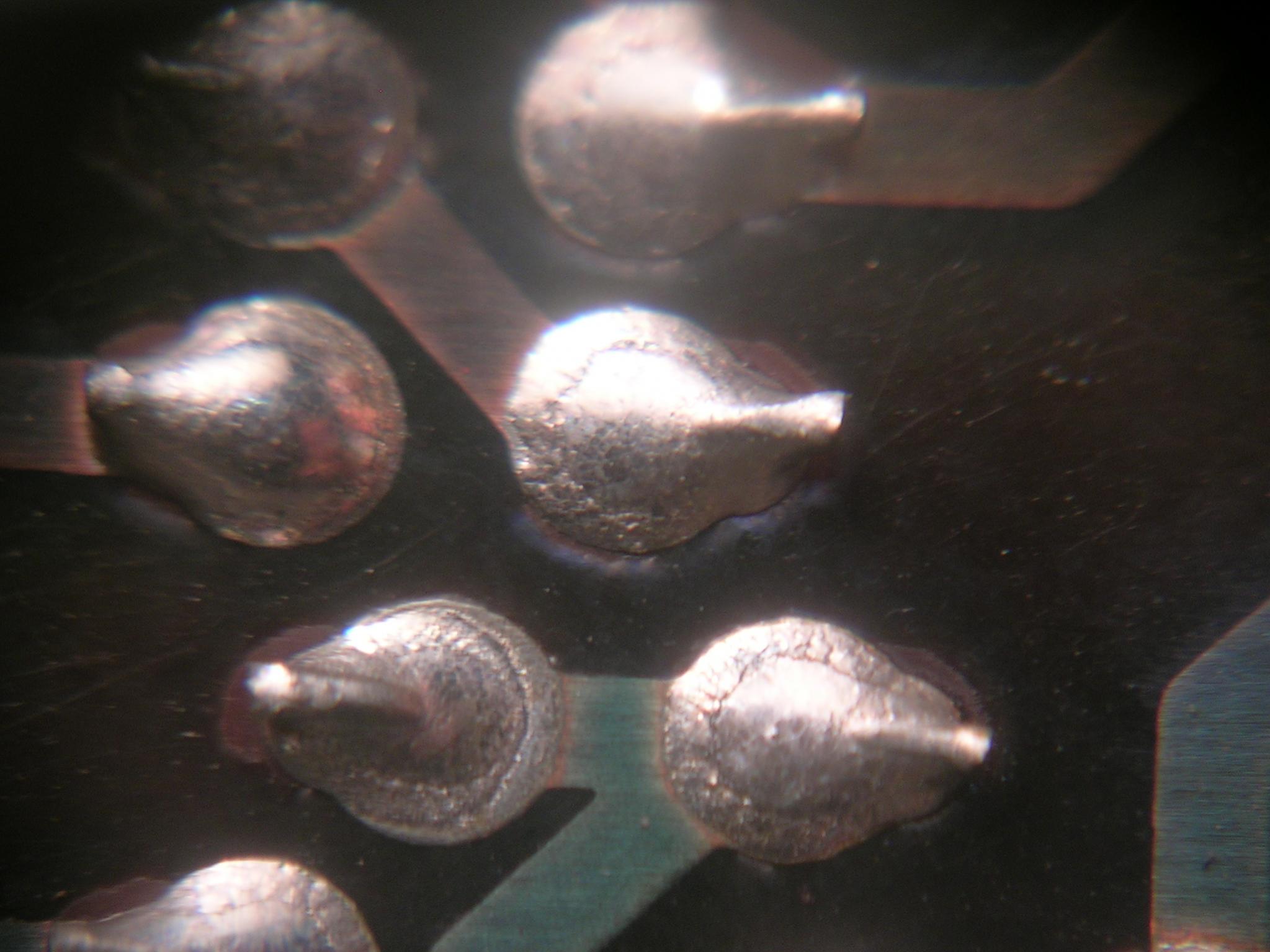

The change to the solder and the leads disintegrating even though the resistor stayed on value are what I found really concerning.

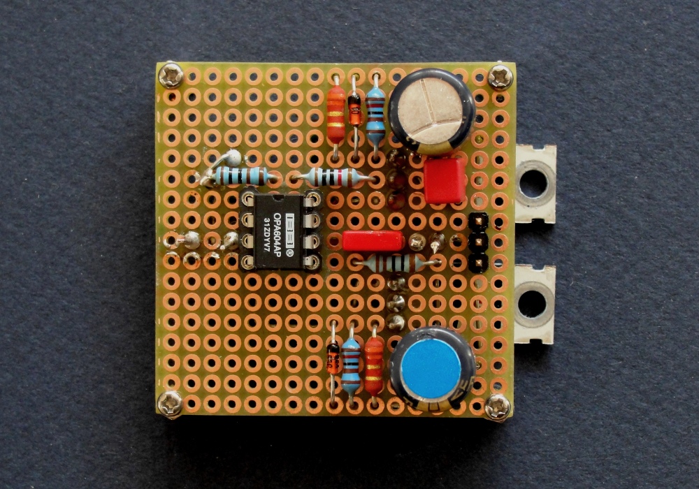

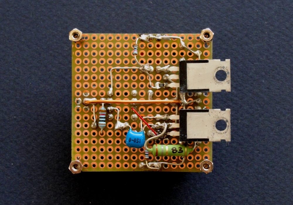

Done in less than a day including taming oscillations.
I do not have LT1792 (as used in the Spice because the model is accurate), so used OPA604.
It has somewhat higher idle current (5.2mA), so the FET bias resistors have to be changed to 1.1k.
And even with bandwidth limiting to 100kHz in the feedback network, it still needs a Zobel to be stable.
Pretty aggressive at 1.8R-1µ.
Else pretty much as simulated.
Patrick
It's not uncommon. It's low cycle fatigue on the solder. It was very common back in the telco days.
The issue was up on the poles and the temp swing day to night.
Solder shrinks about 15% when it solidifies, so large fillets are essentially born with tensile stress. Repeated warm/cold cycles caused creep of the solder.
This was a typical failure mode on pc boards used on furnace control cards, the large relay socket pins soldered to the board would crack the solder right where it attaches to the pin.
If one is lucky, it is found and fixed before the traces burn up, otherwise you have to solder bare copper wire on the traces to repair.
Edit: as I recall, IBM or Bell labs actually make a soldering wave line using bismuth to zero out the phase change volume loss. Also, iirc, I mentioned this previously in this thread, maybe 5 years ago..

Those later pictures of solder failure, or "reflow" are pretty typical in consumer equipment. One would hope that the pro-audio gear was designed a bit better, but some was at least as bad as consumer stuff.
Once the solder had reflowed badly, the component lead would be so oxidised that you had to remove and resurface it or even replace the part if you ever expected the new solder to wet. For sure you were removing the old solder best you could and applying new, sometimes with extra flux.

There are a couple of mechanisms on solder that leads to failure. Jneutron is right, there is fatigue from thermal expansion mainly from the board. PCB's are laminates with an-isotropic thermal expansion with the highest value being thru its thickness, which is were a lot of failures are. The fatigue life of solder being deflected at the maximum, within hooke's law or its spring constant is about 10^3 cycles.Once solidified, the solder and PCB/component continue to cool pre-stressing the solder at up to it's yield because if its malleability.
Next is the temperature cycle during bonding. the most forgiving is SnPb. But the lead free most being eutectics have to be controlled carefully as there is alloying and desired result requires a phase change The wrong phase, the failure thru whiskers etc. Also, without a forming gas, oxidation can be present.
